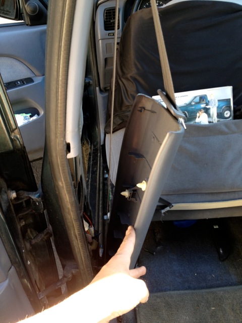

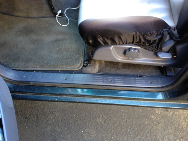

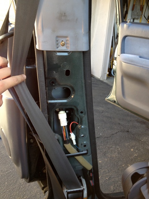

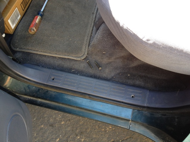

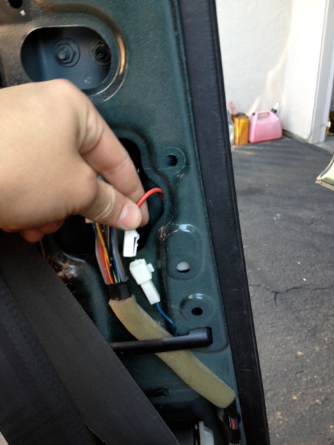

THIS IS A TERRIBLE IDEA AND IS NOT RECOMMENDED, but if you really want to do it, here you go.

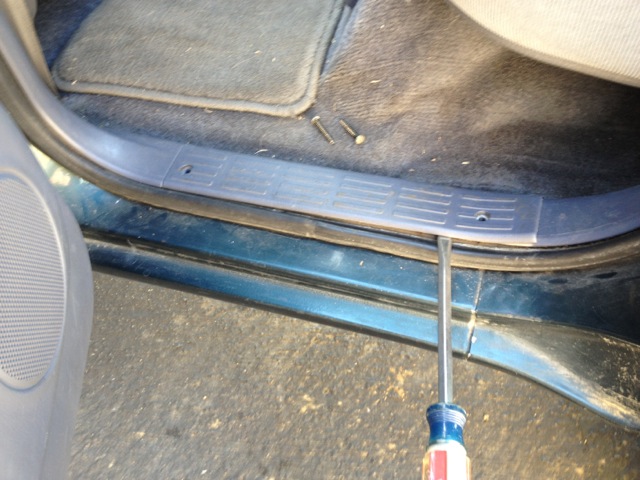

1) Remove screws front and rear from door sills.
2) Pry off the door sills with a screw driver.

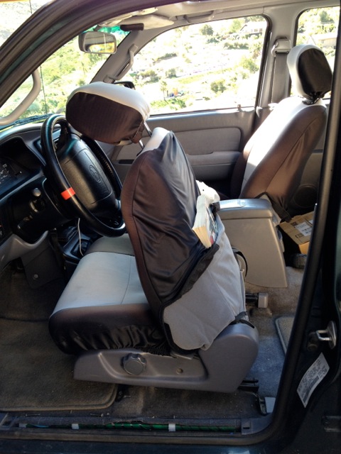

3) Move driver seat forward

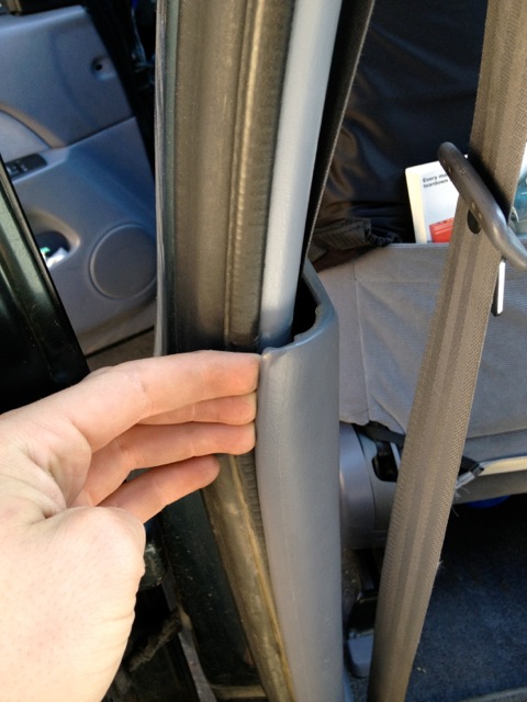

4) Pry off Pillar plastic with your hands.
5) Detach the small red wire and your done.

I'd rather remove the buzzer IMO. The dome light won't turn on without the door sensors. Doing this would also render door-triggered alarms unusable.
I wouldn't recommend it, but if it doesn't bother you, enjoy...
WARNING! I did this in my Toyota Celica when I had it and when I start my car and then close the door and stood out side of it to talk to a friend, the car automatically locked all the doors after about 2 or 3 minutes of it just running. It wouldn't do this if the car 'Knew' the door was open. Not sure if 4runners will do that, but I'll tell you it sucks to be standing in a parking lot with your car running, locked, while you wait for some one to drive you a spare key.:)
