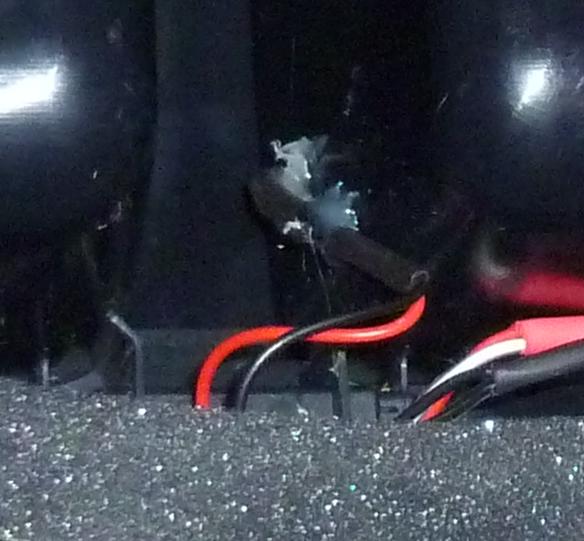

The first pic is the map pocket LED for the passenger door. I drilled the hole with a Dremel from the back side of the panel and mounted it with hot-melt glue so that the LED’s tip can just barely be felt in the pocket. This is also how I did the back doors

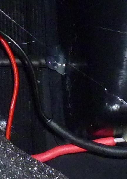

The second pic is the bottle pocket LED. I drilled from the cabin side using a Dremel with a right-angle adapter. Then I hot glued it as well so I could just barely feel the tip of the LED in the pocket.
I then wired them together and ran the wire up to the existing door handle LED. I used more hot glue to keep the wire in place.

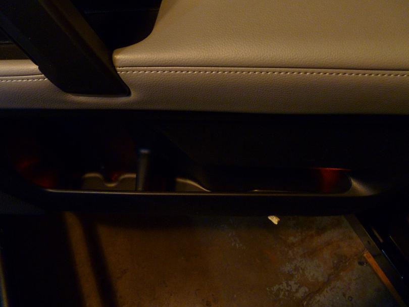

The last pic is the results after re-install the door panel; there is too much ambient light to really see the results.
