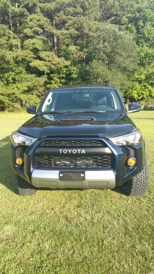

Pulled the trigger and got my 4runner. Let the mods begin! Have grille and installing that soon, Nfab Steps I got from Antman (Thanks man!) will be installed this week.

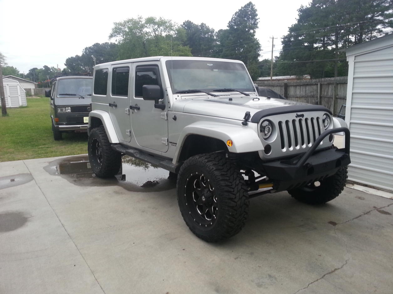

Is the Trailblazer next to you in the PIC your trade in, just wondering, thats what I traded for my Nautical Blue Trail.
No lol. MY trade in was a 2012 Jeep wrangler JKU.

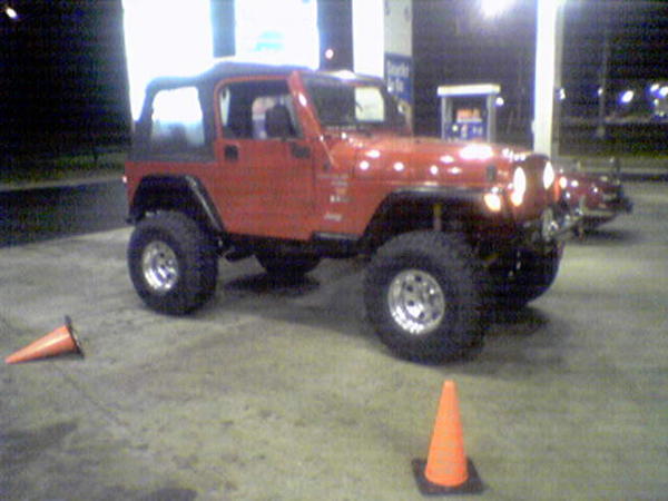

The Tj was my 99 jeep back in the day.
