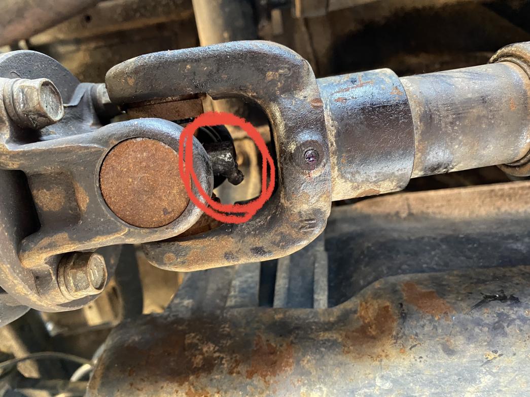

So I have a hose, it’s that the coupler won’t fit in where the zerk is due to the u-joint. I’ll attach a photo for reference

I tried doing that yesterday and it wouldn’t rotate for me. I had a solid connection with the wrench on it but it would just slide off. I don’t want to risk rounding it off, either. The issue seems to be that the zerk head is facing inward, like towards the slip joint itself, not away from it. If it would just rotate I would be perfect! It’s so frustrating because of how much room there is, if only it would rotate I could attach the coupler to the zerk and get it filled with grease. Does anyone else have any suggestions? I appreciate all the feedback so far, guys

Upon further inspection of the zerk itself, it looks like it’s really well seated in there, so idk if it has the capabilities of turning or not. Would PB blaster maybe help? Maybe using line wrenches? This seems to be what it is that I’m working with (see photos)

For this particular zerk, it’s not the position of the driveshaft so much as it is the position of the zerk head itself. I wish it were facing out towards the open area so I could just slide my coupler right into the zerk head

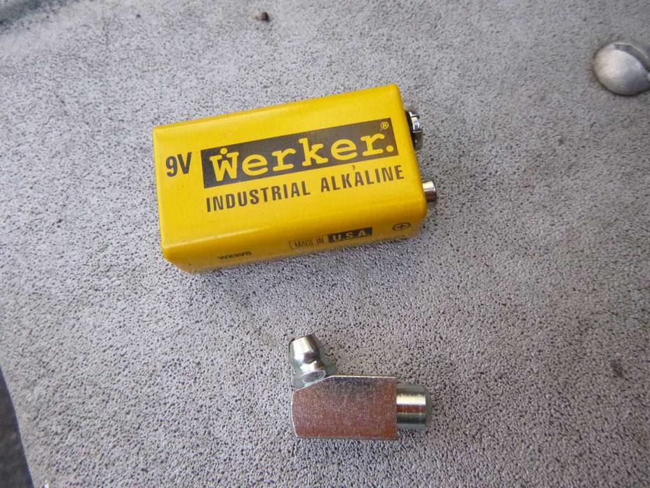

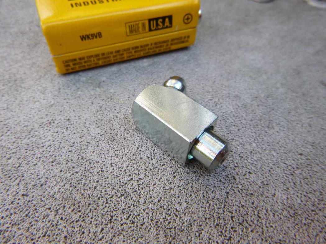

Another alternative is to see if you can unthread the little zerk end out of the body that is threaded unto the u-joint. Usually the zerk is also an M6-1.0. If you can get it out try threading in a 90* zerk like this in its place:
iu
It's possible the extra weight could cause a vibe (though I doubt it) so you could put the old zerk back after greasing.

No success. I was able to remove the zerk from the u-joint itself and figured out that if I install a 90 degree zerk then I can get my grease gun on there and get it filled. Problem is, I can’t find the right 90 degree zerk with the right diameter and thread pitch anywhere locally. Anyone have places they recommend?
