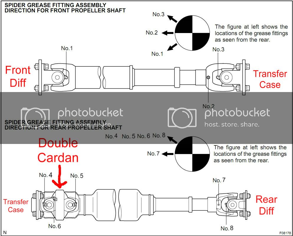

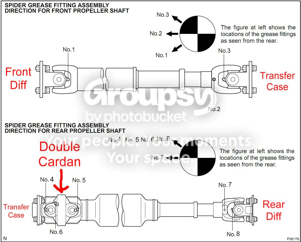

Ok, there have been so many threads about drive shaft greasing, thought it'd be a good idea to make a reference thread...
Here is the FSM picture. I have changed the numbering to match the TSB for consistency.
DriveShaftzerks.jpg~original
Sorry if the notations don't show up on the pic, I edited it in photobucket and they don't seem to show up right sometimes...
4Runners.org has some great pictures of the zirk locations, but glosses right over the grease issue.
4Runners.org - Lubing Your Driveshaft
The FSM on page PR10 says to apply molybdenum disulfide lithium based chassis grease to the slip yokes only (zirk's 2 and 7). The spider bearing replacement page says to pack the spider bearings with MP Grease (Multi-purpose grease, usually lithium based, zirks 1, 3 and 8).
And on page MA-9, it specifies Moly grease for the Double Cardan joints (thanks for the find here MTwEeZi!)
XWGqaxZ.jpg~original
So in summary:

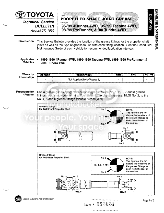

Then there is a TSB from 1999 that says differently
DriveShaftGrease.png~original
1. MP
2. MP
3. MP
4. Moly
5. Moly
6. Moly
7. MP
8. MP
I notice that the manual and the TSB reverse the direction of the zerk on the center carrier of the double cardan. Mine is like the TSB, facing the rear.

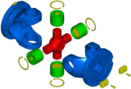

Here's a nice picture of the internals of our U-joints.
And here are some pics from fishcharmer of his destroyed u-joint. They show how the grease flows through the joint.
So in summary:
1. MP
2. MP
3. MP
4. Moly
5. Moly
6. Moly
7. MP
8. MP

Can anyone confirm the quantity of the grease?
From what i've gathered,
#2 and #7 - 2-3 pumps at most
#1, #3 and #8 are where you want to pump until you see new grease seep thru.
how about at #4, #5 and #6?
Thanks
Did you figure out how much #6 takes? On #4 & #5 I just pumped till I seen grease coming out around the joints, but number #6 I pumped about 6 times and didn't see or felt any resistance on the grease gun. No signs of grease around the coupler and stopped because I didn't want to put to much grease in if thats a thing for this joint.
#2 and #7 I only did 3 pumps, but I sure would like to know for next time how much grease is in there so i don't over do it next time.
Anyone else please chime in if you have any answers. Thanks.
Can someone for the love of all things good please tell me how to grease #8? I cannot fit my standard coupler in there and bend it in order for it to attach to the zerk. I tried using an open ended wrench to turn it, but that didn’t work. I purchased a 90 degree coupler attachment but it won’t arrive until tomorrow. Send help!
