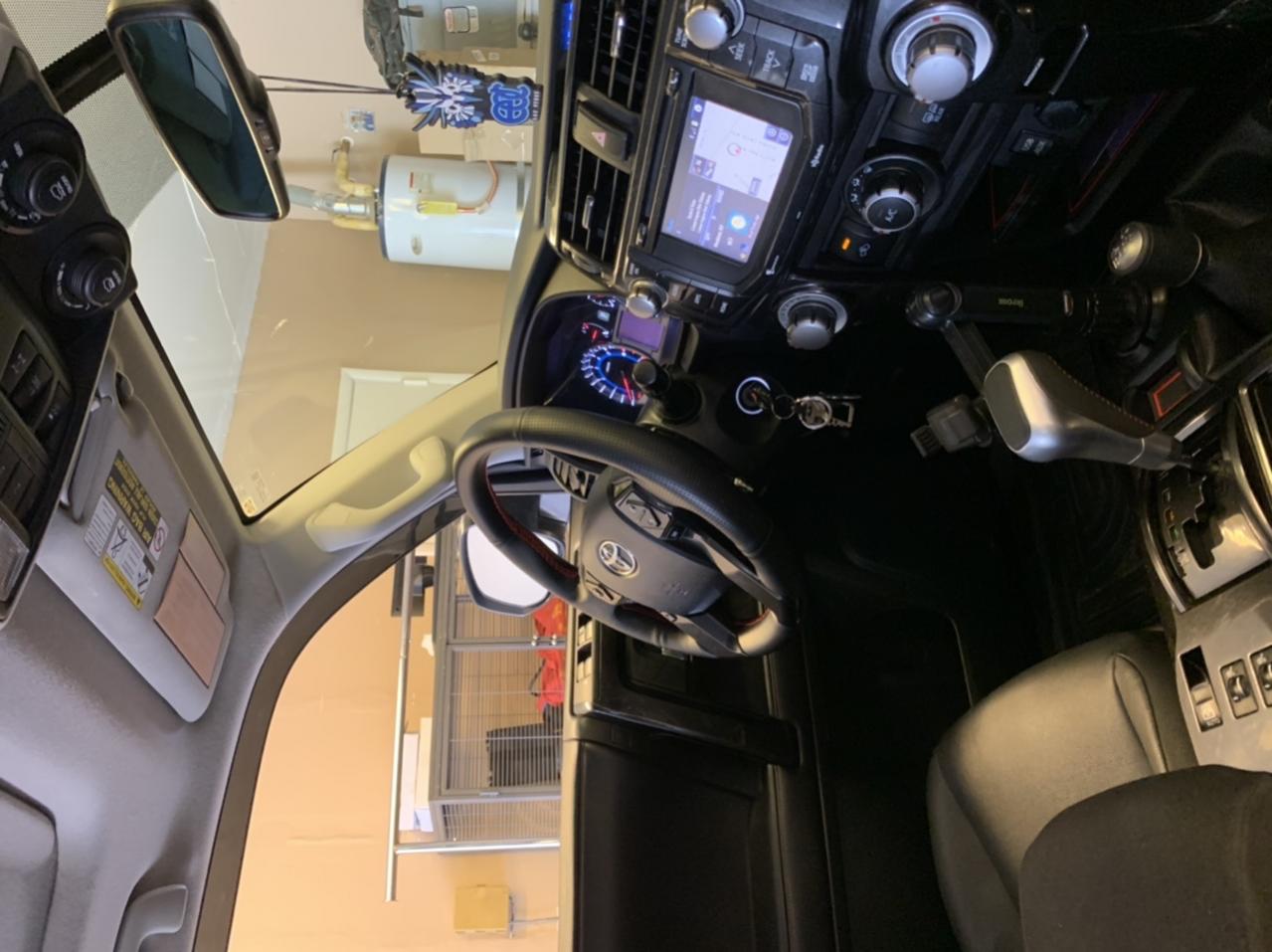

Just finished the install today. Took a little over an hour and a half including time to run to autozone to get an adapter for my drill.
Thanks [MENTION=154554]Jasontamu[/MENTION] :thumb:
Pic keeps comin up sideways for some reason

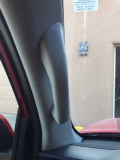

Finally got mine installed and photos taken/ uploaded. Great product. Thanks [MENTION=154554]Jasontamu[/MENTION] Still having issues uploading photos!:shrug:
