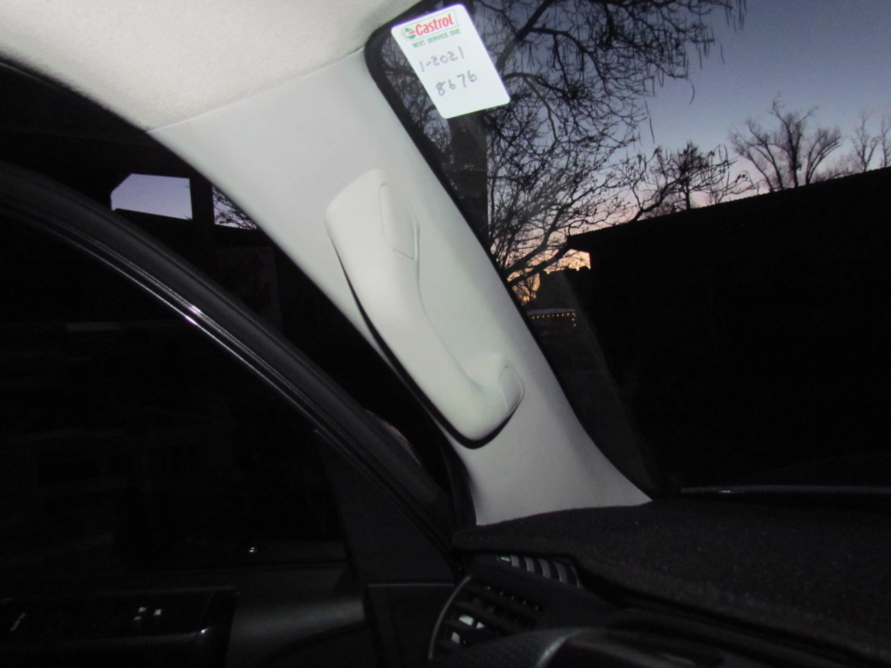

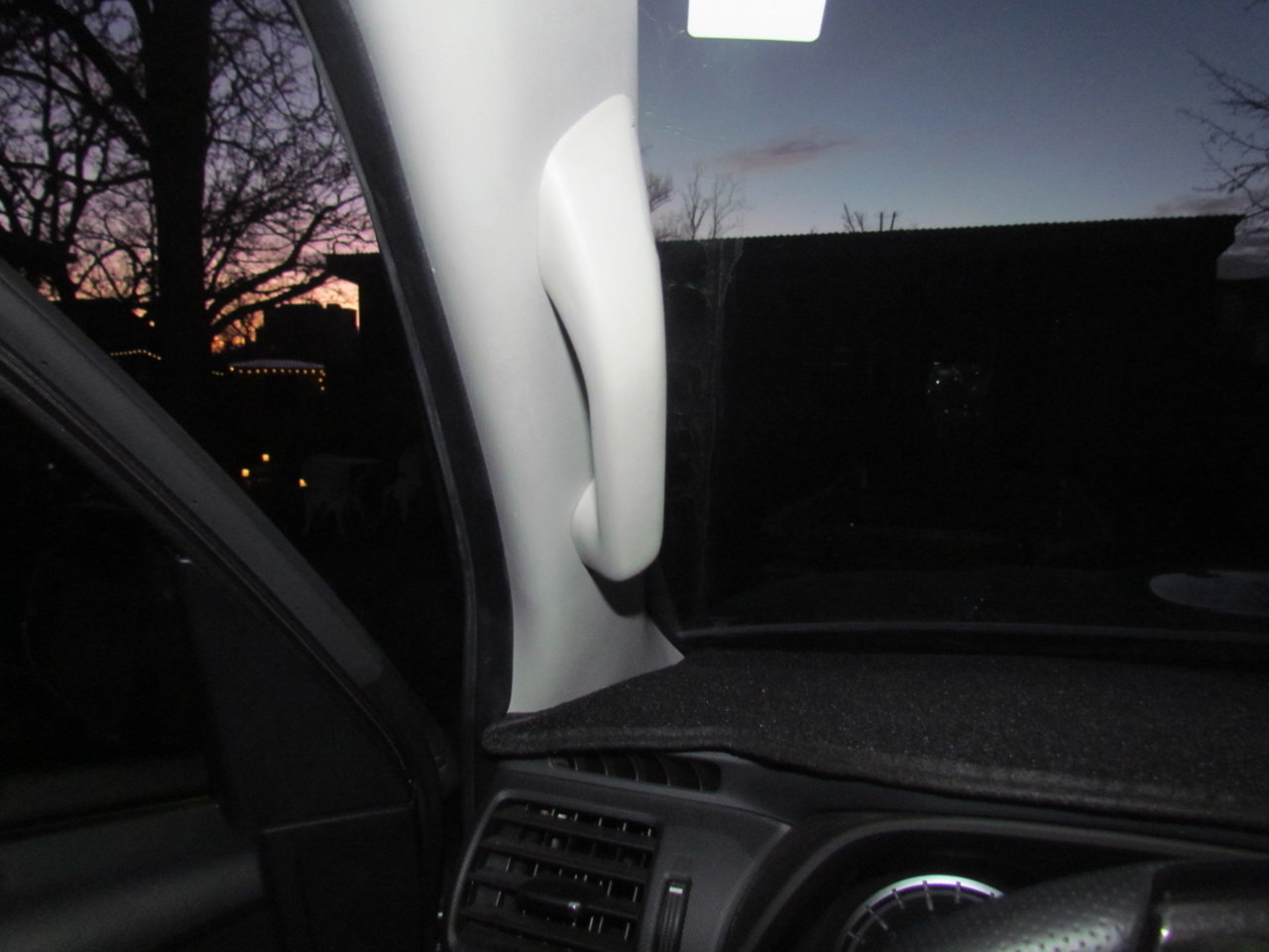

Finally finished up yesterday, thank you to everyone who joined in with their tips and help. I did not end up needing to trim the top of the handle at all, it fit fine without any trimming on the mounting surface:

Hello [MENTION=604721]smeerun[/MENTION]. New guy here, I've been following this thread and yours on the subject for some time. I have everything on order to complete this mod, the parts are due to deliver today. One question - do you need to remove all the raised portions of the bottom mounting surface of the grab handle with a dremel, so it's flat, with no raised surfaces? Thanks!
yes correct. the bottom of the handle has square shapped sections that protrude that require to be cut off with a sharp razor box cutter type knife or dremel them off.. they are like tabs that need to come off...
the round area where the bolt goes stays but the square section needs to be cut flat.

Thanks for the response. After getting the bracket mounted and the trim piece back on, it became apparent what needed to be cut. I ended up cutting the round raised portion of the bottom mount flat also in order for the handle to be flush. Nothing off the top mount as far as the round raised portion, just the square notch thingie.
Yep! Thats what I was trying to say, once you get it mounted up it will be clear what you'll need to shave down to make it flush. :)

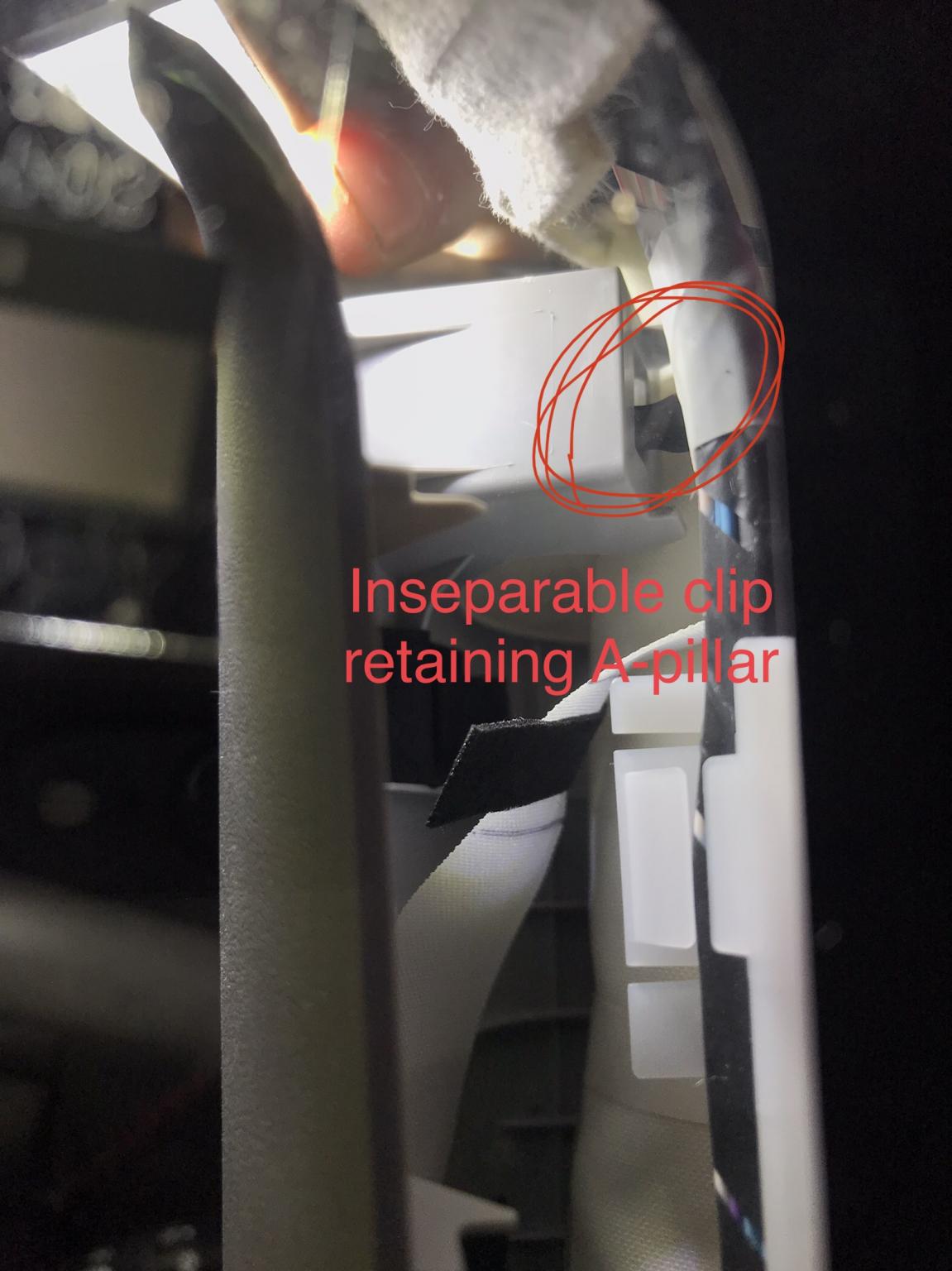

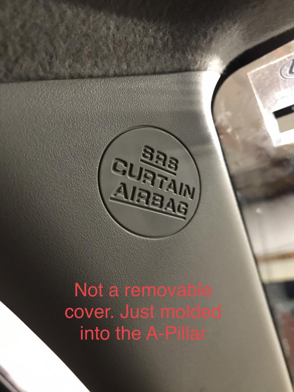

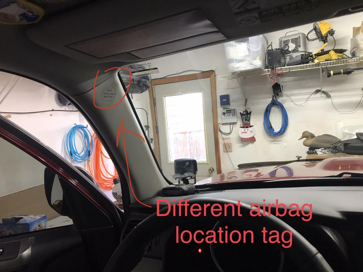

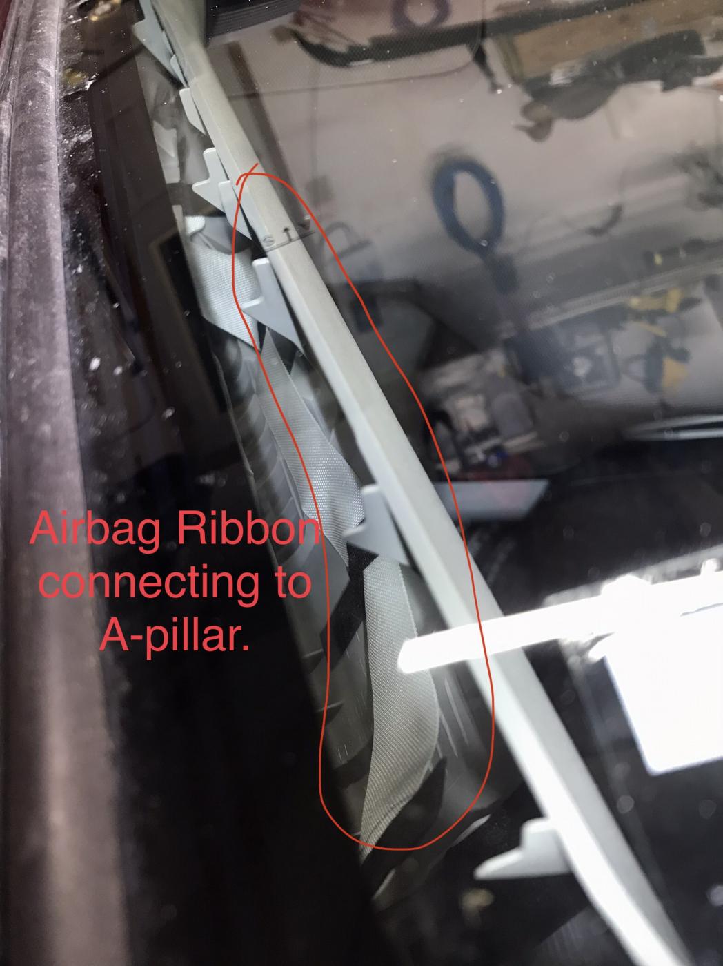

Well I'm sad to write that this kit doesn't work with ALL 5th gens. I was so excited to install this in the truck to surprise the wife but unfortunately I cant. My 4Runner is a 2011 Trail Edition and appears to have a different A-Pillar and air bag design. As you can see in the photos the "SRS CURTAIN AIRBAG" logo is in a different location, and not actually a bolt cover. The A-pillar is also not supposed to be removed by just anyone. There is a one way clip at the top that the will only release if you break it. It looks like the A-pillar is connected to the airbag with a ribbon and I'm guessing Toyota was protecting people from removing the cover and messing up the airbag.
Good news is its easy to tell by looking if you are one of the few like me that this won't work for by looking at the airbag warning logo. I'm also happy to say this kit wont go to waste, a friend is going to use it on their rig.

Jason, do you have bracket and install instruction for pre facelift 5th gen (2010-2013)? On my 2013 SRC cover doesn't exist whole A-pilllar cover is one piece. Also removal of it is not simple pop it off and looks like some cord holding it and must be cut. Without clear instructions I'm hesitant to cut anything near curtain air bag.
Yes, it can be done, it takes two brackets and have had people do it successfully just need to line up brackets with out the plastic apillar in place then install the apillar and drill holes into it.
you can just remove that cover, the cord can be removed. the airbag is installed AFT of where the handle goes and airbag is not affected at all.

So did you contact Jason and inquire about your model ?
It looks like someone asked about earlier year models and was told it would work, but not with the bracket you describe!
Reach out to Jason and see what you really needed.
hi yes, it works on 2011 i have done it before. please email me and we can figure it out as this thread is 2014+ and there is a way to get it going for older models. 2010-2013's.
