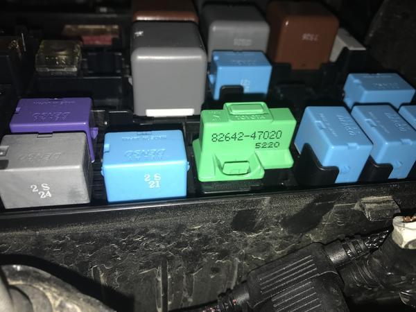

Just a small item to mention, the relay in my fuse box is green not grey. Same shape and location. Maybe the 2015's are green plastic? Or maybe it's a Canadian thing.
Is the part # the same as pictured in the first page photos?
Here is what mine looks like (Canadian 2015 SR5)

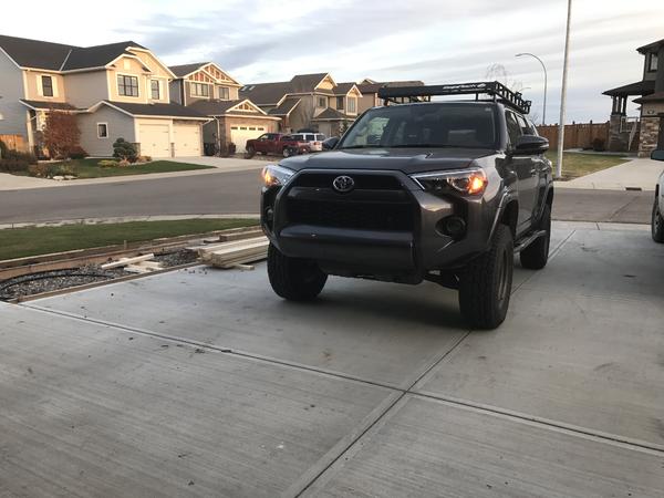

Marker lights

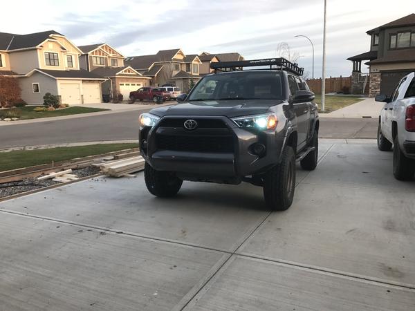

HID low beams

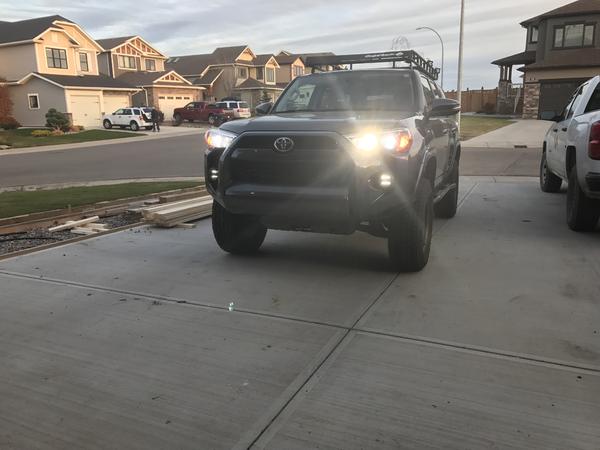

HID low beams w/ LED fog lights

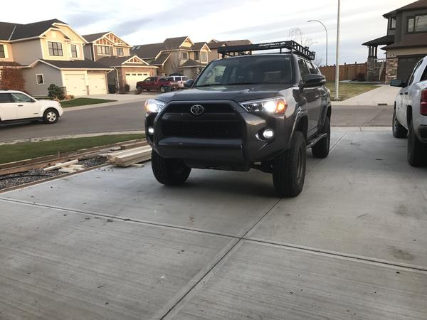

HID low beams w LED fog lights and LED high beams
Now what I'd really like is to actually convert my fog lights back to work as DRL's, which they did before the mod. From the pic above you can see they are in "DRL mode" when the high beams are on. Mostly because my wife has never owned a vehicle without auto headlights and forgets to turn the headlights on in the city when it's evening time.
[MENTION=132832]Bridgetown[/MENTION],
Ok, I see they are different part #'s as well.

I'm thinking that my relay has a different part number because my SR5 does not have auto headlights?

Well, I got this part figured out and I thought I'd post my solution here if anyone wants to do the same, after doing the DRL headlight disable mod. Useful, if your changing to non-dimmable LED high beams, and still want your DRL compatible fog lights to operate in DRL mode. Another nice feature with this solution, is the DRL fogs retain the original time delay off function when the vehicle is turned off.
My fog lights have two wires (I assume all DRL compatable fog lights would), one that plugs into the factory fog light harness for normal operation, and one wire that was tapped into the high beam bulb connector green/black wire. I removed this wire from the headlight connector. Then I located a power source that had the same voltage that is controlled by the key on/off. There is a power distribution block just behind the fuse panel box.
The red/black wire, 2nd from the left, is the one you want to tap into. This wire is controlled by the key, and when you turn off the vehicle the wire holds power for about 60 seconds and then turns off.
DRL fogs and marker lights on. (My cell phone camera makes fogs look brighter then they are.)
