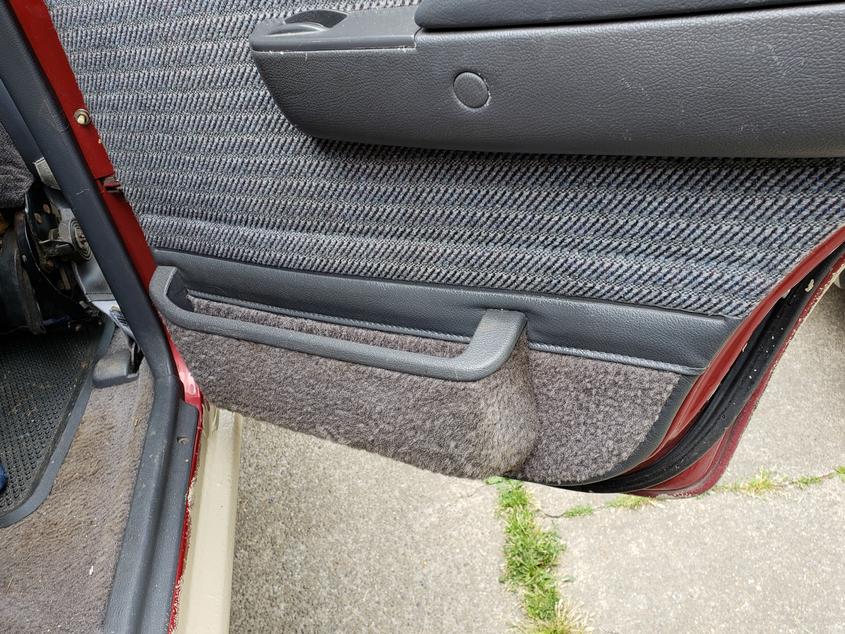

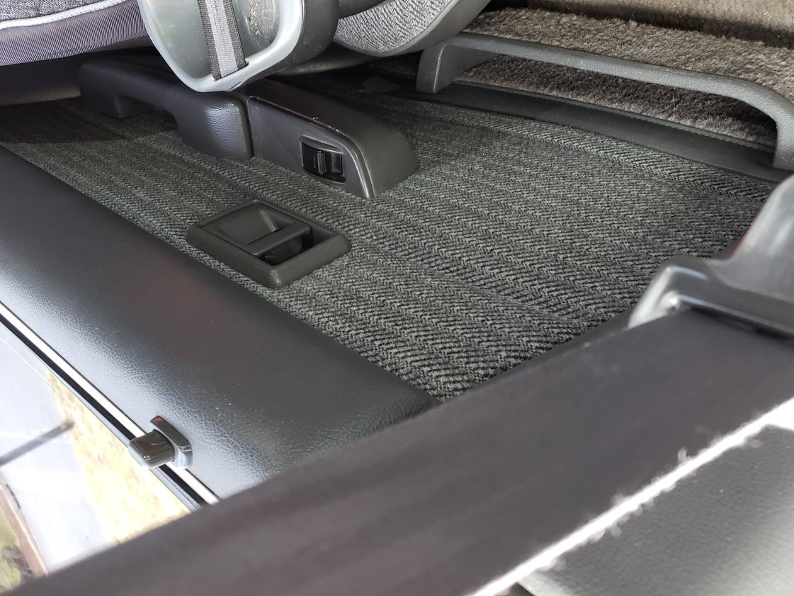

Today's Friday 4Runner Fifteen minute project brings a set of rear door storage pockets because you can never have enough places to stash a bag of zip ties.
plus I found them stuff on a shelf in the garage.* I believe I pulled these out of a 1st gen 4runner.
Sort of braincramped checking to see if they would fit. No issues with seat folded up or laying down

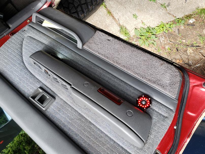

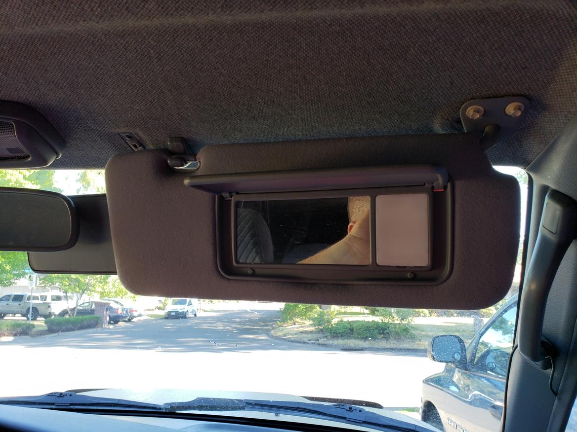

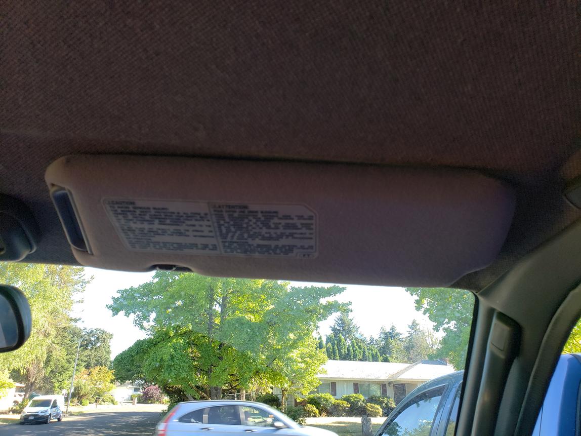

[MENTION=5345]habanero[/MENTION] scored a set of 01-02 Limited Illuminated extendable sunvisors for her 3rd gen and that got me looking.
3rd gen visors will mount directly into a 2nd gen. I was running a set in my 94
having the illuminated mirror and extendable visors would be nice, especially for the missus.
looked on Ebay for the limited visor...sticker shock..if you can find them they want about half of what I originally paid for the 4runner.
so decided to try an alternative: I scored a set of Lexus ES300 visors that were dirty but in great shape and dirt cheap.
not a direct bolt in but I got the features I was looking for. I'll get the light for the mirror wired eventually. I should be able to tap into the map light for some juice.

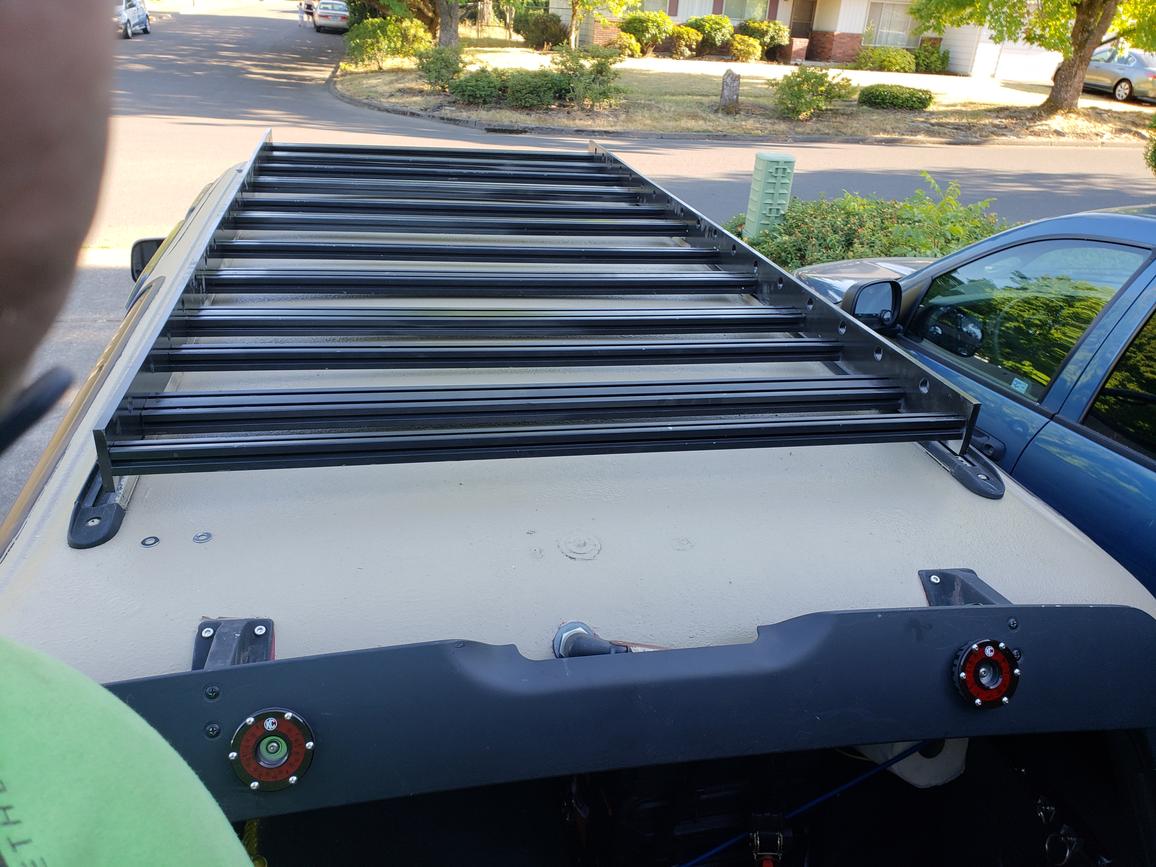

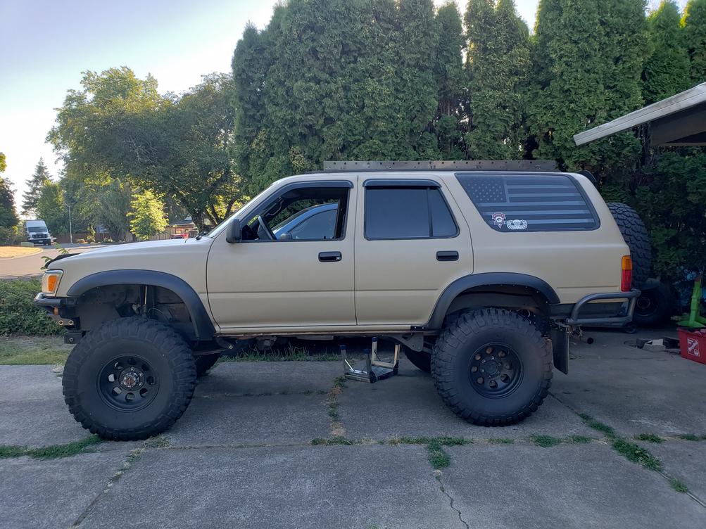

Redid the roof rack today
Used some .25"x2.5"×72" aluminum strip for the main rails.
Gained 1.5" in width. May not seem like much but it will make big difference hauling junk.

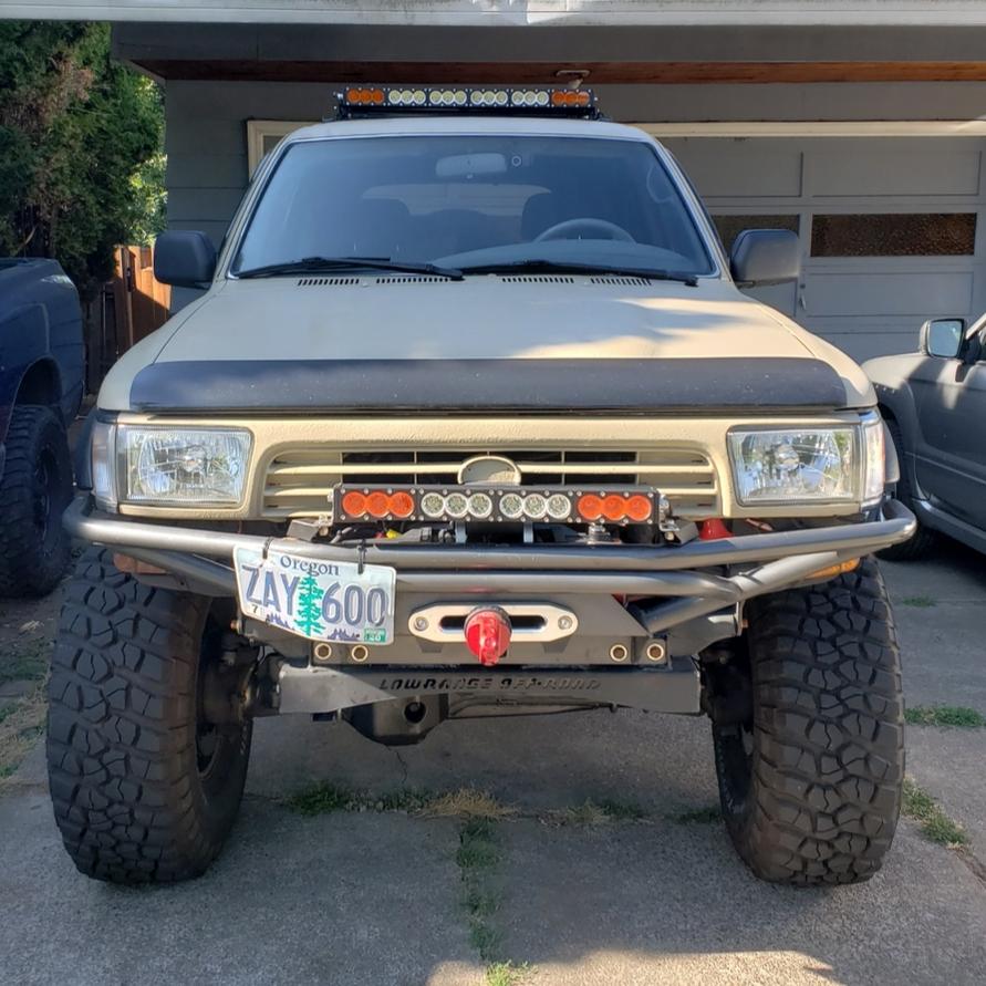

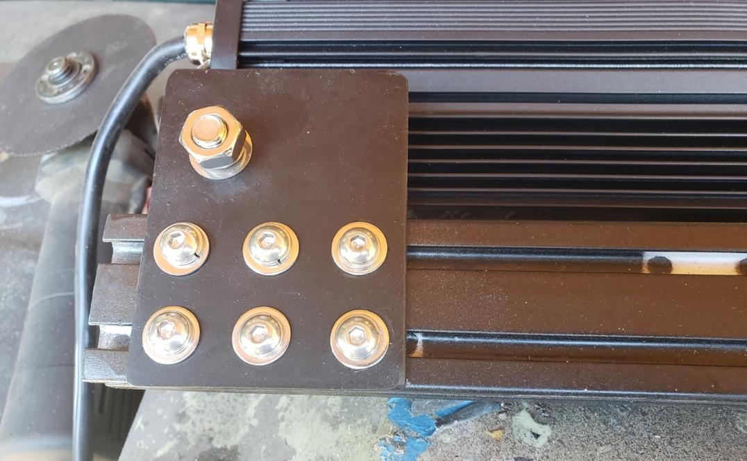

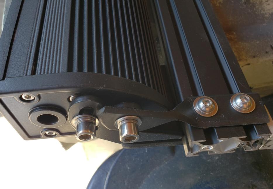

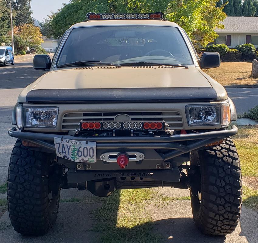

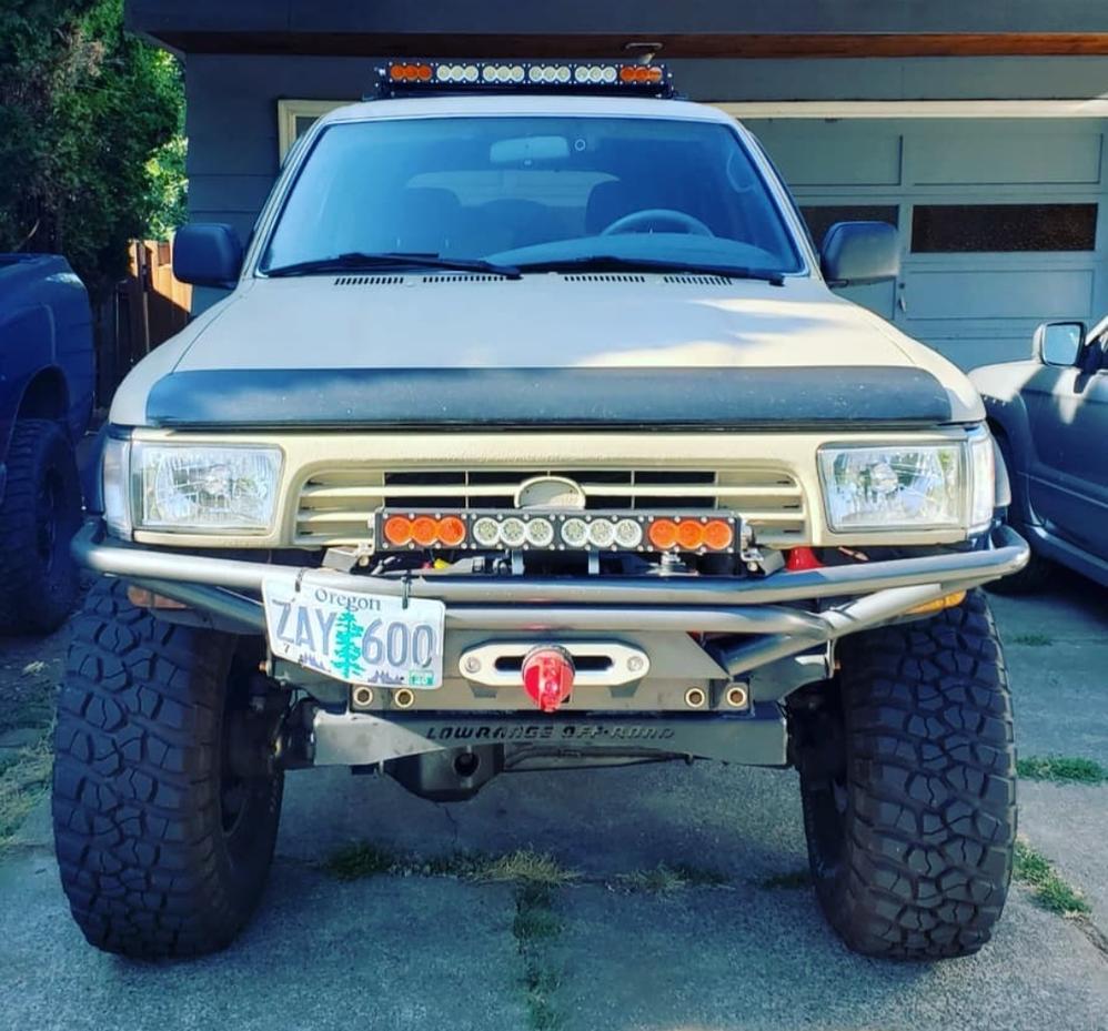

So decided to add some wattage and be able to look more like the big boys
8020 strut is super easy to work with and makes mounting crap a snap
Went with an upper and lower mount for the upper light bar
Both light bars can have the amber come on independently of the center clear lights
I may swap the lower amber lenses out for clear floods

when I mounted my upper lightbar bar one thing that bugged be was as that if I hauled a ladder or something long it would rest on the light bar
I went ahead and reversed the mounts, this lowered the lightbar below the front crossbar. Now the light is about 1.25" lower and right above the roof line. It may have helped the wind resistance a little for the better.
upside is any long load now rests on the crossbar where it should be

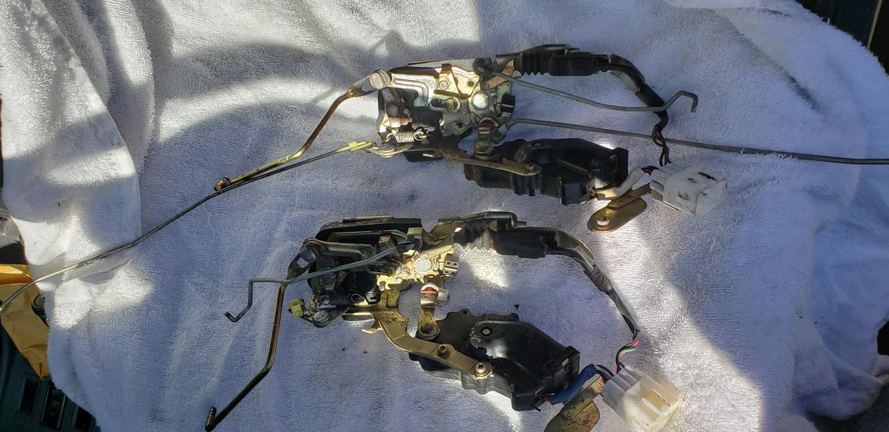

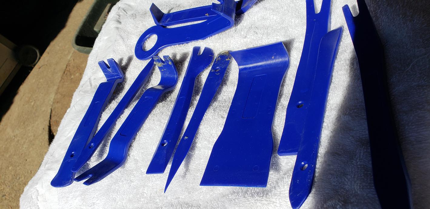

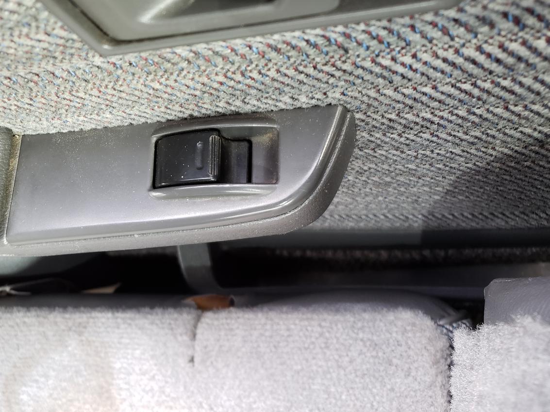

Been fighting an intermittent issue with the driver's side front electric door lock not cooperating. It finally died. Never realized how much I liked power door locks.
Traced it to a bad solenoid. Swapped it out with a good unit.

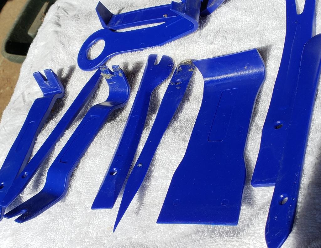

If you do any interior work spend $15 and grab a set of plastic interior tools off Amazon.

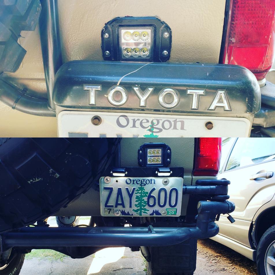

The stock license plate mount on the swing out partially blocked one of the back up lights. Made a new mount the puts it about 3/4" lower.

What exactly were your locks doing? Mine has started acting up as well. When I hit the lock button only one lock moves anymore. Wondering if it's the same issue as yours.
Sent from my XT1030 using Tapatalk
My 95 has similar issues. Almost always the solenoid/actuator. RockAuto has Aisin brand solenoids for $60. You need to be able to pin a connector as it is literally just the solenoid, none of the linkage.
I think they have more complete options on there besides Aisin, but that brand has lasted 20+ years initially so that's who I trust.
Did passenger door last year, passenger rear quit and it's on its way in the mail as we speak.
it was the driver's door that failed. a few months ago it started acting up, not always going up and down. Than it would act like it wanted to go up and down but just sort of only going up a little bit. I took it apart a few weeks ago, cleaned it and used jumpers to activate it. It worked great for about a week and than gave up the ghost.
The rear driver's side power door lock doesn't work and the window doesn't work using the master window controller. I had another free 94 a friend gave me that I pulled a ton of stuff from the shell. I swapped the door and same problem persisted. I am pretty confident that is internal to the wiring in the pillar. It doesn't bug me enough to start pulling the interior to chase the harness.
Losing the driver's door was one i thought i could live with but it drove me nuts after awhile.
I was gonna go that route but got the whole assembly cheap on ebay with free returns so went that route. Plus I hate doing pins..I always seem to screw it up. $30 for a plug and play part was worth it to me, plus the seller guaranteed it would work.
Sometime I will tackle the left passenger door. Hardly ever use it, the grandminion's car seat is on the passenger side..
