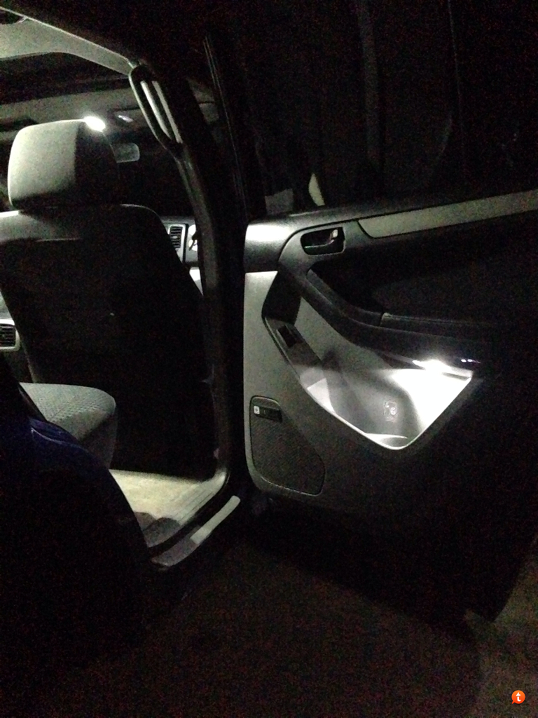

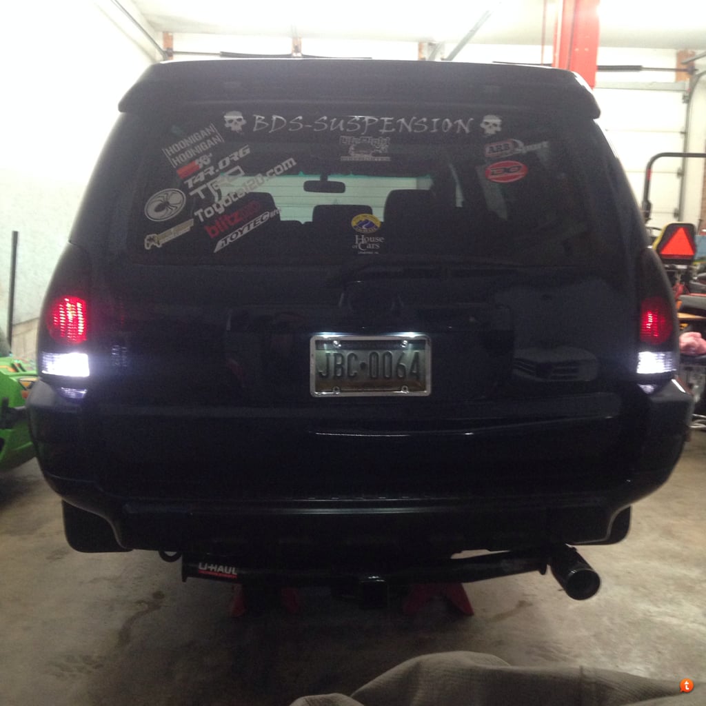

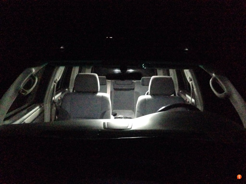

Some LED conversions!
Dome lights
Map lights
Guide lights
Backup lights

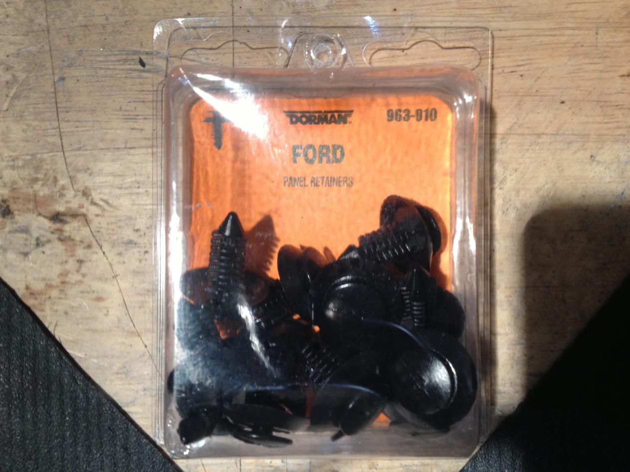

Panel retainers from autozone $6

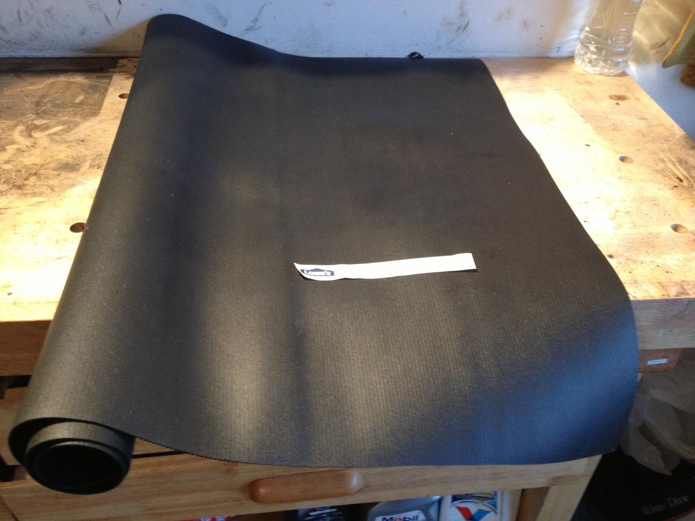

Carpet rubber from lowes $6 (24x24 sheet

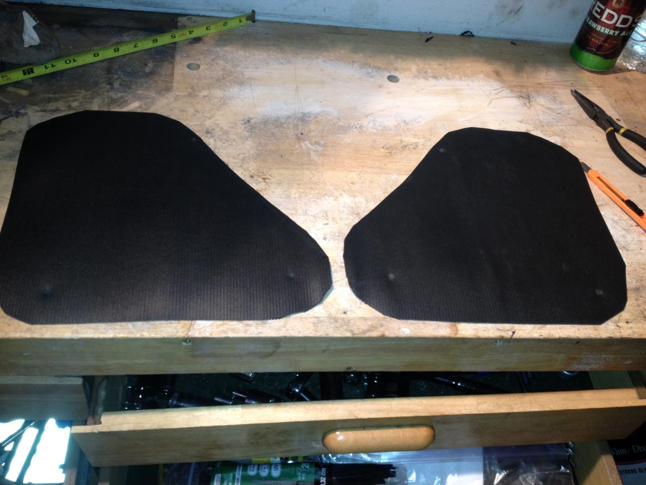

Cut rubber mat with blade to size. Puncture mounting holes with
Screw driver. Seat autozone retainers firmly in holes

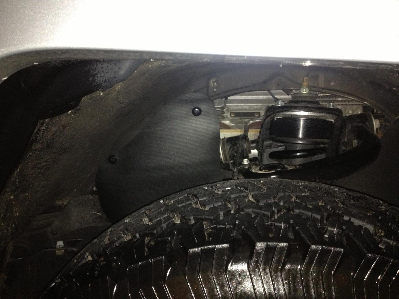

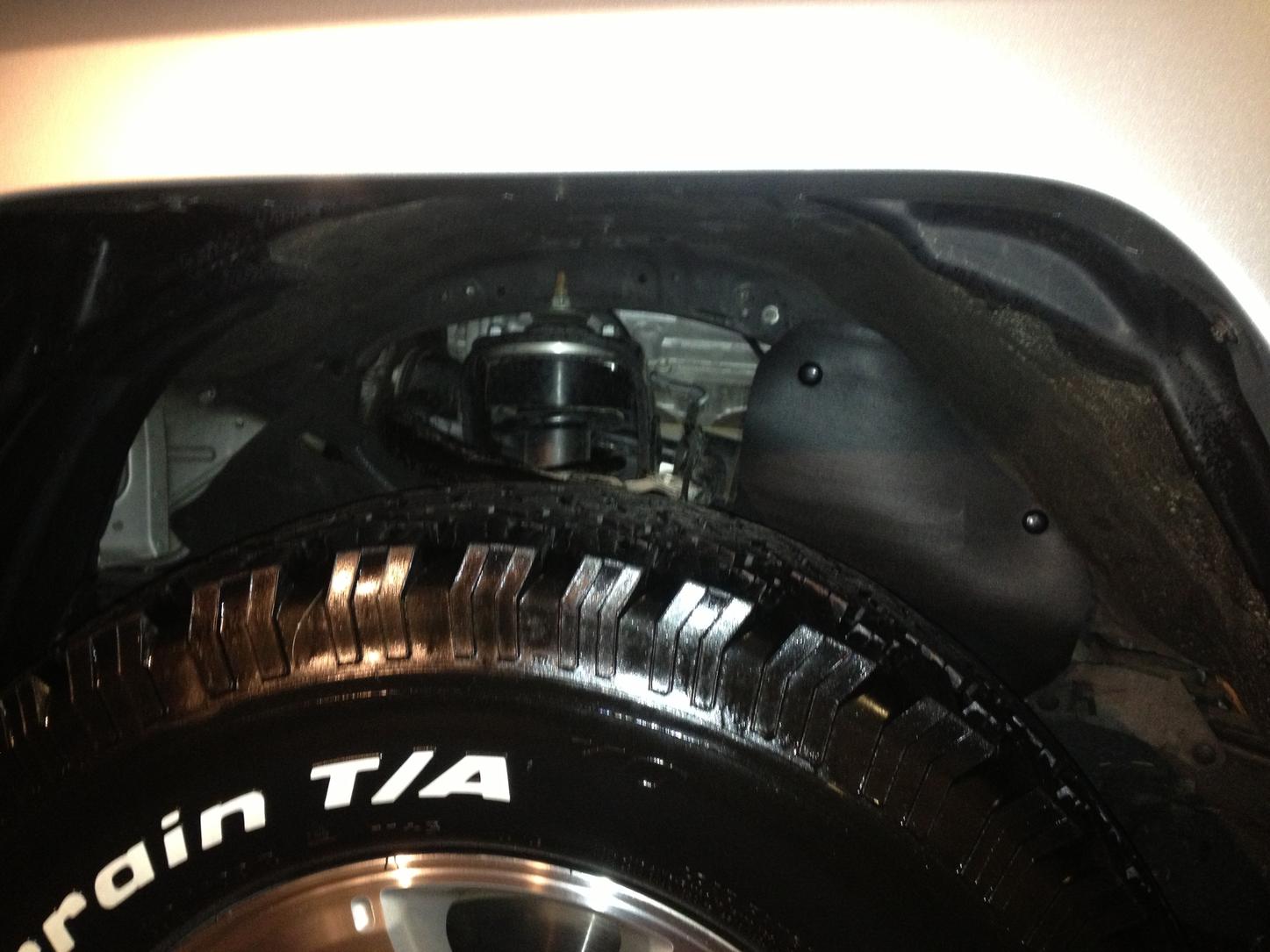

Seat and set retainer and rubber coverings. Smile at how much $ you saved while doing this and the fact that you can no longer see your engine from your wheel wells. Tell your friends...

Rallybud.. Honestly, this came about because I was tired at looking at my engine through my wheel. I eyeballed the majority of it. I can tell you that for all 3 sides I wanted to replace, I used 12 by 12 inch rubber, then started cutting away while eyeballing the set. It's a very quick and easy project. The hardest part is keeping the rubber in place while puncturing the retainer holes. I have no
Idea how long this DIY will last, but is worth loads more to me than spending a total of $70+ on replacement rubber.
