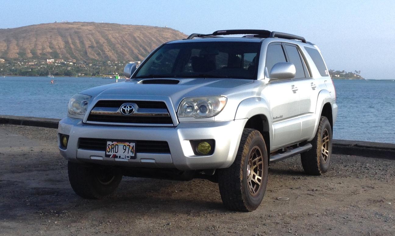

Swapped out my headlight assemblies on my 2006 T4R Sport Edition for aftermarket halos I found on Ebay for 215$ as well as Morimoto HIDs in the highs, lows, and fogs, which set me back about 500$ for all 3 systems. I couldve saved a little money and tried baking open the assemblies I had and custom fitting a projector kit in them but I didnt want to risk it. The assemblies were a piece of cake, even the bolt in the fender well wasnt that hard to get to. Only took off one trim piece in the engine bay and loosened the plastic wheel well covers to do the install. The rough part was finding decent space on the drivers side to mount the relays and ballasts for that side. I ended up mounting them just below the drivers side headlight assembly mounted to the frame with holes I drilled and tapped. It was still pretty rough to get the right spot so that the harness would reach across the engine compartment to the other assembly in an inconspicuous route. The passenger side had massive amounts of room directly behind the assembly. I ended up mounting the low beam relay set on the drivers side and the high beam and fog relays on the passenger side. The Morimoto HIDs are amazing but if I had to change something about them Id want longer wires for the far ballast connection coming off of the relay and longer battery leads.
It took me roughly 4 hours, start to finish and when I initially had everything hooked up I was getting nothing to any of the lights which I thought was weird. After some quick troubleshooting I removed the optional Anti-Flicker capacitors I ordered with the system and once I did that everything powered up beautifully. I have no idea what was causing the capacitors to interrupt power but I just figured I wouldnt worry about it since they were optional anyway. I didnt take many pictures while I was installing them as it was a Friday and I had just got off of work and I was trying to beat the darkness. Next project Ill get much more detailed. I just figured Id share my install of the Morimoto HIDs and the problems I ran into as a first time installer of them.
