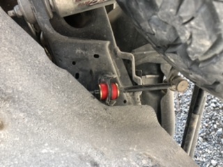

Sway bar end link bushings
My easy weekend mod was to replace the rear sway bar end link bushings. I found the Energy Suspension polyurethane end link bushing set at Autozone for about 16 bucks. Part# 9.8105R. They’re 3/8” I.D. And fit the rear end link with wiggle room. Bonus is there’s 8 bushings in the kit so you and a buddy can go halvsies or you can keep the extras to replace later if they wear out. I did re-use the factory washer on top of the bottom bushing but used the washers on the top and bottom that were supplied in the kit. A 14 mm end wrench and a 12 mm ratcheting end wrench were the only tools I needed.
