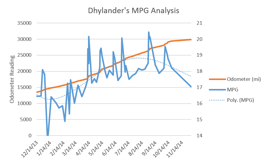

Here you go [MENTION=94375]dhylander[/MENTION]! Looks just like [MENTION=108420]EasyAndy[/MENTION]'s graph. I took only the last year's data and I put the poly 4th order trend in there and you can easily see the difference between summer and winter. Yours is not quite as big a difference but you can definitely see it. You will probably drop a bit below 17 before you bounce back in the summer. Looks quite a bit different than your bar graph.
Basically I just wanted to show (and prove to myself with real world data besides my own) that there is a marked (7-20% average depending) between summer and winter gas.
Here is the graph:

[MENTION=94375]dhylander[/MENTION] Hope you don't mind, but I poked around in your data. Not that 1E is wrong, but I made some different assumptions: gas is either summer or winter (a rectangular function: summer, winter, summer, etc.; not a polynomial) and that winter gas begins in mid-September and ends in mid-May (as AAA says it did in Denver). I also weighted your data for miles between fill-ups. Here's what I found:
Effect of summer vs. winter gas: 0.91 MPG
However, you drive fewer miles per day in my designated winter months. Perhaps this means you do more city driving, I don't know. So I looked at the combined effects of summer/winter gas and the days between fill-ups (also weighted by miles). And then this is what I found:
Effect of summer vs. winter gas: 0.75 MPG
Effect of 1 week vs. 2 week fill-up: 0.49 drop in MPG when fill-up is two weeks.

I simply used the polynomial trend to smooth the curves not due to strict function.
Now let's get into the more esoteric areas for a minute.
You maybe need to consider a few more variables before making a strict date assumption and the curves sort of prove this:
Gas Mixing
Basic assumptions:
Let's say mid September the stations get their first supply of winter gas. Well, the tanks still have some summer gas in them so the winter gas and summer gas are mixed for a period of time! This means a hard date is tough to pick. Same for your gas tank. You have a half a tank of summer gas and fill up with winter gas so you are running a blend for a time. Now to compound this problem (and this happens year long) you have the Ethanol blending. You could fill up with UP TO 10% Ethanol, depending on what the refinery blended. It could be 2% or 7% or 10% and that will have to mix with whatever you have in the tank!
That's why I wanted to look at a year long trend. Not linear but something that would approximate the actual curve, hence polynomial.
If you look at the beginning of the curves you will see lower mpg than the end of the curve. I think that is due to the fact that they have been running winter gas for that whole season instead of just Oct-December. Who really knows but it's fun to try to figure it out.

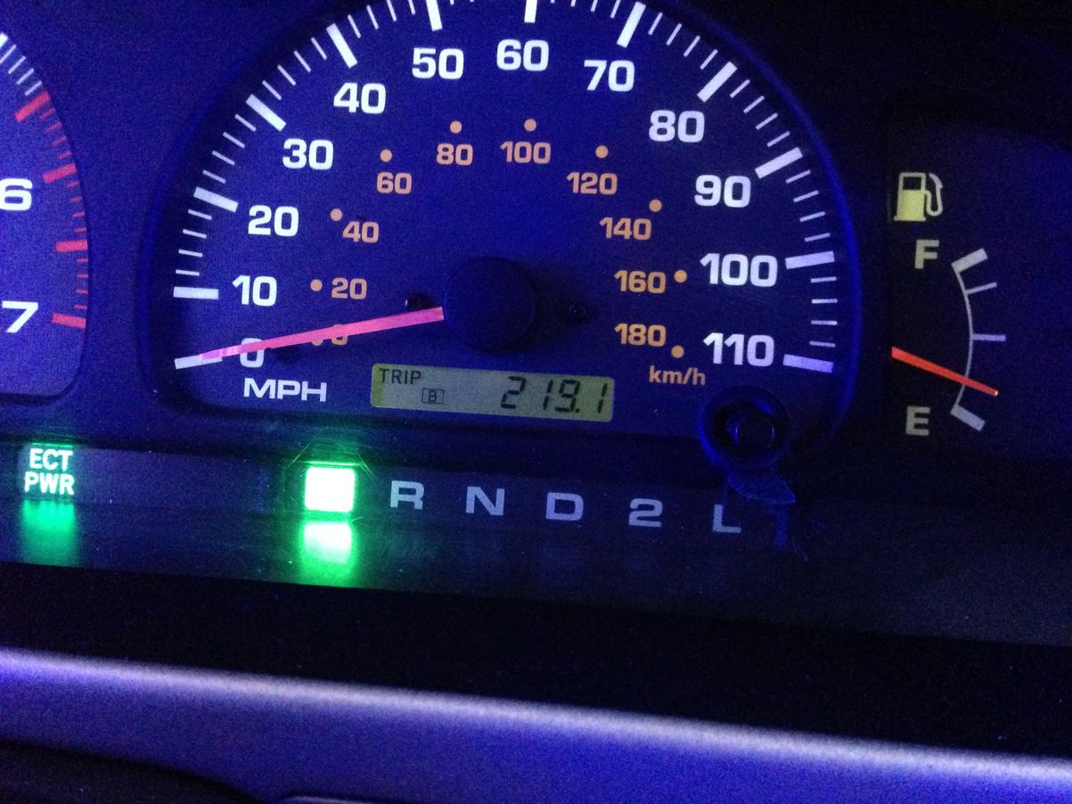

Mostly around town driving with ECT. always on,Sorry i have no chart. :lalala::biggrin2:

Agreed! It's fun to try to figure it out.
My basic assumption was SOP, not strict. But I think it's a closer approximation than a curve that takes months to approach maximum. Here are a few items from the The Association for Convenience and Fuel Retailing (NACS) about the fuel retailing industry from their 2014 Retailing Fuels Report:
"The end point in a series of handoffs to prepare for summer-blend fuel is the date at which retailers must sell the fuel. In most areas of
the country that require summer-blend fuels, retailers have until June 1 to switch to selling summer-grade gas." ... "The May 1 deadline for terminals is considered one of the biggest factors in the seasonal price increases. Terminals have to fully purge their systems of winter-blend fuels and be near empty to make the transition and be in compliance [with EPA regulations]. Those out of compliance face stiff penalties, so most terminal operators would rather be out of inventory than out of compliance."
"Unlike in the spring, the change to winter-blend fuel is not required. However, because winter-blend fuel costs less, retailers obviously want to sell the cheaper fuel so they can be as price competitive as possible. Not all retailers begin selling this fuel on September 15; most wait to make the switch until their inventories are low and need a new shipment. A retailer’s volume will dictate how often a station gets deliveries, with some stores getting multiple deliveries per day and others getting one or two deliveries per week."
So ... you won't be finding much winter gas in June, and you won't be finding much summer gas in October, except for whatever residual is remaining in your tank.
By the way, this report can be found at:
http://www.nacsonline.com/YourBusiness/FuelsReports/GasPrices_2014/Documents/2014NACSFuelsReport_full.pdf
As for 2% ethanol vs. 7% ethanol vs. 10% ethanol, I have no clue. No clue whatsoever.
Oh. And California's summer gas deadline is April 1, not June 1.

[MENTION=66316]1engineer[/MENTION], I thought they would be similar and I think the difference in my data would reflect a larger offset if I was on the same tires for the entire year. April 1st I took off the LE wheels and 275/55/20 Mich MS2's and put 265/70/17 AT3's on. I figure I lost about .75 mpg from that change.
[MENTION=101428]Bilbo[/MENTION], I don't mind at all and your assumption is correct. I drive from April up until mid October a couple of times a month to our lake house in VT. Although I do wheel some while up there which brings that down. I did however change tires beginning of April and going to the 265/70/17 AT3's from 275/55/20 Mich MS2's hit me about .75 mpg as best I can figure. Not really enough data from earlier on with the Michelin's installed to get a real number.
