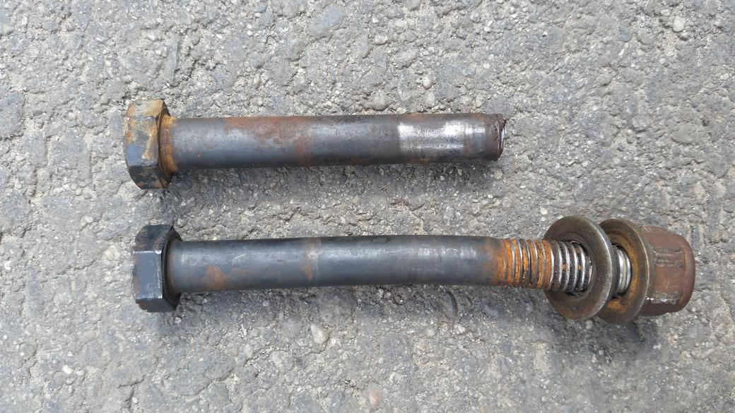

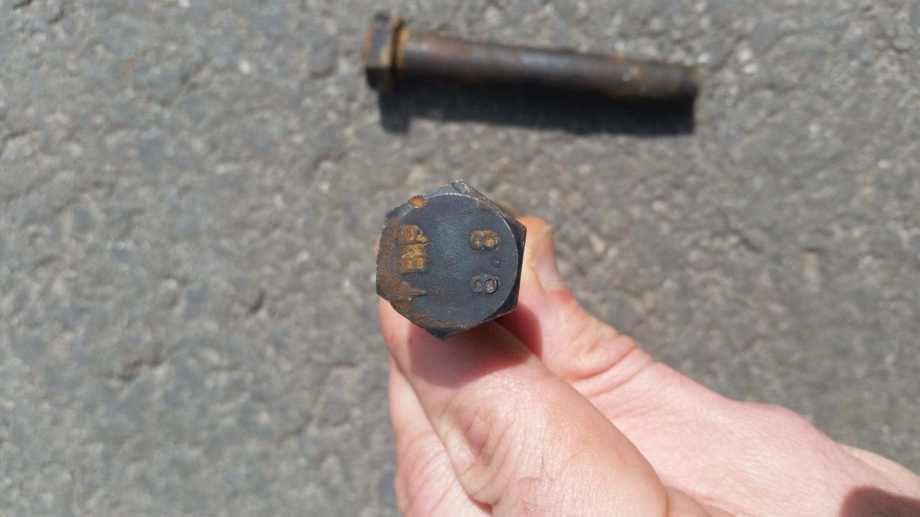

yep, 8.8 metric is grade 5 as noted. you need a 10.9 metric bolt, which is equivalent to a std grade 8 bolt. sorry, not sure on diameter or length, shouldnt be too hard to measure
Someone just pointed out on the other Ebay UCA thread that this set of UCA's appears to be installed upside down. I'm not sure if this would increase the potential shear force on the bolt or not.
sweet moses i didnt even notice that it was BACKWARDS.
I am trying to save up and buy these so I am not happy to see a failure....BUT if they were installed upside down and/or backwards then its very hard to blame the parts.
I also suspect all of that grease on the uniball is holding onto some road salt if you are from the northeast. Having studied some corrosion and material issues in my past life in the Navy it would not be surprising in the least if corrosion helped it fail early.
Stainless Steel (depending on the type) + Chlorides + Tensile stress = stress corrosion cracking (that normally leads to failure)
Stress corrosion cracking - Wikipedia, the free encyclopedia
I wouldn't call it a failure of they were put in wrong. User error.
Think of the stress out on that bolt not following the correct geometry! It could be astronomical!
Well, if they came with 8.8 bolts I wouldn't call that user error. Now if they were over torqued as one post mentioned, then by all means user error. Or a combo of both, an incorrect grade bolt that was overtorqued!!
I don't see why anyone would use less than a grade 8 (10.9) in this apllication...scary!!

I had the uca installed 6month ago in nyc. There is obviously corrosion after 6 weeks in salty environment. But if they were installed wrong thats bad and it could have added the stress on the bolt, or the strength of the arm .Also that bushing seems verry tight I could hardly move the control arm by hand. And some of the bushing shaved off.

Yikes, it looks like your other side was about to snap, also.
For sure, your UCAs are on the wrong sides, you should have it fixed ASAP, regardless of stronger bolts being installed. According to the other write up, the spacer inside the bushings are too short, causing the bushing to be compressed. You will need to shave the bushings down for them to work properly. I would wager that your bushings are shot if they were used in that state for a few thousand miles.

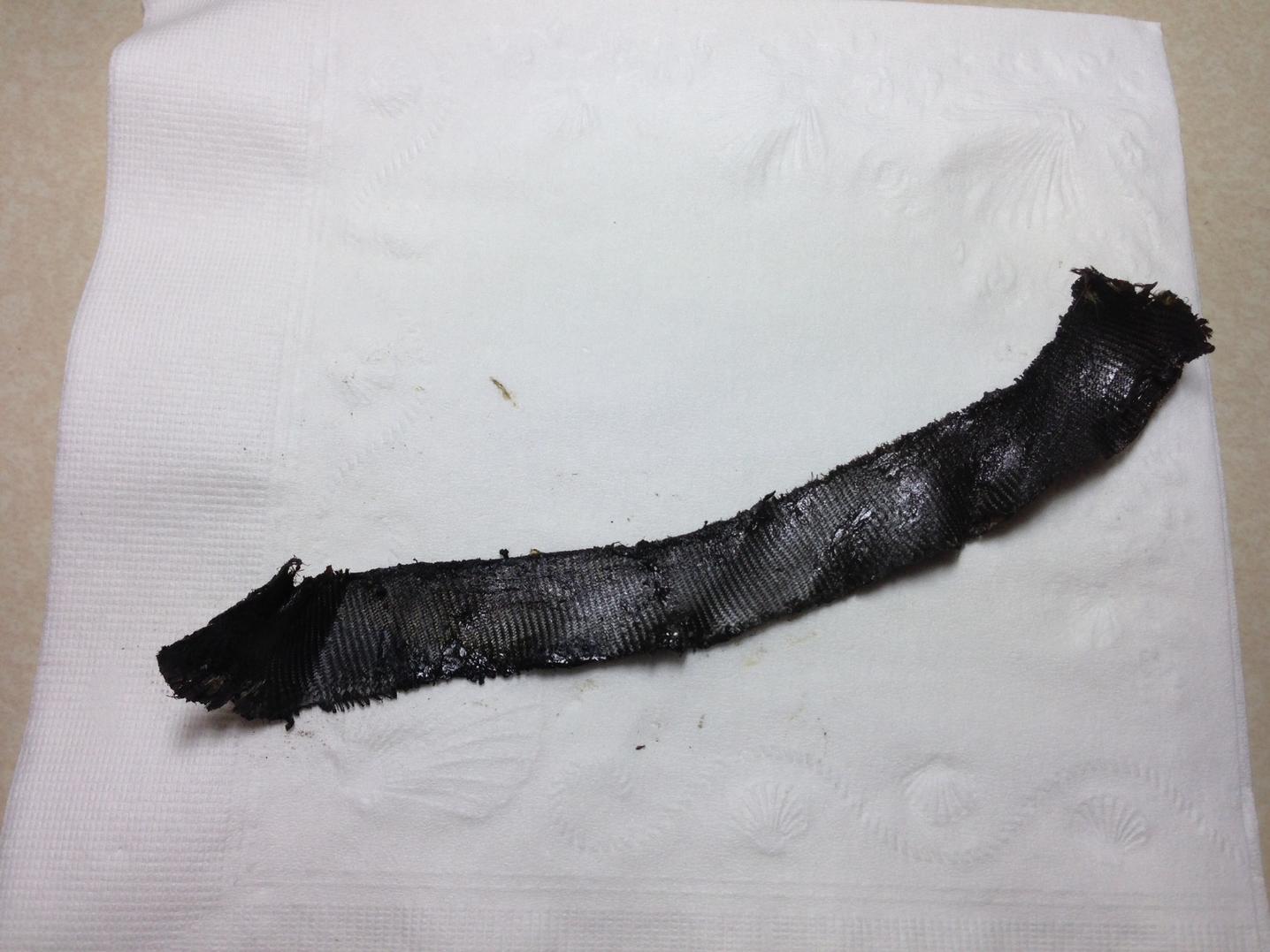

I have been running my EBAY Silver UCA's for 45 days or so and just noticed today that the passenger side uniball puked a "cloth" like liner. See Photo. Now the uniball is very loose. Checking into a quality replacement uniball. I sure hope it's not some unusual size! I will post the size as soon as I have time to remove the arm from the vehicle. I'm beginning to regret trying to save a $. IMG_5947.jpg
That sucks. You can replace the uniball without removing the arm if you have a ball joint press. The stainless uniballs that Total Chaos use are FK WSSX16T. You can get them from Summit for $45
That does suck. Total chaos unilballs should help though, and although a pain, is still cheaper than buying Total chaos arms.
