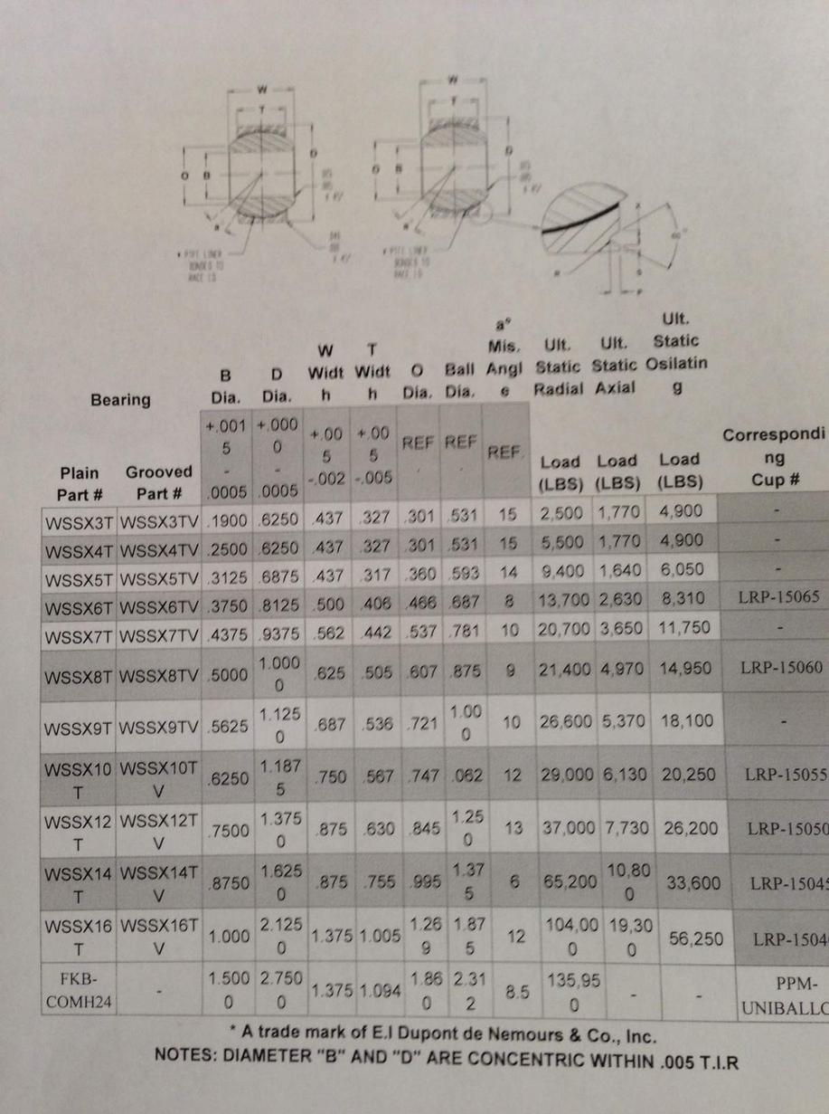

That sucks. You can replace the uniball without removing the arm if you have a ball joint press. The stainless uniballs that Total Chaos use are FK WSSX16T. You can get them from Summit for $45

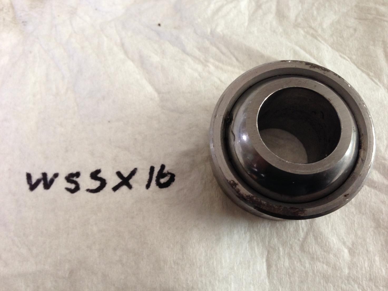

It appears that FK WSSX16T may the part number for the uniball but I will not know for sure until I have it out of the arm. I will be using an arbor press in my garage so the arm will have to come off. Hopefully Kartech has some uniballs in stock, I need my ride ASAP. BTW, Total Chaos is a world class operation. They know their stuff and have been very helpful in the past. I will be using them next time.

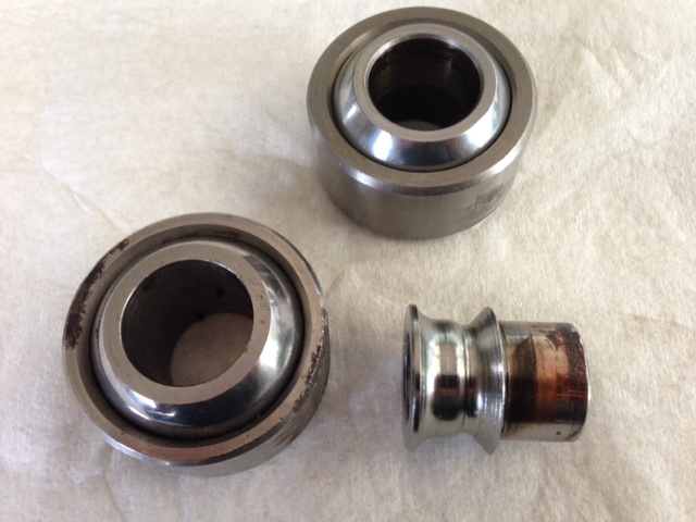

I have been running my EBAY Silver UCA's for 45 days or so and just noticed today that the passenger side uniball puked a "cloth" like liner. See Photo. Now the uniball is very loose. Checking into a quality replacement uniball. I sure hope it's not some unusual size! I will post the size as soon as I have time to remove the arm from the vehicle. I'm beginning to regret trying to save a $.

In fact, the question about lubrication is a good one. The arms came lubricated with a heavy grease. Not what I would have used since most PTFE run with dry lubricant to avoid attracting sand and dust. I could not get a reply from the seller about lubricant so I just wiped away the excess grease. I had no way of knowing what kind of uniball was installed.

Here it is.....the uniball is a standard size 1" ID. Off to locate good quality replacements.

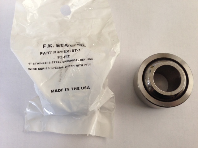

Found another issue while disassembling the UCA on the other side. The misalignment bushings (top and bottom) are just a little too long. When bolted together the shoulders bottom out on each other and do not snug against the uniball. when you turn the spindle the uniball was not rotating, the spacers were spinning inside the ball. This was not good! Wear can be seen on the shoulder of the spacer. This wear took place in a short 45 day period. I may have not noticed but because of the failure of the uniball on the other side I was looking closely at everything. Kartech was out of Stainless Uniballs but Total Chaos had some in stock. The recommended uniball for a street application have a 17-4 stainless HT body with a 440C stainless HT ball and is PTFE coated. This prevents rust when subject to water.

@tmb3202 I have been running FK uniballs in my long travel truck for years without excessive wear. This liner coming out is common in race truck abuse, but not 45 days of four wheeling. Glad you upgraded.
I carry these in stock at the shop if any one needs an upgrade :beer:
