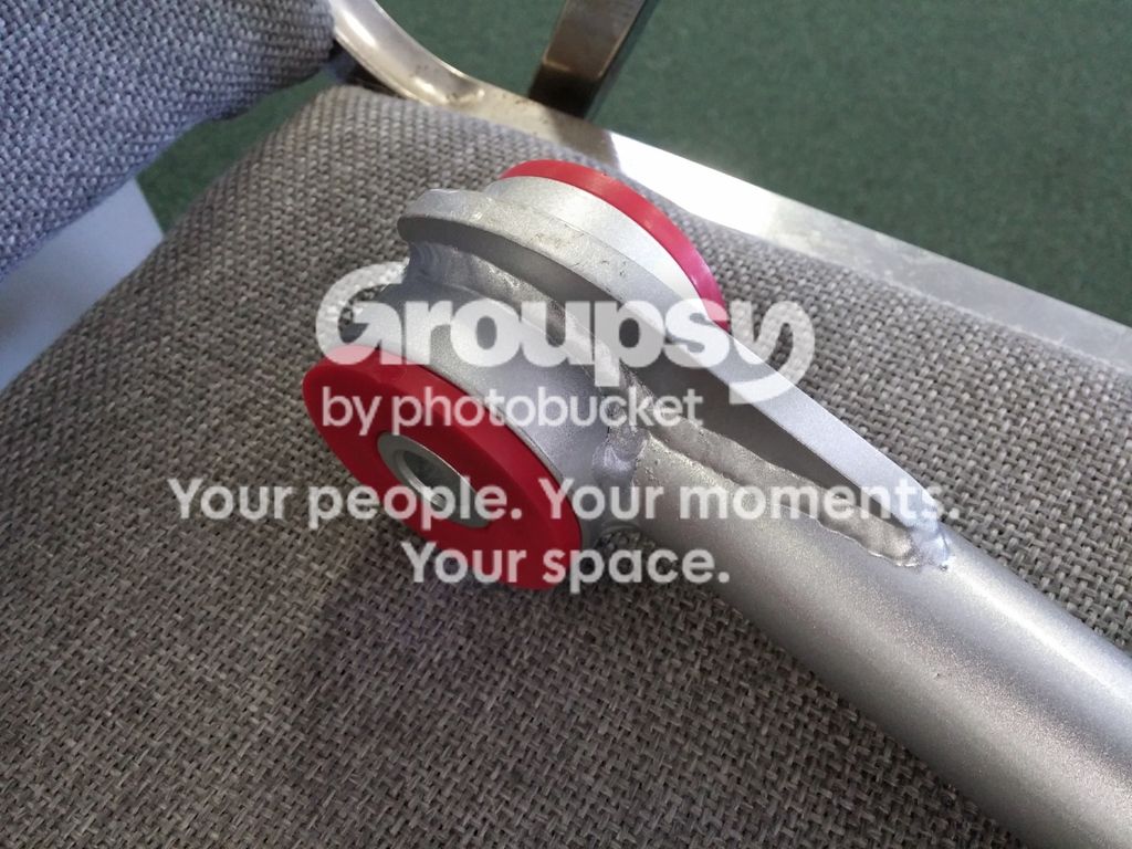

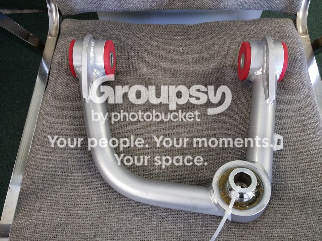

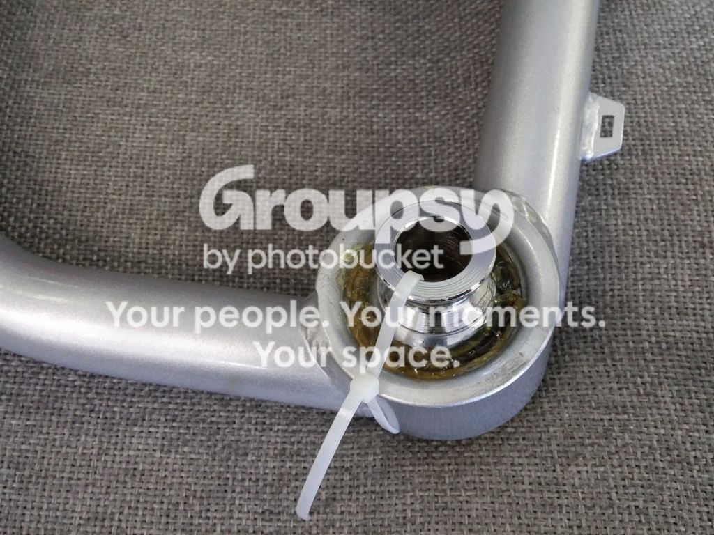

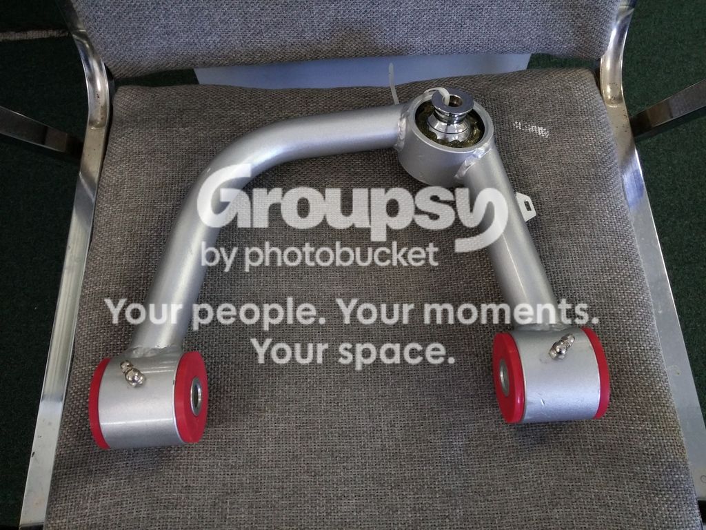

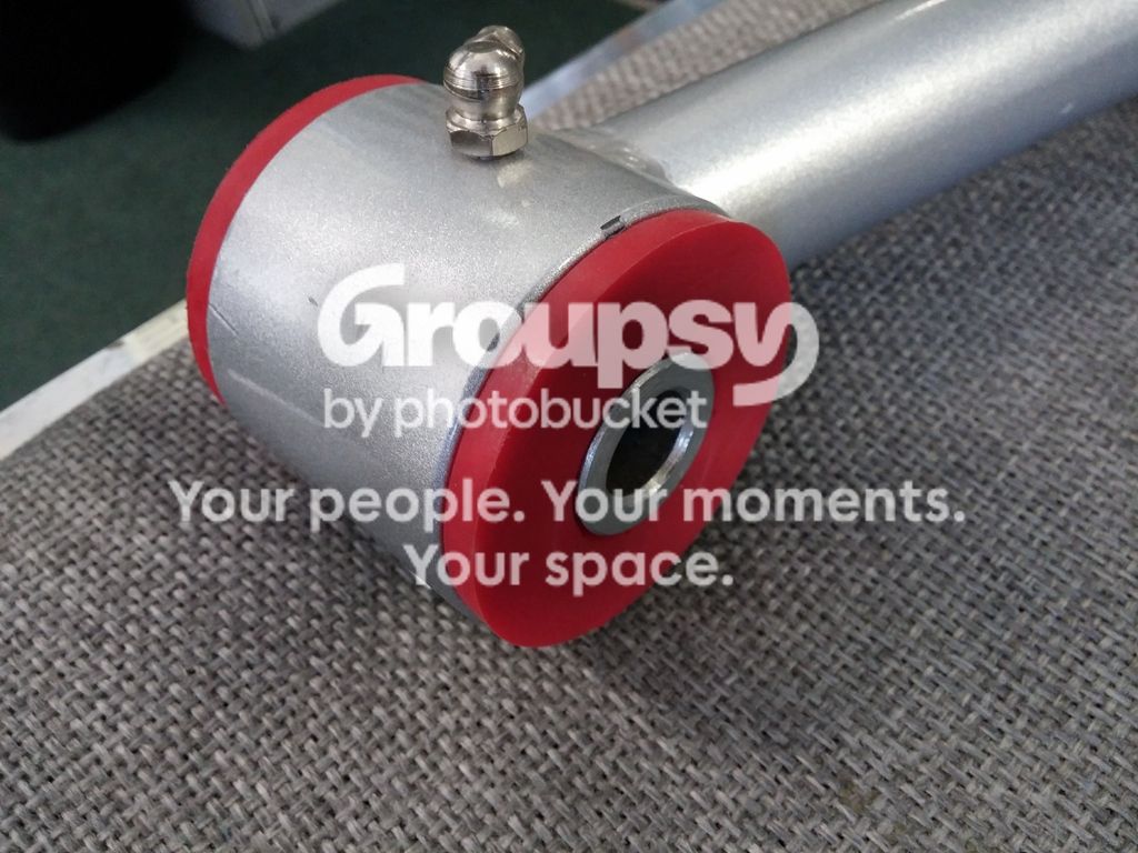

I just got the UCAs in. They shipped fast! Unpacking them, they're beefy for sure. The welds look okay, the powder coat looks pretty good, all the hardware is good minus the 8.8 bolt. I'll go get a real grade 8 bolt from Lowe's before I put them on. The spacers look like they're flush with the bushings, so we'll see when I go to install them. I'll get some pics up here shortly of the unboxing if anyone is interested.
