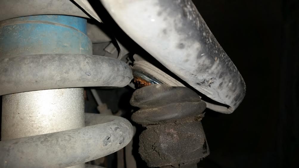

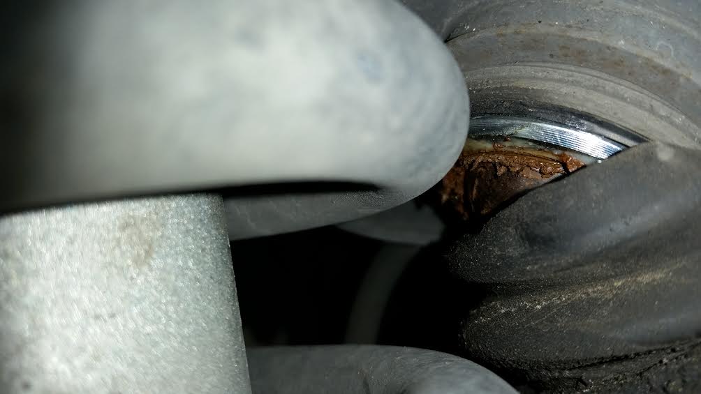

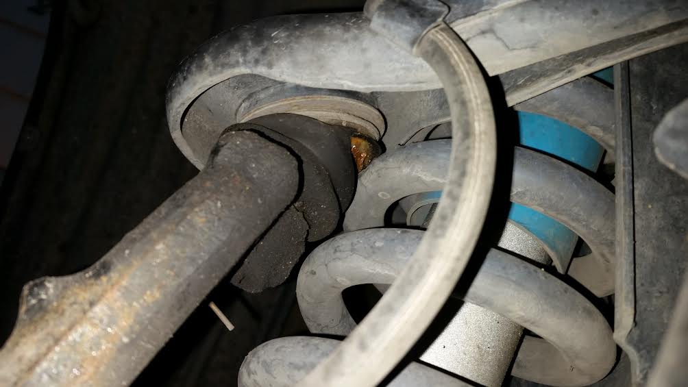

Developed an irritating squeak up front over the weekend. Had some time today to pop the tire off.... Out of any of the new purchases of these, have they corrected the issues with the sleeves/bushings? I already ordered these and bought upgraded bolts. Just curious if i need anything else.

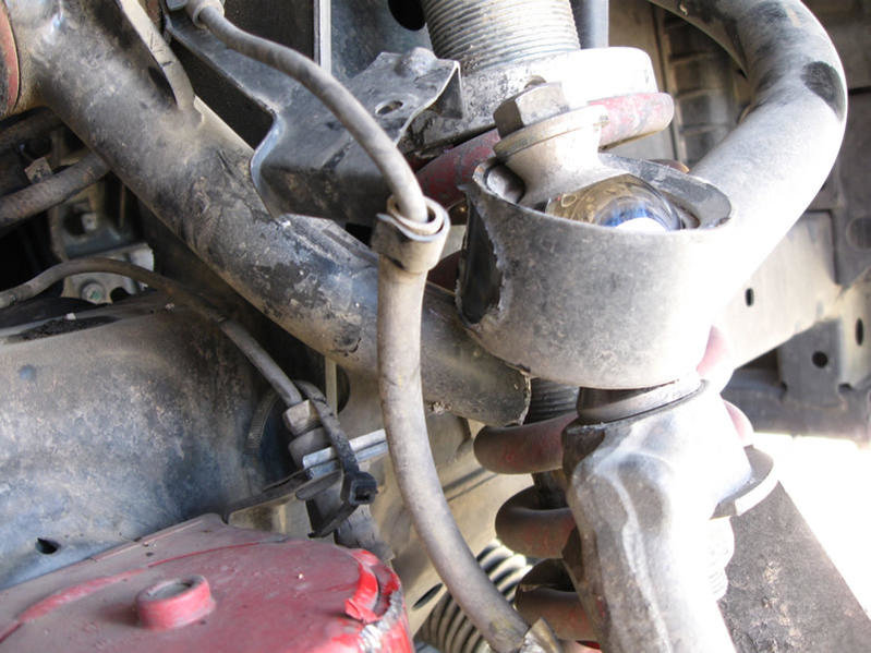

Source on the arms breaking at the weld? This is the first I have heard
We were mistaken, they were the Allpro arms. Look identical hence the confusion, same fabricator maybe?
tacomaworld .com/threads/light-racing-control-arms.13008/page-3#post-191294
img_0608-jpg.11824
Fair enough. Thats still the first time Ive heard of someone breaking a uniball arm. But judging on the light racing jounce shock bumpstops, that guy was going real hard haha. And yeah, seems all the arms look pretty much identical
img_0608-jpg.11824
This failure is not due to poor materials or design ... just a cold weld, i.e., a guy with a torch that should have remained at his job as a butcher ...
No offence to butchers intended.
IMHO, some places use the wrong process for the job at hand ... MIG, where TIG is called for. I cannot tell from the photo, buuuuut..
