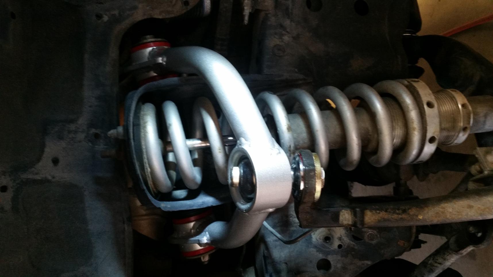

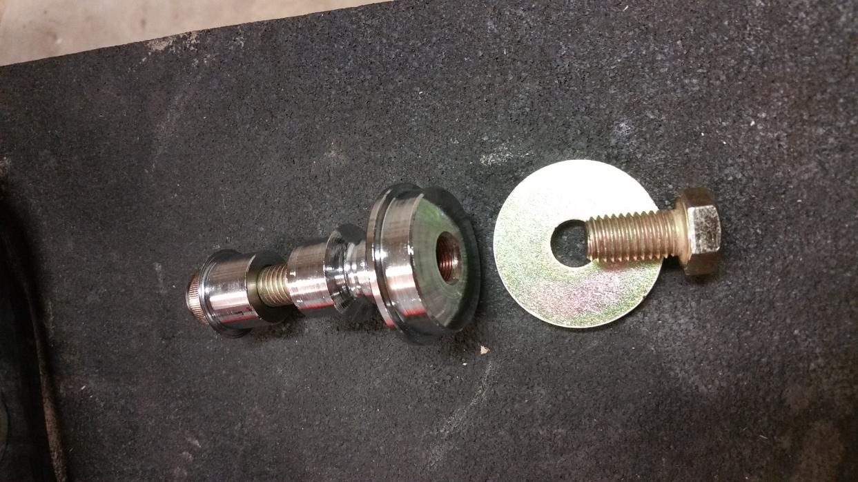

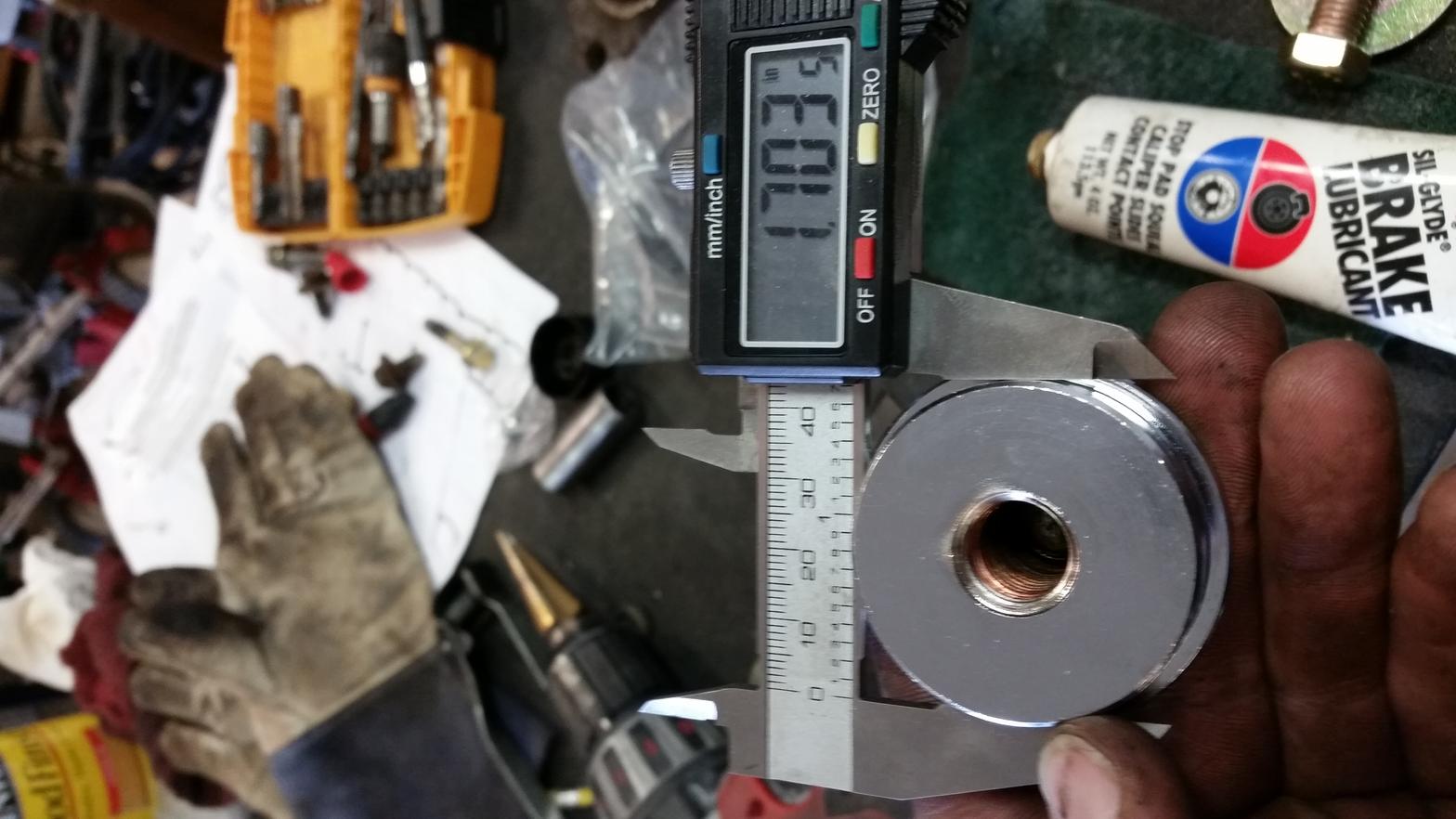

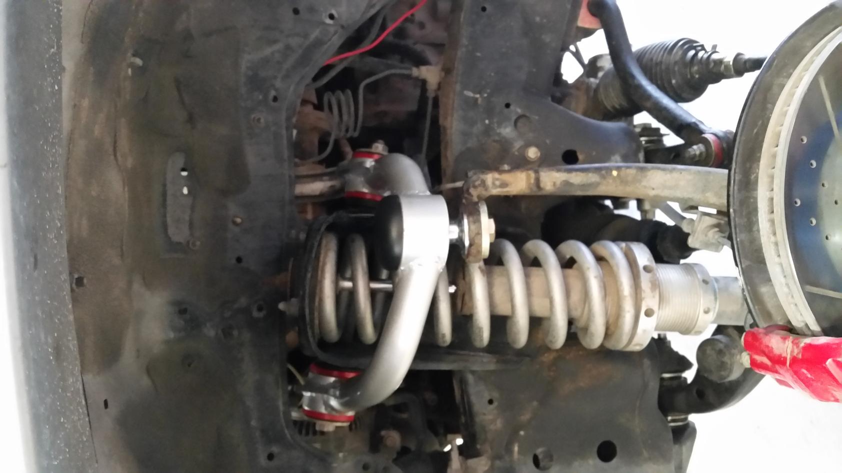

UCA's arrived today. Bushings are still much wider than the metal sleeve but that seems to be an easy fix. The uniball was NOT covered/packed with grease. The bolts seem to be upgraded, looks like metric grade 12.9 Allen head bolts with a grade 8.8 nylon lock nut. Bolt has "TH" and "12.9" stamped on the head. Nut has "S" and "|8|" stamped.
I'm at work now but I'll upload some pictures by tomorrow
I just installed a set of these arms on my 3rd gen and like a couple others have said they seem to have updated the hardware. The bushing sleeves are still pretty short so i just doubled up a couple washers to get it to where its supposed to be. The spindle adapter is very snug and presses in from the top with a bolt on the bottom. The new hardware is all 12.9 grade.
Even comes with a cap up top to seal out the badness(if your into that sort of thing) :)

Have not installed yet, but while inspected everything I can not get the uniball to budge the slightest bit by hand. With the bolt and adapters/fittings through the uniball for leverage the thing won't turn/spin/move at all. Is this normal?
EDIT... After some extra leverage I was able to get full articulation from the uniball and now they easily move by hand. Sprayed in a few drops of silicone dry lube and moved the uniball around a lot.
Mine were pretty tight, but I figure they should be just fine once I start running them. I was able to to get them to move a but with the end of my ratchet. You could always install the adapter in the spindle first with the contol arm before bolting the frame side up.
