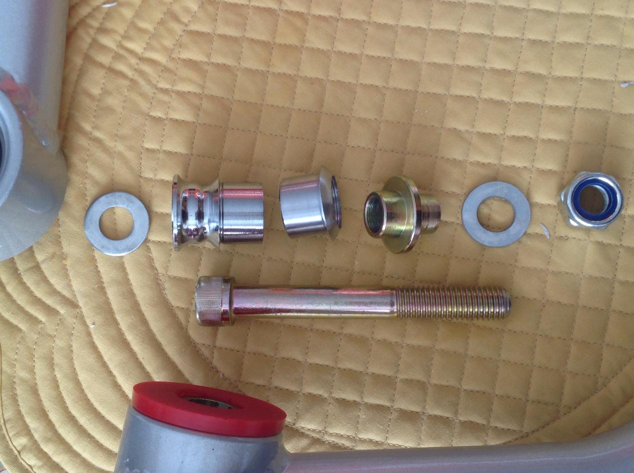

Is the the correct order for the uniball bolt on a fourth gen? Don't want to mess it up and no instructions came with them.
I have read some installs on third gens and the total chaos instructions but still a little confused...

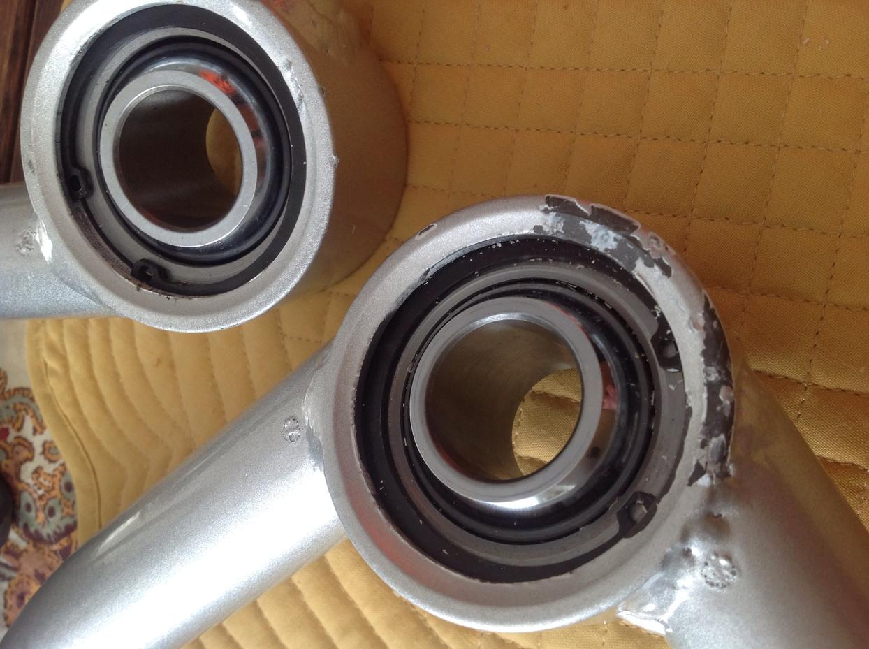

Had a little paint damage when it arrived.. From pressing in the uniball I'm assuming.
[MENTION=115212]YukonT4R[/MENTION] Who was the seller you bought from? That looks like it was damaged in shipping.
Suspension Marketplace was the ebay seller... They seemed like they were packed well for shipping.
I suspect they damaged the paint when they pressed in the uniball.

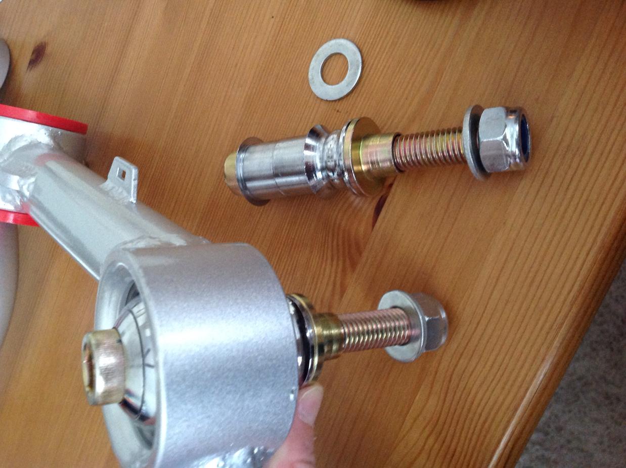

That isnt right, flip the two misallignment spacers, so the one with the conical part is on the bottom.
Yup that way makes sense. Dust cap will fit this way.
When assembled this way the second washer provided is left out... It doesn't make sense for it to go on the top.. Maybe it was for the older bolt design.
