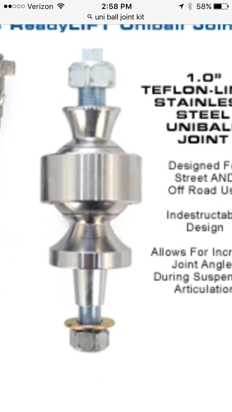

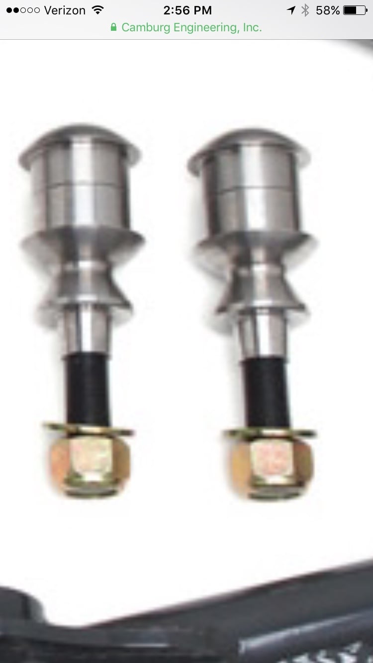

So my uni balls were fine. The issue is with the hard ware that the bolt goes through.
I need to find a place where I can buy this weird wedge piece that is below the uniball and sits in the top of the spindle.
Here are photos of the pieces I need.
They're called misalignment spacers.
They're cheap from other vendors, anyway. What was the issue with yours?
I believe it is the source of a bad pop and clunk sound I am getting. The uniballs are good and I just replaced the bushings.
