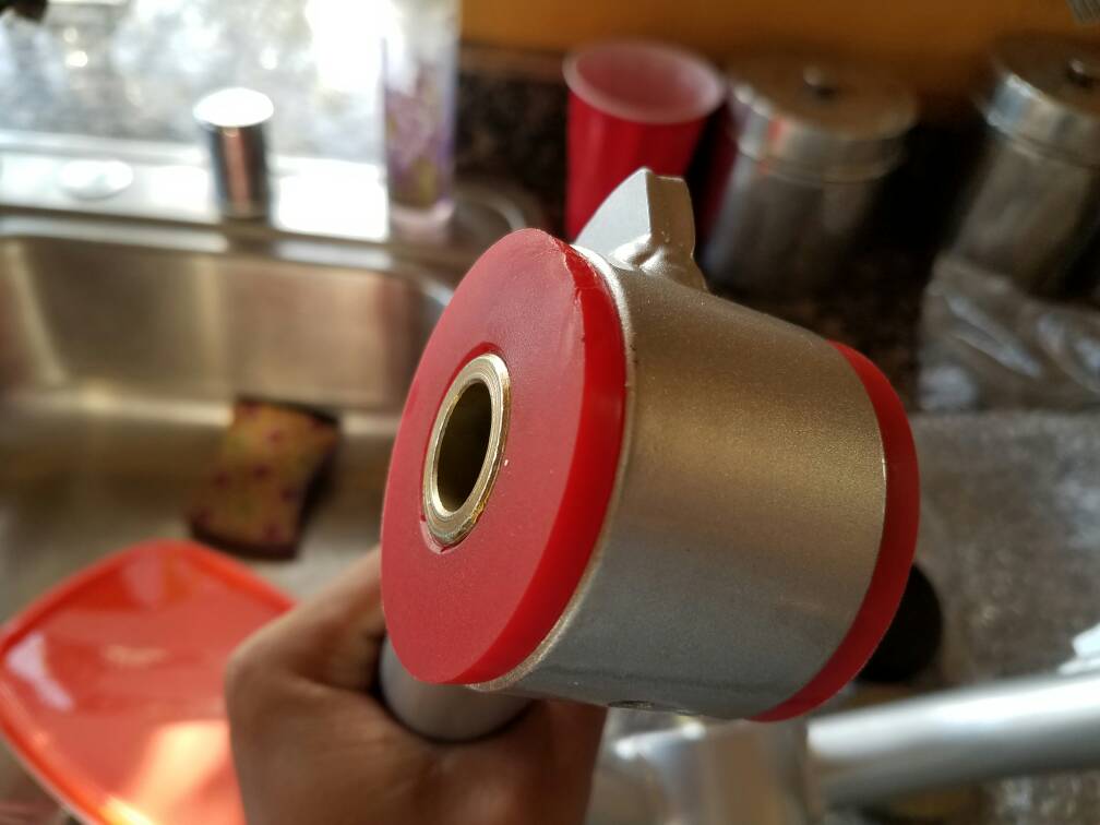

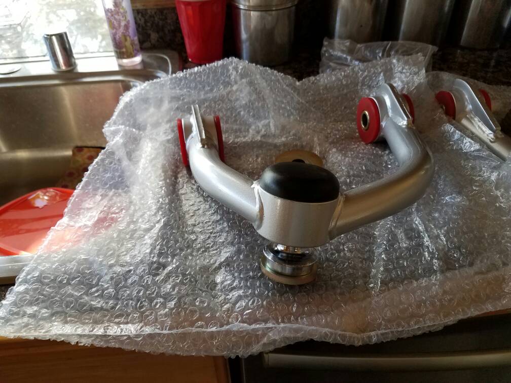

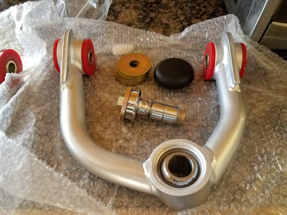

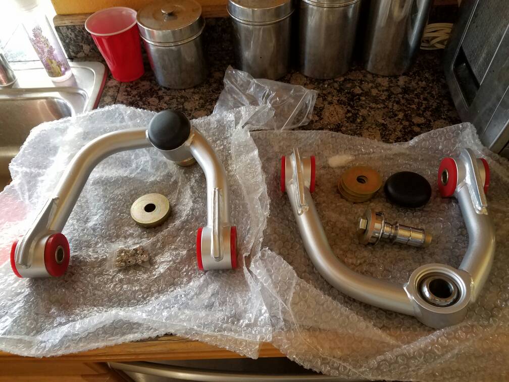

Here's what mine looked like unpacked for 3rd gen. A little different but similar.

Honestly, the garbage uniball is the only caveat to these eBay arms. It's one of the corners they cut during the manufacturing process. I've been waiting for the slightest sign of wear on mine, and plan on replacing the uniballs with FKs and proper misalignment spacers.
As for the rest of the arm, I don't think there is much to worry about. It is extremely unlikely that one of the welds will break or something would shear (besides the uniball!)

You're absolutely right. You cannot tell how strong a weld is, structurally, just from a visual inspection. But, in my experience as a welder, and being around structural welding inspection... they look fine.
My biggest concern is, and always has been, with the uniball. Second up, is the sleeves. With those issues cleared up, I would trust these as much as the TC or Camburg units.

I wanted to know if they addressed the inner sleeve being too short and the ID of the inner sleeve being too large. I don't want to buy something and then have to chase around for extra parts to make it work. One would think that since they have been available for quite some time, and there have been plenty of complaints, that the simple problem would have been addressed. I mean, how hard would it be to include a simple piece of metal of the correct dimensions? It would make this product a great buy, and give the seller a lot more purchases, I would think.
from what i see now, since i received these arms a few days ago, the sleeve being too short has been resolved, its now flush with the bushing, but i don't know about the inner diameter of the sleeve yet, but i might just order a couple of sleeves from all pro just to have on hand when i go do install these just in case.
After seeing [MENTION=118321]Jetboy[/MENTION]'s post, if I get these arms, and the ID is off I will get new sleeves that fit, and probably order the stainless misalignment spacers. It still comes in at a hefty savings.
Emailed suspension marketplace about ID issue, got emailed back stating that they only have one style of sleeve despite length correction. If more would bring it up maybe they would change ID as well. I too bought different sleeves.

I bought mine, then called and complained when they got here about the sleeves being too short. Then I made them send me new ones!
They were the correct length and ID. But you could tell someone made them just for me.
