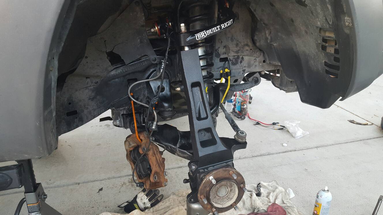

You can also go with Built Right UCA sold by The Truck Shop in San Diego. I got in the group buy at Tacoma world. That's what I run on my 4th gen and they've been well tested.

They are quality UCA. The guys at the Truck Shop use them and they are big offroad guys. They are cheaper than TC, camburgs, Icons. Mention T4R forum and get a discount as well. I'm not affiliated with them, just a happy customer with good experience.
Just called and there is no T4R discount. Used to be a group buy but that's over. They are $509.
hate to go off topic but they look real good, and i thought i read that even at full droop they don't hit the coil, and they're in a good price range, i might go with them, i couldn't find 05 on their website, so I'm assuming you must call to order then.
