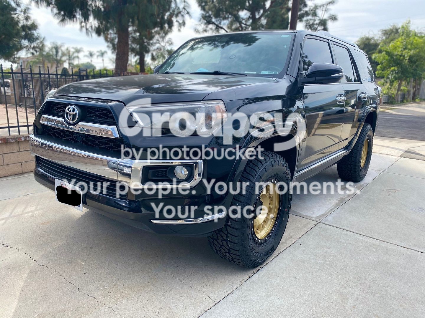

Update on the stage 1 kit, when I installed the kit I did the recommended front setting at the first clip thinking it would be more than enough but added a half inch cornfed spacer to the rear to get 1.5" in the rear but ended up with 2" instead. That resulted in a factory looking rake but lifted and wish I had done the second clip instead. I waited a few weeks to see if the rear would settle and it stayed the same. I was preparing for bigger tires from 265's so when I went to a shop to have my bmc done and I also had them change the clip setting. I had the second clip in mind but they encouraged the third clip instead as a buy once cry once and said f*** it let's do it (thanks stellar built) and I was also going to upgrade UCA's anyway. Long story short, the rig looked exactly how I envisioned it when I first installed the lift after changing it to the third clip. Factory looking rake is gone and is completely leveled for now until I start adding weight to the front.
371196d1603653005-eibach-pro-truck-lift-647c2f99-19f5-456c-b517-5bd7f36b938a-jpeg
This picture is deceiving because your horizon is crooked, making the front end look higher than it is. Take a look at your roof line compared to the top of the garage door behind it. It looks level with that line.
Have you measured from the center of hub to the bottom of fender on level ground? If so, what did you get?
After placing on my SCS wheels. I’ve noticed a more predominant amount of reverse rake. It’s actually kind of bother me now. I think I’m going to have to opt to get rear spacers. I’ll drive it a few more hundred miles to see if it’ll settle.
And yes you’re right. The photos don’t do justice, you have to see in person.
I’ll measure it soon when I have time

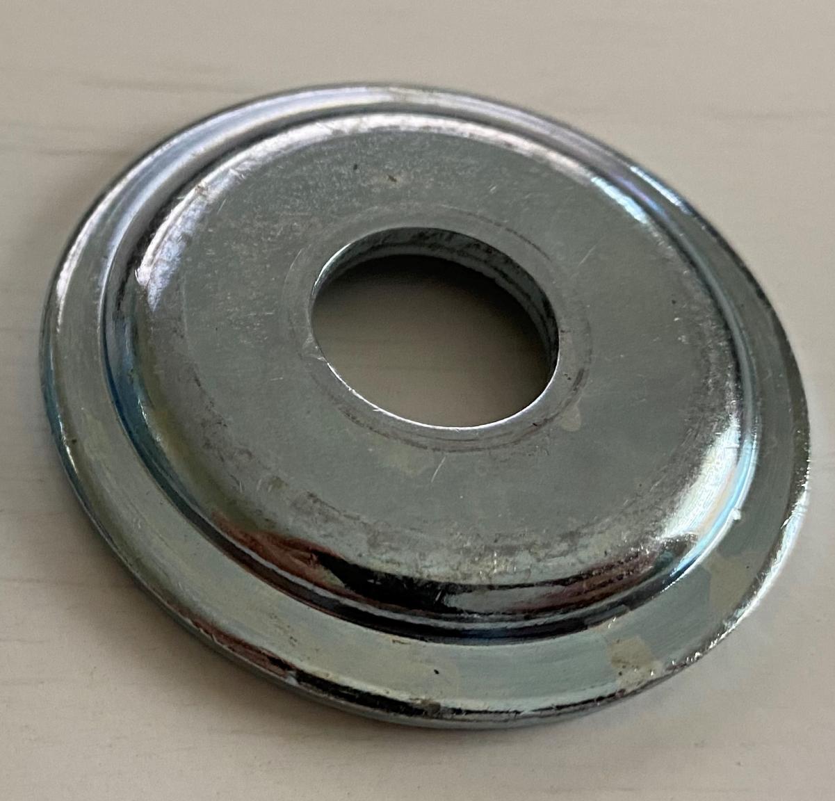

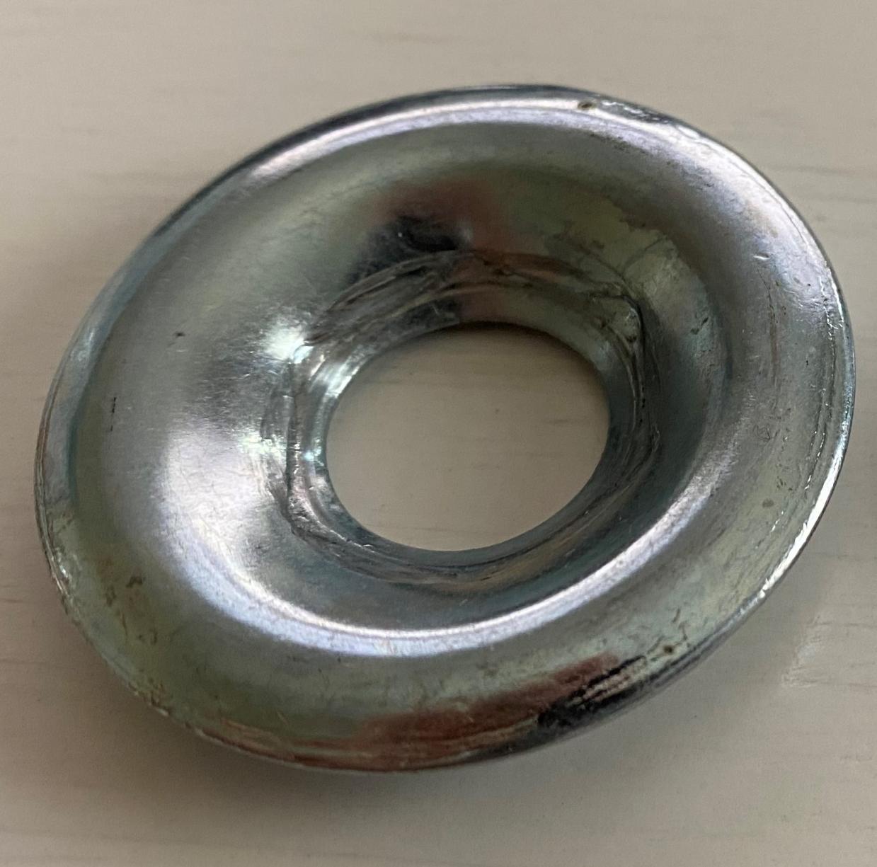

I installed the Eibach Pro Truck kit (with rear Icon 2" coils) this weekend and I'm definitely happy with the ride and overall look . During my install, I came across one issue. While tightening down the rear shock, I noticed the top washer and bushing sinking down into the frame. I undid everything and took out the washer. The (first) picture shows the shape of the washer that came assembled on the rear. I'm not sure if the wrong washer was provided or if I just deformed it by overtightening. I ended up using another washer (second picture) I found in baggy of extra parts sent but I think they were for the front struts. Can someone let me know if its possible to deformed the washer and if I'm using the correct replacement washer?
