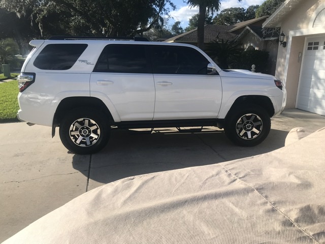

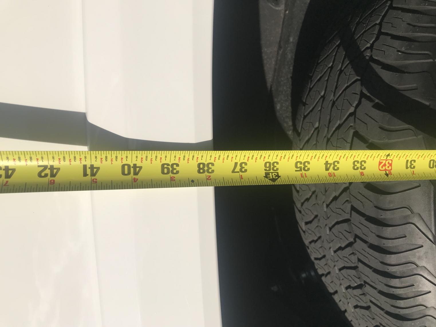

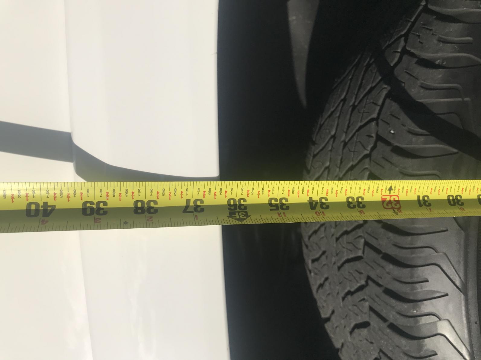

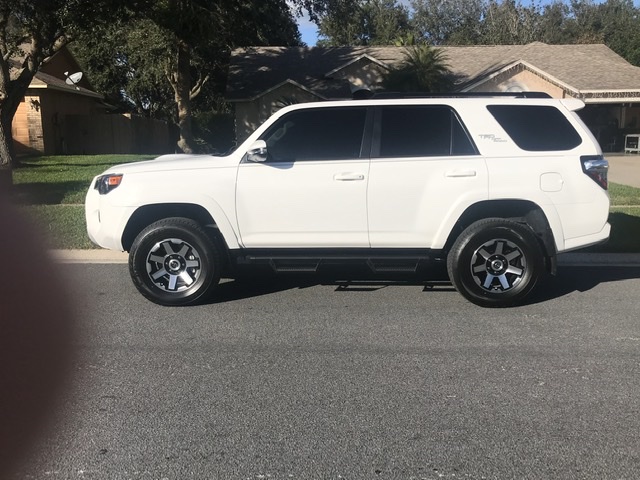

My first post... I signed up just to share my experience with you(hope its not too late)
I just wanted to level my 2021 T4R ORP. Period.
(Still working on my next step by reading a million more posts)
I've read this entire thread trying to find an answer to MY issue.
MY issue is that i did not lose the rake. (Which solidifies the statement that all T4R's are different)
I measured the front and rear on both sides several times in different locations and got different results every time... so i'm not comparing where it started and where it ended...I'm also not addressing the "lean" because it complicates those same measurements(that are all over the place). The "lean" does not bother me at all... but it is 100% there. Believe it.
So.. FYI..
I bought my kit preassembled (on the first perch). Installed it myself and was thinking i MUST have done something wrong. I removed the components entirely and re-installed. Same result.
I can't tell you about the ride quality change or anything else... to me.. its a truck. Drives like a truck. (My other car is a Mustang with a track suspension)
Ive got 3000 miles on the truck...2000miles on the suspension kit.. no issues with the TSS.
I have pics of the measurements from the ground(these are the average measurements shown on the tape measure) and pics of the stance with factory wheels/tires(showing how much different it can look from the camera angle and where its parked)
Good luck with your information search. I would suggest starting one perch up from the bottom.... from my experience.

FYI,
I understand the confusion. My apologies for "muddy-ing" up the water and adding this post.
I WAS planning to remove the shocks today and raise it up to the second perch BUT my friend suggested I put a level on the step bars...and/or the roof rack rails.
That gave me an ENTIRELY different perspective.
Both locations are VERY close to level. (4' level)
As a matter of fact, the air bubble is slightly leaning more towards the line that would make it a reverse rake.
