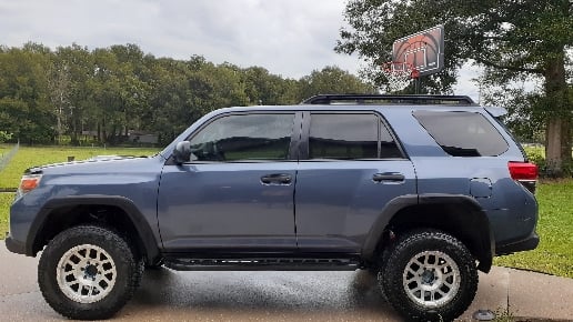

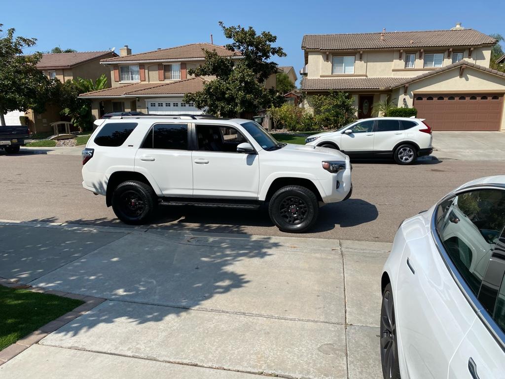

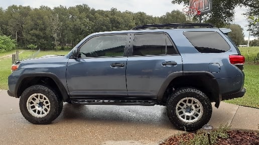

FWIW
These two photos were taken within 5 seconds of each other. Goes to show our cell phones and photography skills can really effect our rake.
Sent from my SM-A205U using Tapatalk
FWIW
the rake in those photos looks identical to me. also, I'm pretty sure most folks are measuring in real life but posting photos for discussion reference.

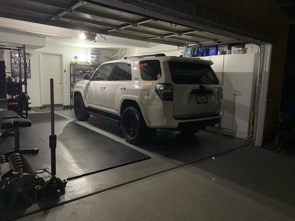

Here’s my lift. Not gonna lie... there is a slight reverse rake... but I’m not terribly OCD, and it doesn’t really bother me
371196d1603653005-eibach-pro-truck-lift-647c2f99-19f5-456c-b517-5bd7f36b938a-jpeg
This picture is deceiving because your horizon is crooked, making the front end look higher than it is. Take a look at your roof line compared to the top of the garage door behind it. It looks level with that line.
Have you measured from the center of hub to the bottom of fender on level ground? If so, what did you get?
