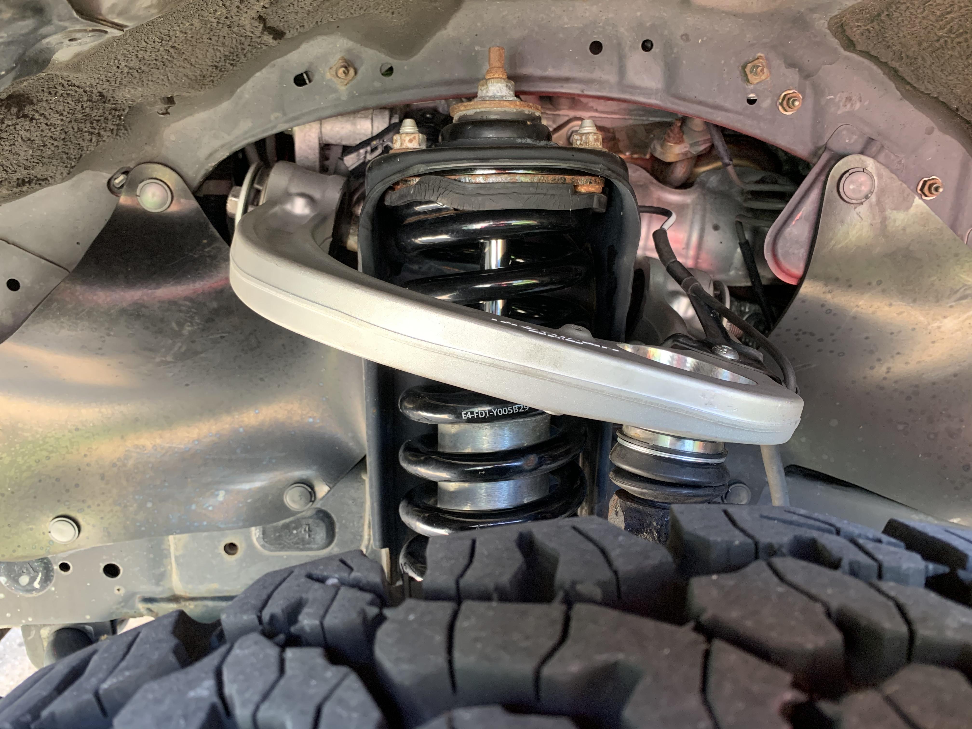

I really like the Ironman pro forge uca. I’m running 2.25” of lift and got 4.7 caster. Drives so nice on the highway.
Do you have tophats installed on them. Taking a wild guess, whoever installed the tophat damaged the finish on the spring.
That is not normal wear from packaging. It looks as though it was dropped or damaged during the top-hat install.
I would suggest reaching back out, or if you don't care to wait, you can put some vehicle touch-up paint or even some nail polish to re-seal the area.
Our system of powder coating (multi-step) is designed to help protect from excessive corrosion spread under the coating if there is damage. That being said, it should still be sealed.
I reached out to the seller and was a little confused at the response I received. They states the coating flaking off was not "abnormal". They states it most likely was damaged during shipping. They further state that because the top hats came installed the manufacture (Eibach) says they cannot be returned or exchanged.

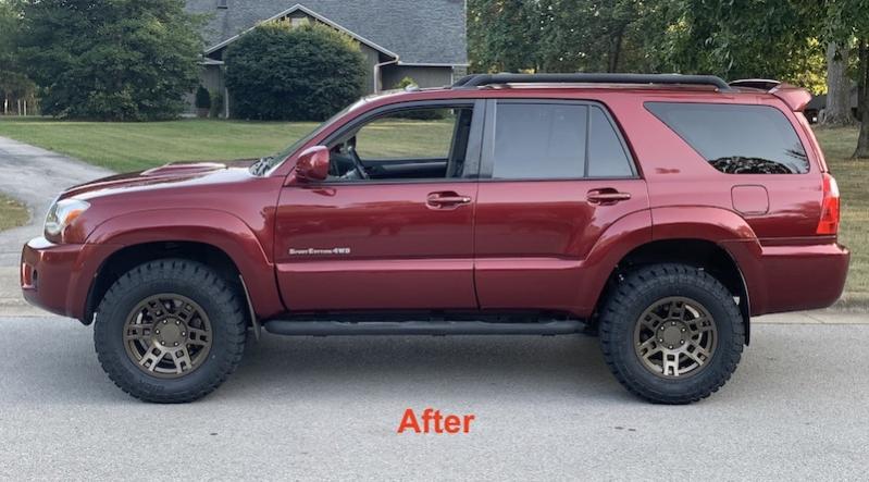

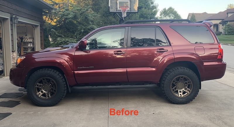

In recently installed the PRO-TRUCK LIFT SYSTEM (Stage 1) on my '08 Sport and have been happy with it. I installed the lift on the 1st (lowest) perch and thought that would eliminate the factory rake. The lift still looks good, I just need to determine if it's worth the work to un-install the front struts to change to the 2nd perch to balance things out a bit more.
Front: 21" from center hub to top of wheel well
Rear: 22.25" from center hub to top of wheel well
