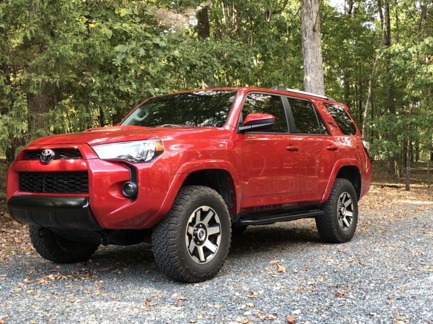

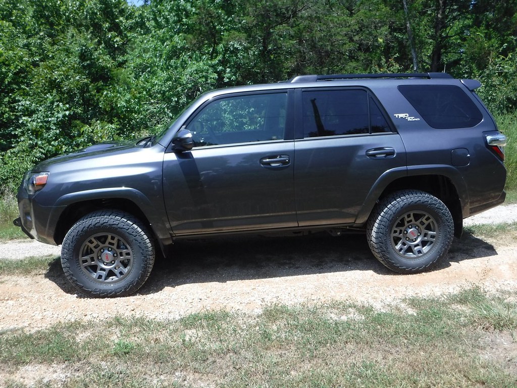

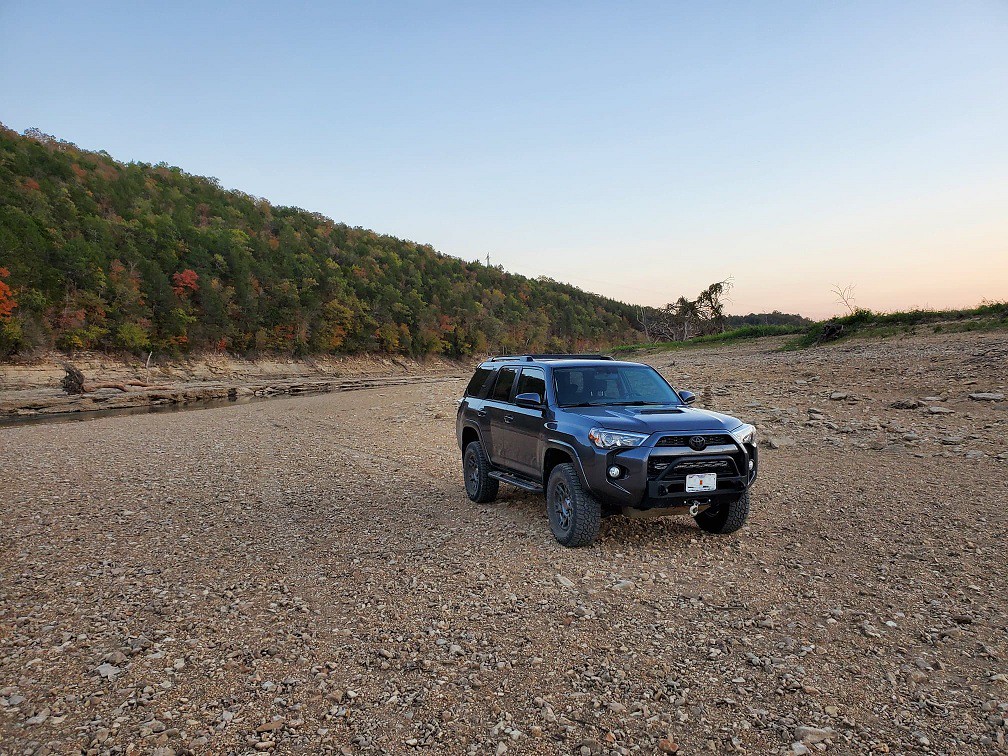

My 1st mods other than stock size Falken Wildpeak AT3W's were a TRD skid plate, Warn Winch and Warn Bumper to my non-KDSS Off Road.
My Eibach lift was installed on the lowest clip setting back in July of 2019.
Home from the dealer:
200lbs of Warn winch with steel cable and Warn Bumper - note the sag.
Eibach Pro Truck Lift installed on lowest clip.
How it sits 1 year and 5 months later with the addition of HEAVY Shrockworks steel armor (sliders and skids).
The ride is fantastic on and off road.

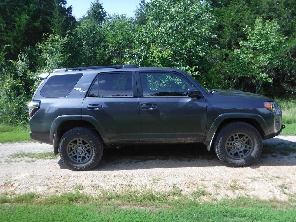

I actually just did this with mine... didn't want a big lift but just to level the truck, so only replaced the shocks and used the 1.6" perch. Based on eyeball measurements, it's very slightly forward raked (I have sliders and a front skid installed). Next time I park somewhere level I can snap some photos. I really like it though.
This is with factory springs and front shocks at 1.6. The rear has the 4th gen spring for 3/4”.
