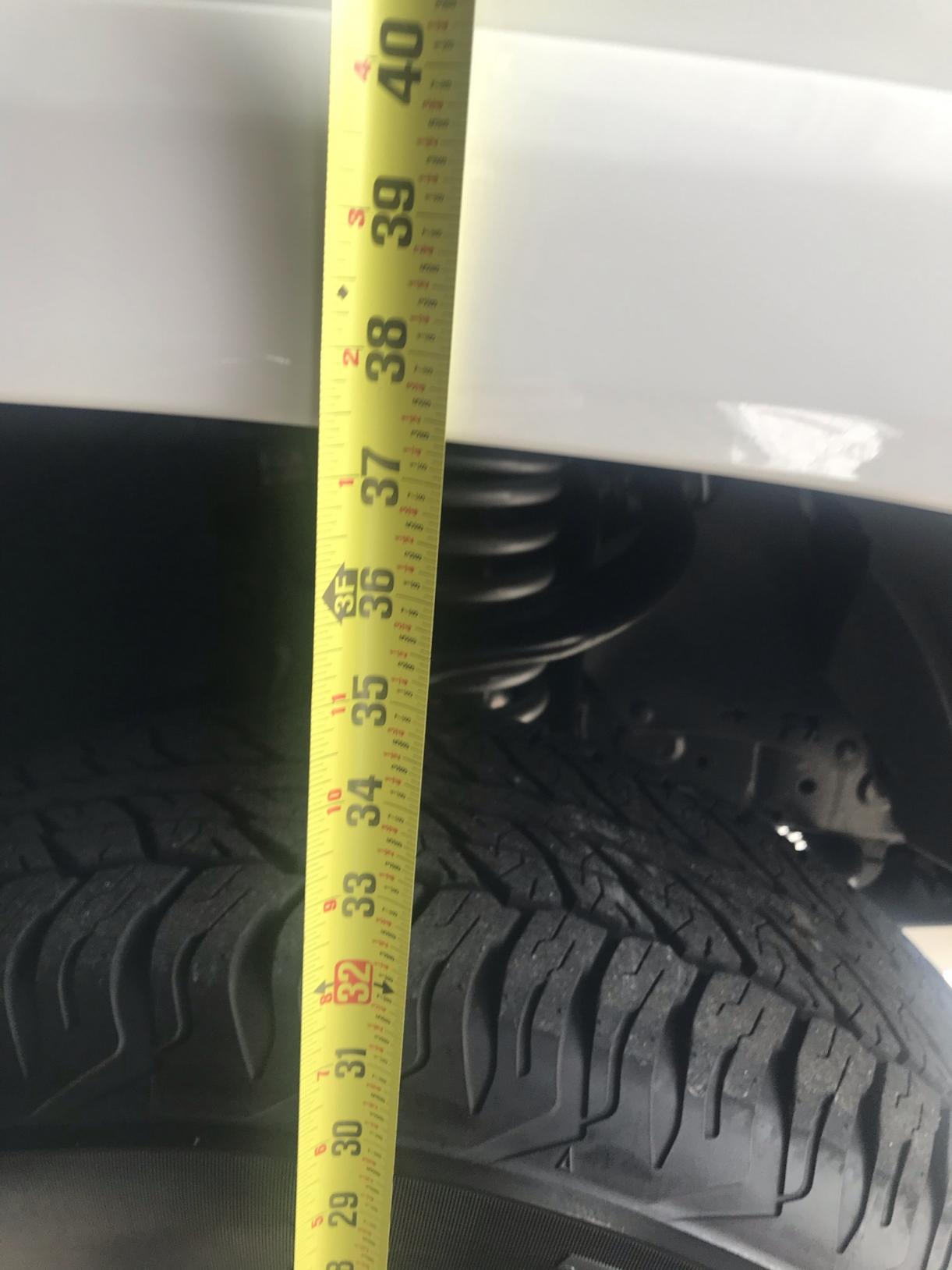

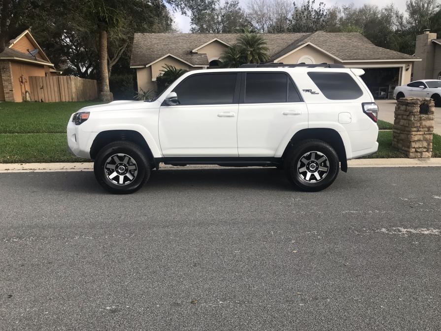

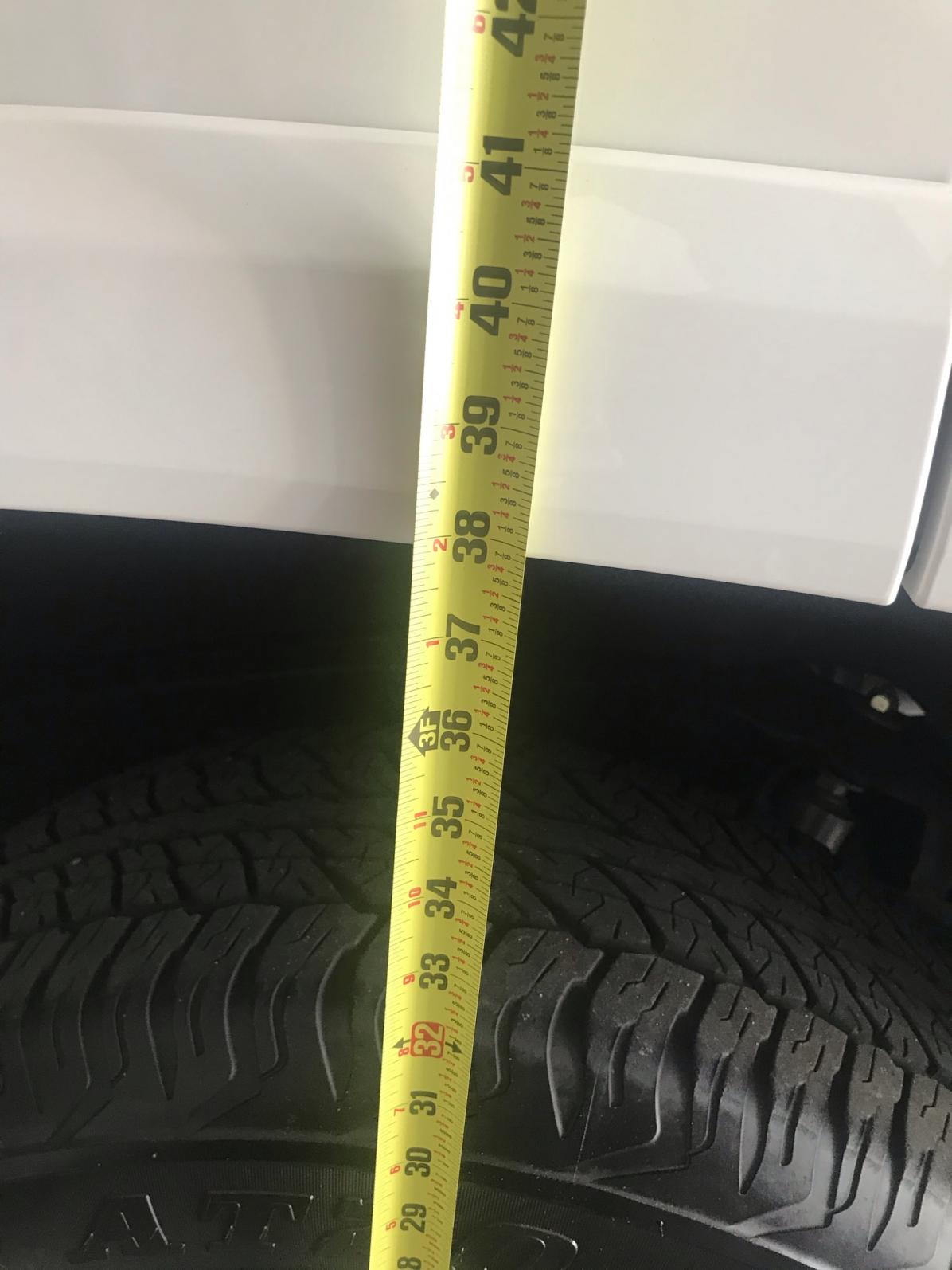

After tons of research, I've noticed that most photos, if not nearly all, are taken very soon after install, which is understandable because of the excitement. Anyone have any photos (or measurements) after some miles and settling?
I'm most curious because years ago, I installed a lift on a jeep, and the rear looked way higher than the front (not expecting that from this kit), but let me tell you, it did not settle one bit.
Good point. In my experience Eibach springs are spot on from the time of install. I assume my 6112 springs (I have had both the standard and the 650) are both made by Eibach as is my rear 1" spring. All three provided lift expected for the weight and none of the three sets had to settle, at least not more than 1/8, nothing that can be easily measured.
By contrast, I tried a Dobinsons front spring which was also excellent but did experience big time settling within the first 50-80 miles.

FYI:
See post #2110. I took that photo 2000 miles after install of the complete Eibach Kit.
Eibach Pro-Truck Lift System (Stage 1) for 2010+ 4Runner (E80-82-071-01-22)
Yesterday, I decided to raise up one perch. I used the no spring compressor method to remove/replace the shocks from the truck. Super easy. The first side took 2 hours- being very cautious... the next side took 30 minutes. (Had i known how simple that was, i never would have had the fronts pre-assembled)
These pics are at 3800 miles after initial install(one day after raising the front perch)
Pics attached.
Depending on where i park it... it appears to be level or even a slight forward rake...
I like the "look" of this setting, however, putting a level on the sliders... there is a slight negative rake.
