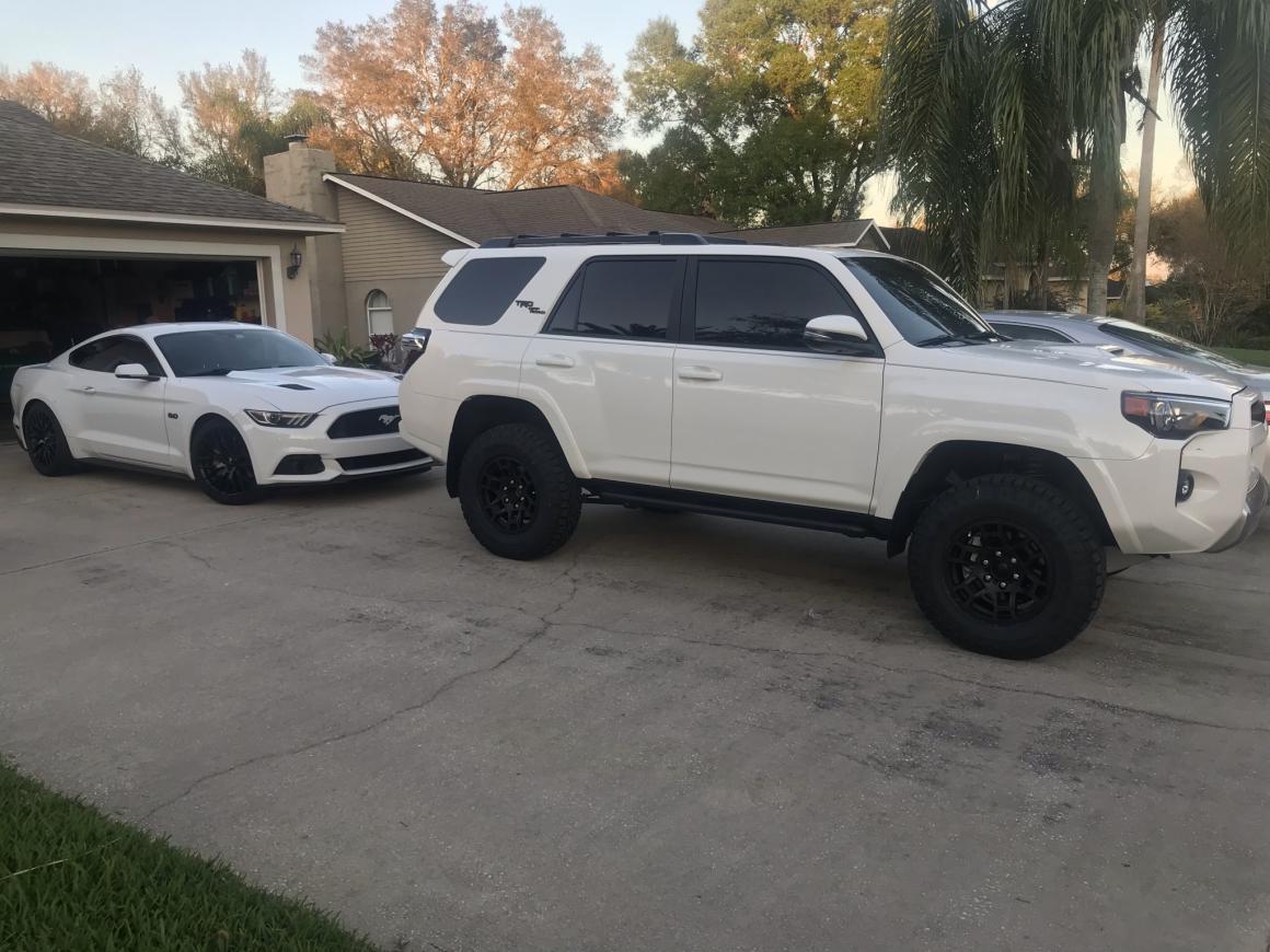

Pictures.
Post #2110 i was on the bottom perch
Post #2173 i was on the second perch up.
Just sayin.
I just changed wheels/tires and am still on the second perch up.

That’s what I want it to be like thank you. Are your running stock UCAs? If so problem with alignment?
I am running stock UCA's.
The tech at Firestone said there was no problem with the alignment(that was with the OEM 265/70/17 on a 17x7.5 wheel)
I just put the 255/75/17's on with a 17x7 wheel... and to be honest, don't know if i should have it aligned again or not.

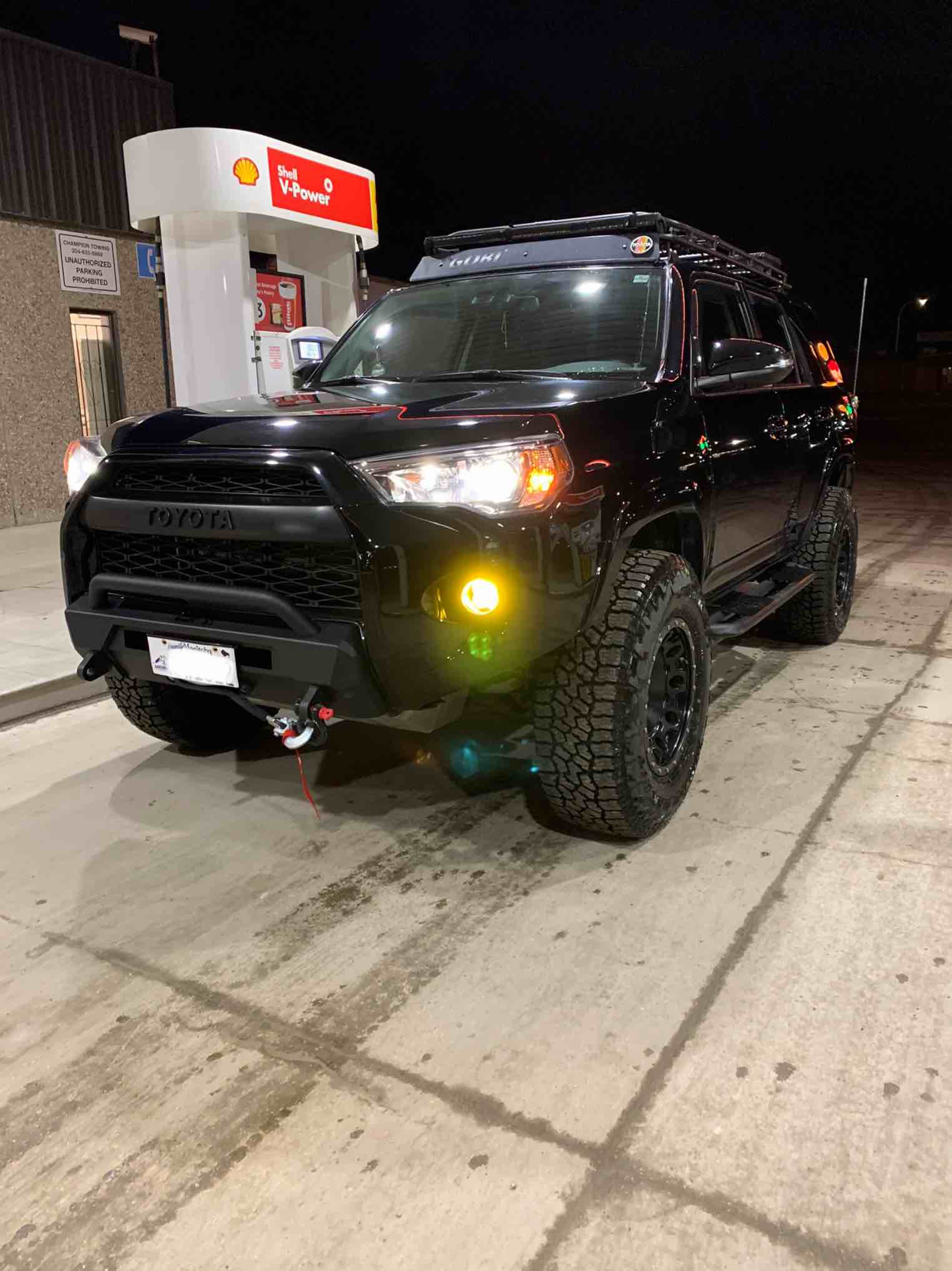

I’m on the 1st perch but I’m looking to move it up to the 2nd perch to minimize rubbing I’m experiencing.
