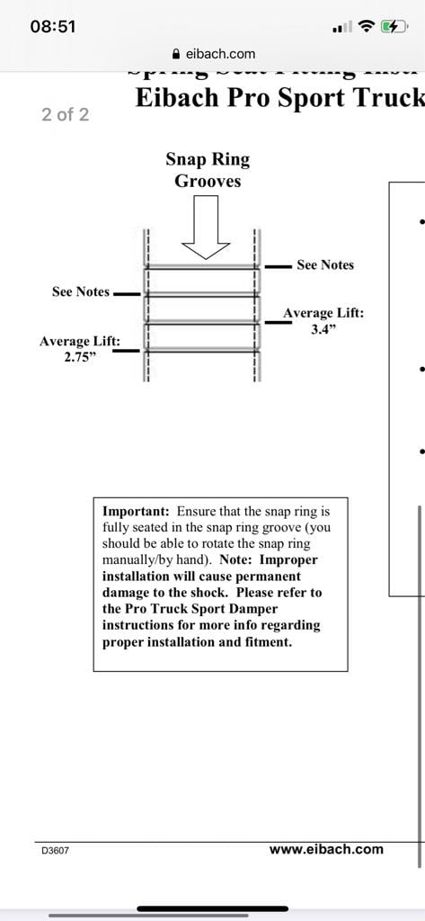

I had the same assumption, bottom clip to eliminate factory rake. I called Eibach and spoke to an engineer, he explained that I should probably use the second clip to eliminate factory rake and the third if you have added weight up front.
When and who did you speak to at Eibach? I called them 2 weeks ago and got this response...
When I spoke with Eibach they said a lot of folks with no added weight choose to place it on the 2nd clip right from the start and are very happy with the height. I on the other hand have an extra 220#going up front and said I will definitely need to be on the 2nd clip anyway. I asked, will I need to go to the 3rd clip because I want to sit right at 3"with all the weight, he said it will sit at about 2.9"with that weight on the 2nd clip.... If I go to the third it will effect the handling to much.

This is rough, but if you take the 220 / 2 you get load per corner. Then take the 90 / 4 you get 22.5 roof rack per corner. SO your total added weight to each front spring is 132.5.
If your spring is 650lbin. it takes 650lb to compress the spring 1 inch. Now divide 650 by 132.5 and you get 0.2, so approximately 1/4" compression at the spring. I don't have the motion ratio in front of me though, so its hard to say what that looks like at the fender well.

As long as the shock at rest is not in the top-out zone then ride comfort should not be effected. We designed the damper to function within the 2.75" height range so provided you are around that range at static you'll retain the same amount of up and down travel. If anything, the additional weight will make it slightly more compliant then rigs with no weight on the front.
