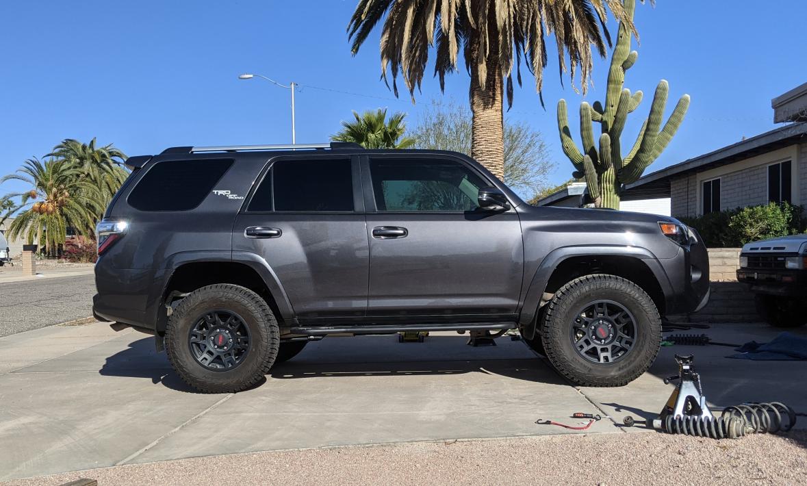

Just installed. Bottom perch. KDSS truck. 285s. No extra weight. Initial measurements put it right around 1.5" rear and 2.5-2.75 front. Hardly notice the .25" lean. I'll check again in a few days after alignment and settle. Looks pretty level to me. Hope to get some dirt on it Sunday and see how it feels.

Looks awesome and might have just sold me on this kit!
How is the rubbing with your set-up? Stock UCA's I am assuming?

Stock UCAs. Zero rub. I had the 285s on for about a month now. I did the bumper trim/liner push before I installed them. With the mud flaps removed there was zero rub. I put the flaps back on and zip tied them back to the body mount bolts and it would rub a little bit turning in reverse or if I hit a bump while turning. With the lift installed I can't make it rub at all. Tires are Pirelli Scorpion AT+. I assume most of the people with rub are running neg offset wheels or spacers.

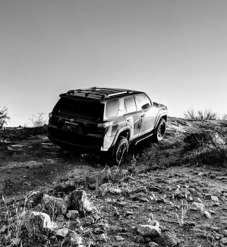

No diff drop. Took the kids camping last night. Several miles of bumpy dirt road to get out to my area, and then some decent chunk to get down into my favorite campsite. Didn't notice a huge difference on pavement (KDSS truck, so it was already stiff) but huge difference on the chattery trail. That road normally knocks my fillings out, but it was significantly smoother with the Eibach kit. I was probably going 10mph faster than usual and it felt great. Was also nice to walk through the chunky spots I use to scrape skids on with no issue. That little extra clearance makes a difference. Super happy with the kit. Super happy I sucked it up and installed it myself. Just ordered a roof rack with the money I saved.
