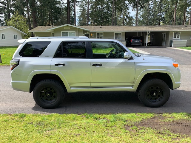

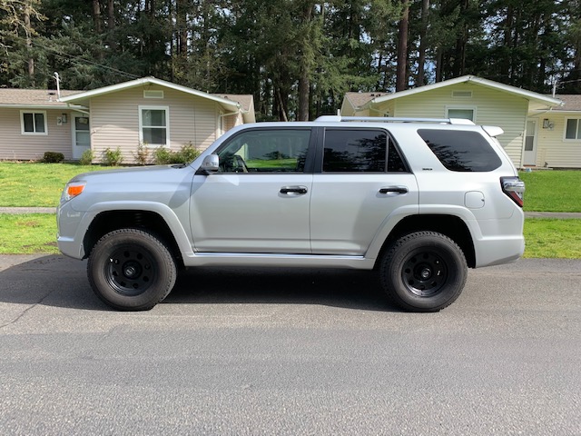

I know I have owed some pics for a long time. Washington weather has not been friendly for pictures. When it has been nice I have been in the field training. So I apologize. Wednesday will be sunny all day (so the weatherman says) so if you want more pics or pics of something specific. Let me know. Ok so here's my set up. I have the kit set on the second from the bottom. No additional weight as of yet. Easter helped when momma had trouble getting in.... here come the rock sliders. Back on topic. Additionally I have the JBA UCA and a 1/4" spacer on the driver side for the lean. I have the sway and diff drop. I really don't think I needed it the angles weren't to excessive and the sway never made contact. So It might have been needed it might not I couldn't tell you exactly but they are on and I have had no issues.
The ride... Everyone likes the ride of the kit hands down its wonderful. Since moving it up to the second setting. I would say that initially I felt something maybe a little stiffer/firmer. I would not go on to saying that I can really even differentiate what it is from before to now. So those worried about ride quality that shouldn't be a factor honestly. Maybe a 10-20% difference. Personally I like it just as I did before its just higher with more ground clearance.
Now the part everyone wants to know.
Initial Measurements (at 52,000 miles)
FL-19 FR-19.25
RL-20 RR-21.25
Kit Install (Recommended Setting/immediately after install)
FL-22 FR-22.5
RL-21.25 RR-22.25 (gas tank level may have played into this)
Second Setting with 1/4" spacer for lean
FL-23.25 FR-23 3/8 (there is an 1/8 difference but that could also be measuring variance and possible lean)
RL-22 RR-22 (I didn't gain actual height the angle is different.)
Now do i think I achieved 4.25" of lift no. The shocks were probably worn out, I might not have been on perfectly level ground, ect. There could have been a number of things that caused those numbers. Use your best judgement when you go to the second setting.
I love this kit. I love the versitility of it, the ride and the quality. Now if Ryan from Eibach would just send me the rear adjustable set up to test, life would be sweet.
To all that have sent me PM's with questions I hope this helps, I hope I've been helpful.
