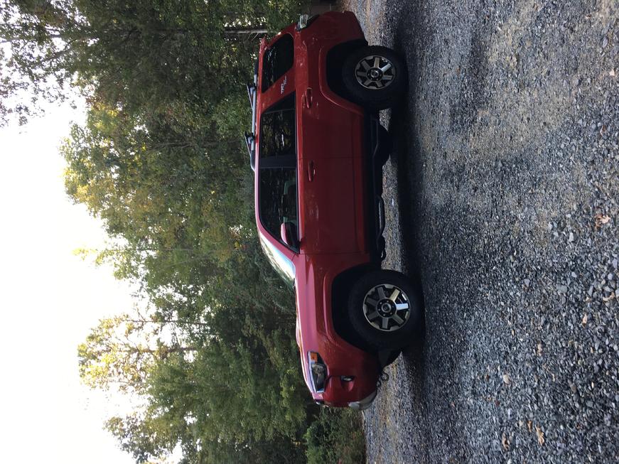

I finally had time to install my eibach parts. Install was easier than I expected. I netted a little less than 2” in the front on stock springs and eibachs at 1.6. Hopefully it will settle a little. I got just under 1” in the rear with the 4th gen springs and shocks. Overall I’m very pleased.

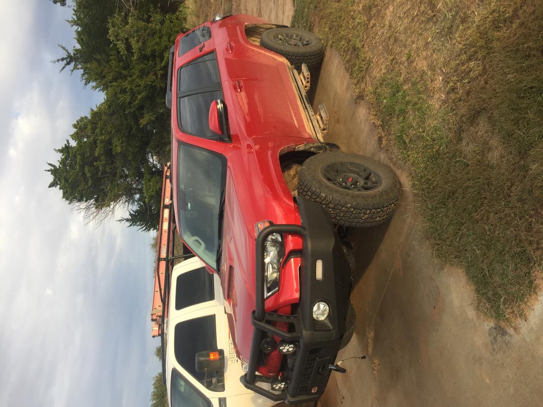

Had the full kit for a month or so fronts set at 2nd groove from bottom because of ARB Summit bumper and winch. Ride much better, lot less front end dive and roll I can push it thru corners now. Feels like a truck now not a sissy SUV should also give better performance if I use it to pull boat. Shocks do a great job and are valved for the 4Runner. Mine sets pretty level.

Did you use the factory springs or the eibach ones? I would have perfered new springs but I was trying to stay under 2” in the front. I was also concerned with creating lean in the front. I know my factory drivers spring is different.
Went with the full Eibach kit.
