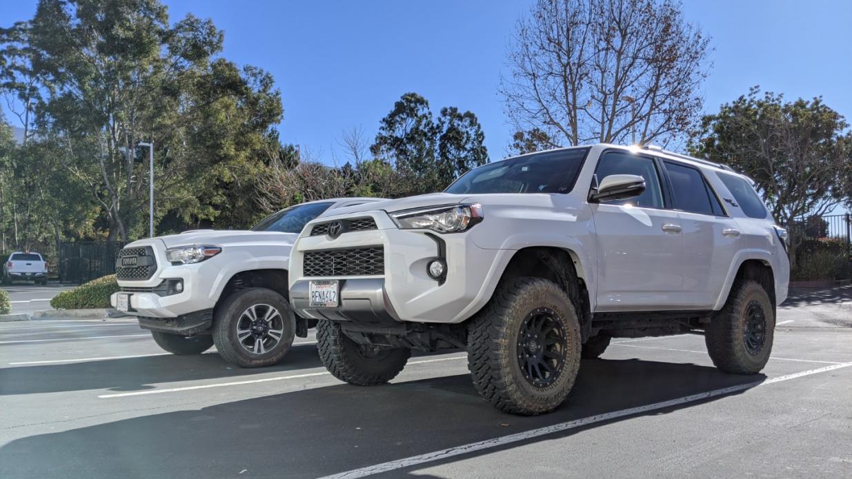

Test day!
How would you guys feel about 2.0 front coilovers paired with rear resi-shocks?
