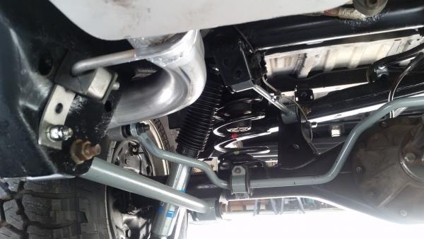

So I have absolutely no issues with the bumper, its beautiful. My problem came when I went to have the exhaust run. My muffler guy was cussing up a storm and he finally decided to dump it out the side ahead of the rear tire. He said take it somewhere else lol. Any body else have any exhaust drama? It looks tight in there for sure but certainly doable. He really yelled at me when I offered to get him a length of the flexible dryer vent style exhaust pipe from Advanced Auto.
His issue was that the pipe would interfere with the sway bar link as it cycles through its range of motion.

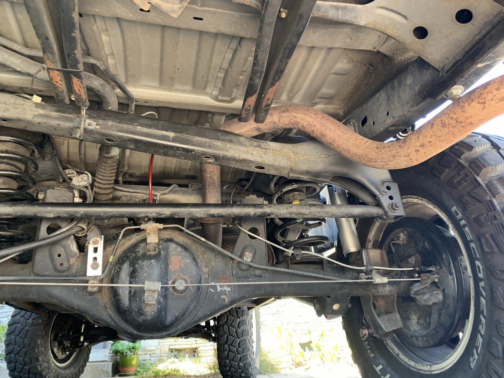

Sounds like maybe he was trying to run it under the frame instead of over the frame? Do you have a 1” body lift version or non body lift version? Did you build the bumper or have a shop do it?

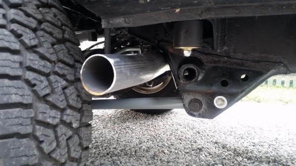

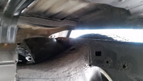

Sorry it took so long to get back to this. I do have the 1" body lift and built the bumper myself. I did relocate the tank and I did not cut the pinch weld over the frame. Muffler guy told me not to bother. This guy builds race cars etc and knows how to use a pipe bender. I think he just flat out didn't want to do it and so he just hacked my truck up. I have some pictures in my build album I'll try and post here.
I also took it to another guy with a bender and he was hem hawing about it not being possible with 2.25 pipe and that it would have to be a two piece.
I really love how he put a bolt through my lower control arm mount and has the muffler resting on the frame so it vibrates.
I'm guessing you know what your exhaust use to look like when it was routed in the stock location - but maybe it would be better to just have the muffler turn down and terminate right after the muffler instead of trying to route it through the circular hole in the eimkeith bumper? just a suggestion.

Yes I would much rather have had it turn down instead of stick out the side a half a mile. Not sure if that would allow gasses into the cab at all.... It's just hard to find any body that gives a sh@! about quality work. But hey on the bright side he did paint his welds lol.

Looks like plenty of room to me.
Keep in mind that the body and frame do move a lot in comparison to each other, as does the exhaust to either. You'd want at least 1/2" on all sides, and probably more unless you want a fair amount of clanging, etc. The exhaust grows as much as 1/2" over its length when hot, which adds to the challenge.
