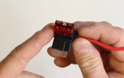

You add a fuse is not properly installed. That’s why your 5amp fuse blew with the wipers. You probably just placed the fuses in the wrong spot. You also have to have the right orientation or you can find yourself bypassing the fuses all together and that’s not good. Make sure u follow the directions with the add a fuse.

Ok thanks!! So like the picture i put the lowest fuse first and the 30 wiper one on top. But if i understand you they have like a good side? Like a positive and negative side as an example?

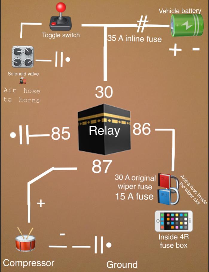

Here is a self-made diagram to help you understand for those who are more visual.

Not a positive and negative side but a line/load(protected) side.
The diagram don’t show up.
Do you have access to a voltmeter? You need to make sure u have the proper orientation for the add a fuse. If not try this. Plug the add a fuse in with no fuses, add the fuse for the new circuit(5amp fuse should go in the top one). If the relay doe not operate, flip the add a fuse around and see if that works. Once the added circuit works properly you can now add the 30amp fuse back in and double check the wipers.
No don’t have access to one but I can try what you said. For now its a 15 A fuse and no fuse blow but maybe i put it on the good side just by chance? So a 5A one on the good size will work too?

You can send me your e-mail adress in private message, i’ll send you my self-made diagram if you don’t mind.

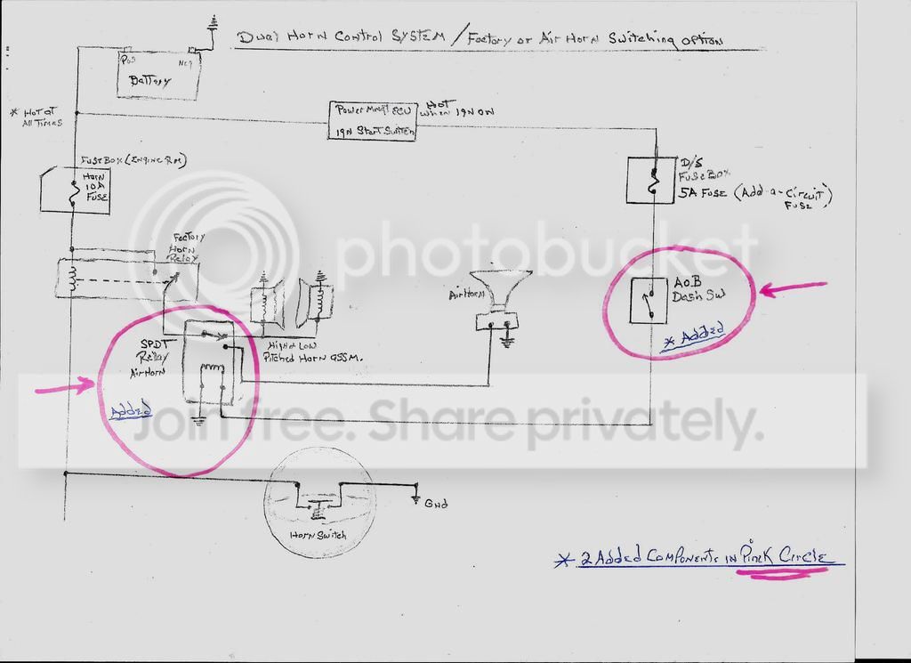

Here's a typical "Add-a-circuit fuse" Toyota ATM-Longer D/S fusebox Electrical tabs:
Hope this helps, 'Best to you',
rig

Is the new circuit fuse needs to be lower than the original one?
Also, I found a empty fuse slot with 12v ignition, can I put only one fuse in the add a fuse for the moment?
No but for the AMP. If its a 10 A fuse I can’t put a higher one for the new circuit am I right?
Hi WD_T4R,
A typical 12V relay coil consumes less than 0.5A for the switch circuit. The load-side (the contacts) are rated on the relay nomenclature tag e.g., 30A, 40A, 50A...etc, so the relay is sized accordingly, based on the current draw of the device being installed!
The added circuit ALWAYS goes adjacent to the PINK/RED wire coming off of the new fuse holder! So be sure to size that to your new circuit; leaving the only other fuse slot for the original fuse to be installed!
