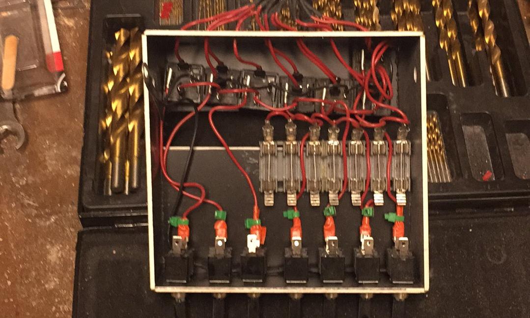

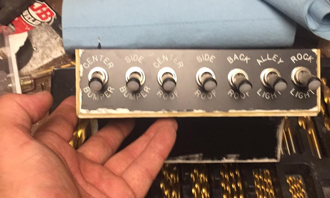

Switch box I made.
One positive in, one ground out, and wires to the lights.
