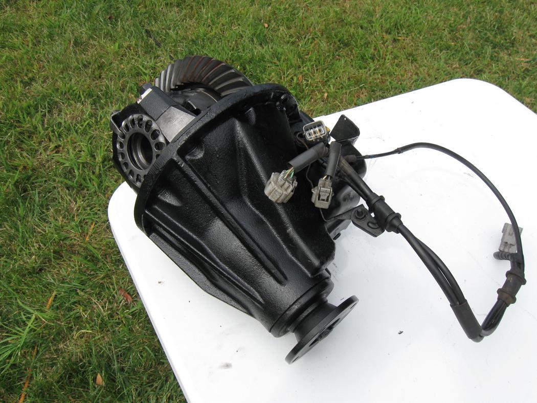

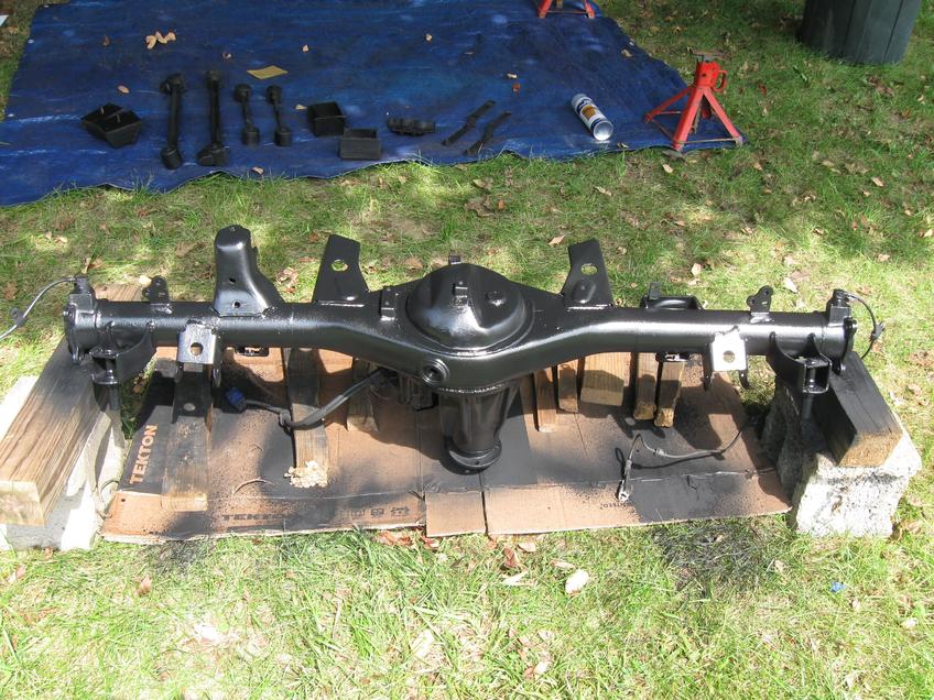

Since we're talking about members...
Here was my summer project. :boxing:
