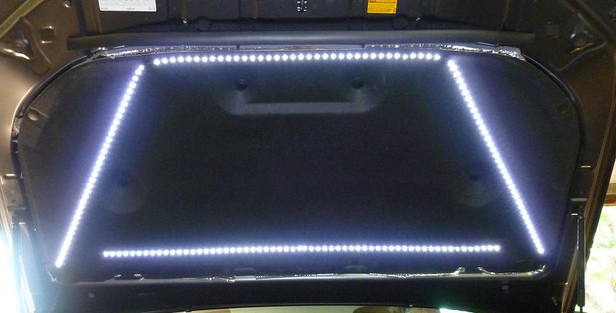

Just to give more ideas, here's my setup. Four light strips, the one by the cowling (bottom of pic) is a 3', the other 3 are 2'. They are cable tied to the hood liner. I'm adding a pin switch under the hood near the driver's side hood strut using a custom bracket. Right now it's 'hot wired' with clips for when I need it.

Holy Cow, that looks like a starship.

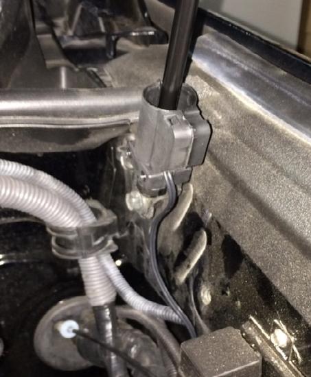

I decided to do something similar but using a LED Strip and a Door Prop Switch for my trigger instead of a toggle under the hood or a switch inside.
EDITED: (Removed the Mercury Switch)
Bought a strip from VLEDS.COM /Description:
White 6K Strip Light Striplight 3 Chip 36 LED 24 Inch
Door Prop Switch from Totally Wired
Switch Panels/Switches : Door Prop Switch
= $14.95 to the door
Set everything up, tested and started the install.
Hope this helps someone!
Test Fitting:
Door Prop Switch
Still Testing
Wires Loomed and Routed
Mini Fuse Holder Shown, Tucked after Photo

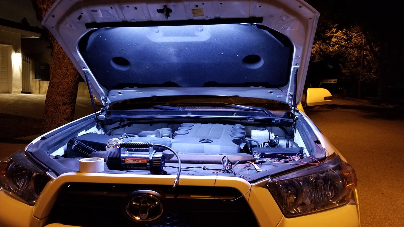

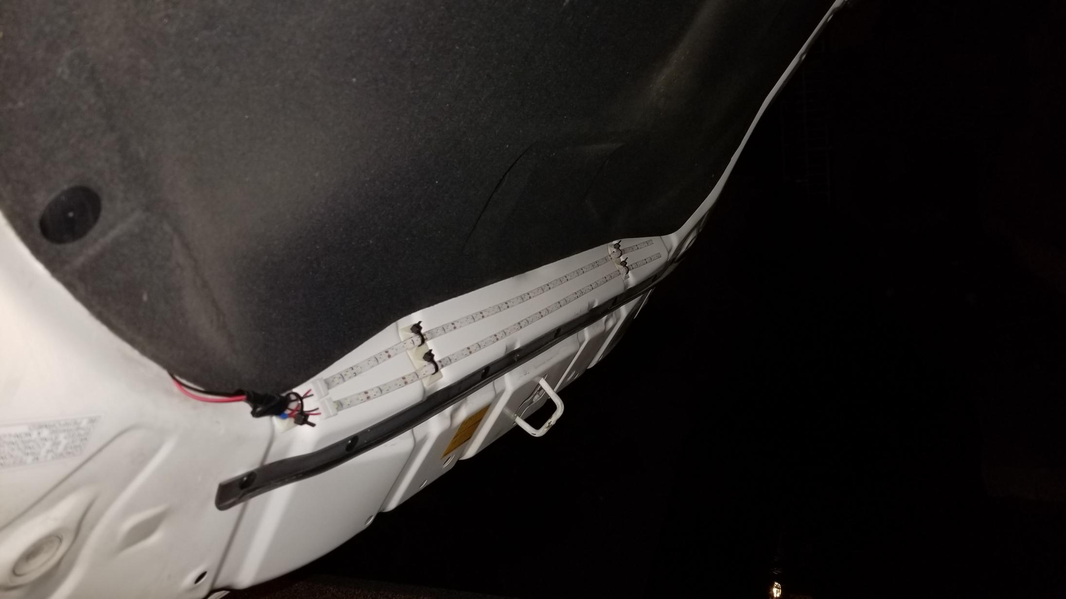

Testing my underhood lights. I wanted a lot of light, but did not want any LEDs facing me and affecting night vision. Therefore, I used double strips of LEDs controlled by a toggle. Tried to keep things functional.

Looks great.
This is precisely what I am wanting to do also. Can you kindly share your source for parts and brief install instructions? Thanks in advance!

Pictures to follow, but here are the installation instructions:
1) Measure the length of LED strips you want. I went with the maximum length that the 4Runner hood allows in one strip, which is about 45 LEDs. I cut 2 of these(you should have 2 Reds and 2 black wires at this time) and connected them both using the LED clips on one end, and on the other end crimped both red wires together and black wires together. I connected this to the long strip of 18g wire to make one red one and one black wire.
2) Run these through the hood down to the left of the T4R and loosely place cable ties accordingly where you see fit. I used a fish wire taped to the LED wires. This is kind of tricky.
3) Place the cable tie mounts on the depressed sections of your hood(two of them should fit perfectly) and then and secure cure a cable tie through each of them. Lightly tighten it. You will run the LED strips through the loops of cable ties. You need to do this otherwise the weight of the lights will eventually detach itself. The depressed sections also have no backing for the 3M adhesive.
4) Find a suitable place to mount your switch. I used a step drill in one of the panel clip holes to mount the switch more securely.
5) Connect your switch power prong to the fuse block(or battery + directly if you don't have a fuse)
Connect accessory power prong to the red wire from the LEDs. The grounds both can be attached to the battery NEG terminal or another ground on the frame.
6) Test your lights with the switch(will work whether or not the car is on).
7) Final step is carefully removing the 3M adhesive and sticking the LEDs on to your hood! Use the cable mounts as a straightedge guide for the length of the hood.
