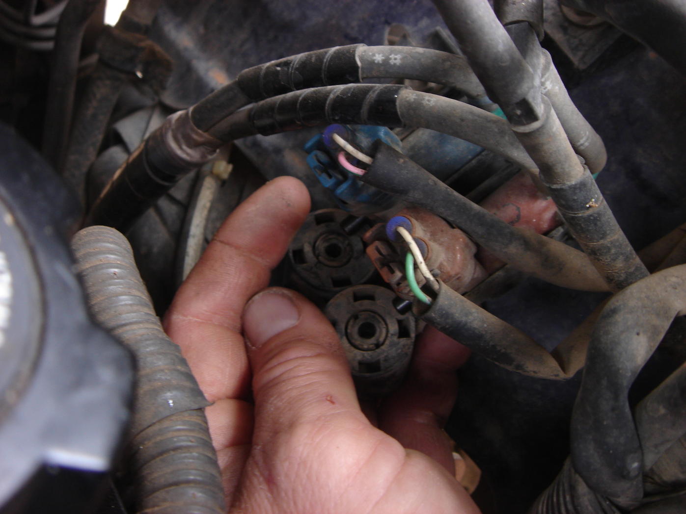

I discovered these two caps loose right below the fuse/relay box. They appear to be caps for the two tubes with red and blue connectors. What are they for? Could they be my gremlin?

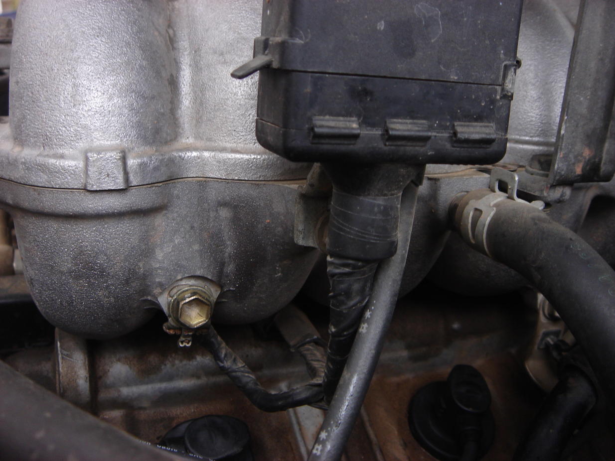

The ground strap is right below the diagnostic, screwed onto the intake manifold, almost right above the oil dipstick.
i see the ground screw now, below the diagnosis port. nothing wrong there.
