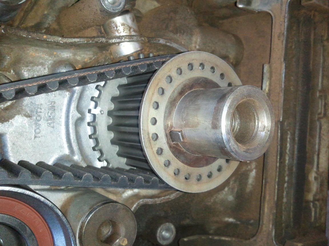

engine starts, immediate stall after timing belt job
hmm ... i don't want to seem pessimistic, but i don't see how the broken tooth or the chip broken off the pulley would stop it from running.
I think that the purpose of the teeth is to provide crankshaft position info to the crankshaft position sensor. It is the tone ring for that sensor. If one of the teeth is broken, the signal from the CPS to the ECM would be momentarily incorrect. I suspect that this could have multiple symptoms ranging from engine running rough to stalling out. Maybe someone who knows for sure could comment. It is possible that the tone ring for the crankshaft could have been damaged like this if the timing pulley was levered off the shaft from behind.
I agree that the cracked harmonic balancer is likely not the cause of this issue although it could very well damage the drive belt.
Prying off the timing pulley certainly could break a tooth if not done carefully. It's been a month, but I seem to recall it coming off by hand without prying. Who knows.
My local dealership's master mechanic confirms having seen the same problem post-timing belt replacement, caused by a broken tooth on the timing pulley.

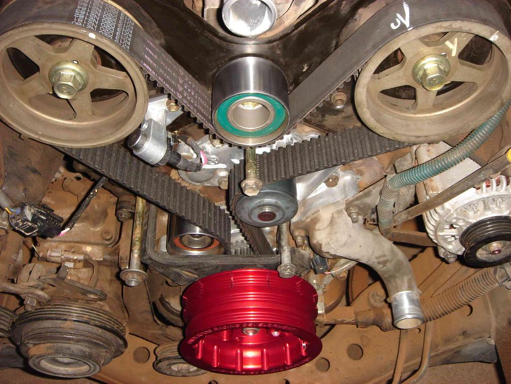

New crank timing pulley is on, belt all lined up. URD lightweight pulley should be here tomorrow!

depending on the type of tone ring, if it's bent the computer will not see the correct signature and pretty much be lost on where it is. Just saying, it doesn't have to be broken to be a problem.
Pulley is on, torqued it down and test started. Seems that was the ticket.
