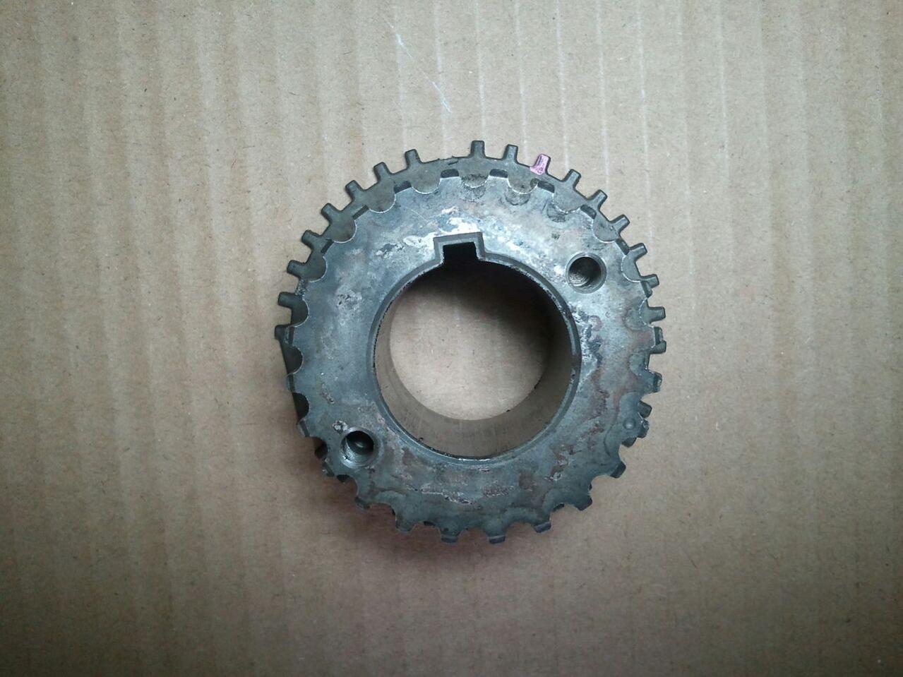

Today I finally found the time to take it all apart again. Finally found something wrong! I turned the engine over by hand to look for missing teeth on the crank timing gear, but somehow I missed this until I had it all the way apart.

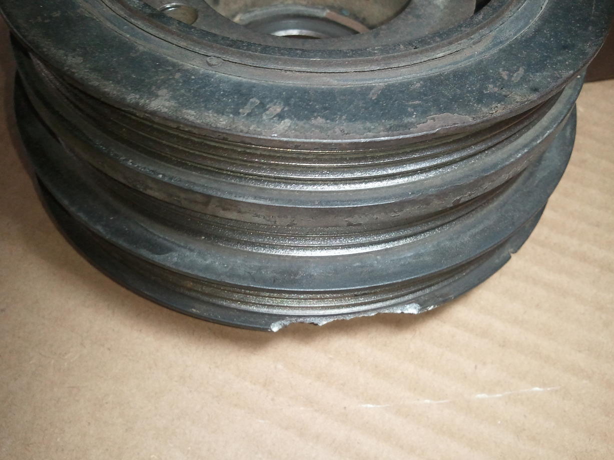

During the process of tearing it down, I dropped the crank pulley and broke a section off the outer rim. I will have to replace it now as well. I suppose I should also buy a new crankshaft pulley bolt, as they are a single use item and this one has been torqued once already. I have been looking at a lightweight crank pulley, does anybody have input on the URD Supergrip Crankshaft Pulley?

The part# for a new crank bolt is 90119-16006. It is used for all year 3rd gen 4runners now, not just 99+. The timing pulley as it is named is #13521-62031.
The URD part is NOT a replacement for the part in your picture. The URD is a Crankshaft Pulley, Part #13408‑62040, and it mounts in front of the Crankshaft Timing Pulley, with the part no. given above and that is in your picture.
I wasn't sure if you had not understood that, or if you wanted to replace the Crankshaft Pulley as well as the Crankshaft Timing Pulley.
I dropped the crank pulley, causing the damage below. Never dropped the crank timing pulley, and have no explanation for the missing tooth.
