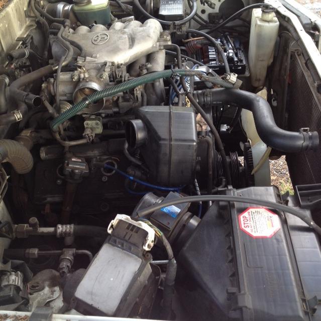

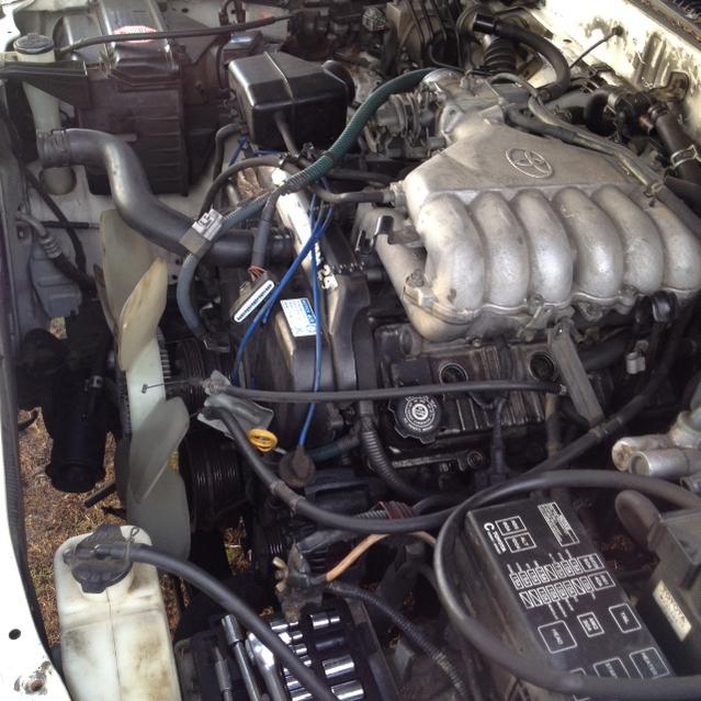

I am trying to make some progress towards successfully pulling the engine each day. I think progress is starting to slow a little.
So far I have successfully disconnected/ removed/ set aside the following items:
Radiator
power steering pump
ac compressor
detent cable
accelerator cable
throttle cable
alternator belt
A/C drive belt
power steering belt
engine undercovers
battery
some random tubes/hoses
Whats next seems more complicated but maybe I am wrong.
Things still needing to be removed (that I know of):
speedometer cable
stabilizer bar
remove driveshaft from transmission
front exhaust pipe
cross shaft
transmission rear mounting bracket
some A/C bot and wire?
Pictures attached were taken today and are marking my slow progress towards a new engine (hopefully)

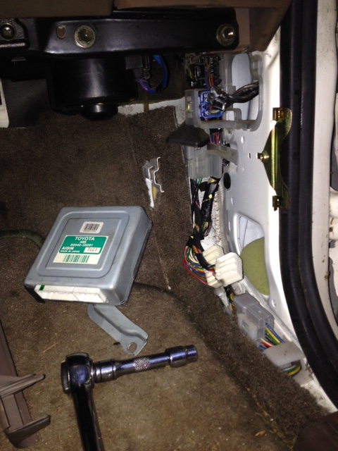

I have some specific questions on how to remove the engine harness. In the chilton guide it explains that you have to remove the cowl panel side trim, disconnect the ECU wiring, detach two connectors from the cowl wire.
Have I done that so far as shown in the attached picture?
It then says to disconnect the igniter (where is this and what does it look like?)
then detach the ground strap (Is this in the engine bay or still in the passenger side interior?)
then it says disconnect the six engine wire clamps. (again where?)
and finally pull the harness from the compartment.
Anyway, sorry for any questions that may seem obvious to the experienced but help is definitely appreciated.

Aight, I gotta go there... WTF are you doing? It's the engine. Don't pull the tranny and transfer case with it. And there is NO need to pull the wire harness with it.
yeah, disconnect all the wiring that's attached and connected directly to the engine, don't disconnect anything from inside the vehicle.
If you wouldn't mind letting us know when your truck heads to the local PicknPull there may be something salvageable.
Okay, I wont. Thanks for the advice. Is separating the tranny from the engine pretty straight forward? I have been under my truck for a while looking at it trying to figure how I could do that but am mostly just puzzled.

Yup, no need to pull the trans. I haven't pulled a 5VZE, but you should be able to disconnect the engine wiring harness at the ECU and pull it through the firewall. Then disconnect the fuel lines, clutch line if it's a manual, remove the radiator completely so it's out of the way, unbolt at the motor mounts, six or eight bolts hold the bell housing to the engine, and she's ready to come out. Support the transmission with something, a floor jack or loop a ratchet strap around the frame or whatever. Might take a little rocking back and forth to slide the motor off the transmission input (which is why you pull the radiator :D), then lift a couple pumps at a time watching carefully to see you don't snag anything on your way up and didn't forget to disconnect anything.
So you suggest keeping the Engine wiring harness with the engine as opposed to with the chassis?
I've never done a re/re of an engine, so I'll admit I'm a little ignorant as to the general practice when it comes to the engine harness.
When you buy a replacement engine, does it typically come with its wiring harness?
It's not the only way, but it's how I do it. Sometimes those little clips can be a pain, they're easier to get to with the motor out.
You won't normally get a harness with a domestic long block. I don't know about JDM motors.
