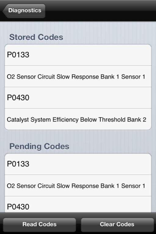

so I continue my battle with my exhaust system problems .
couple months ago I got check engine and traction control off ligets . I have scanned the codes and pop ups p0430 and p0420 . my passenger manifold was leaking so I remove it ,welded the cracks and put it back . problem exist :( i also noticed that my driver side is leaking too so I got one of these from pacesetter and just installed it yesterday wich is took me 8 hours (pain in the ass)
today check engine pop up with new codes
p0133 and p0430
what is causing the problem now ? there is no leaks at all . should I get new up stream sensors for both manifolds or should I get all four new sensors ?

I'm not familiar with the specific Pacesetter part, that's why I was asking if the OEM cat is still in place. Since you've changed it out with an aftermarket one, that might be causing the CEL. If it's a high-flow cat, it's very likely your problem. P0430 is a cat inefficiency error. Meaning, the cat isn't converting enough exhaust - very often the case with high-flow cats (it's the delta in readings between the upstream and downstream o2 sensors). I'm not sure if the T4R compares each bank to each other, but if so then that could cause a problem as well since a high-flow cat won't be converting exhaust the same as an OEM cat.
Either way, here's my suggestion: Get another Pacesetter manifold to replace the repaired OEM manifold on the other side, and put in o2 sensor spacers to reduce the readings from the downstream sensors. With high-flow cats, the spacers might give OEM-like readings.

These codes I've got
