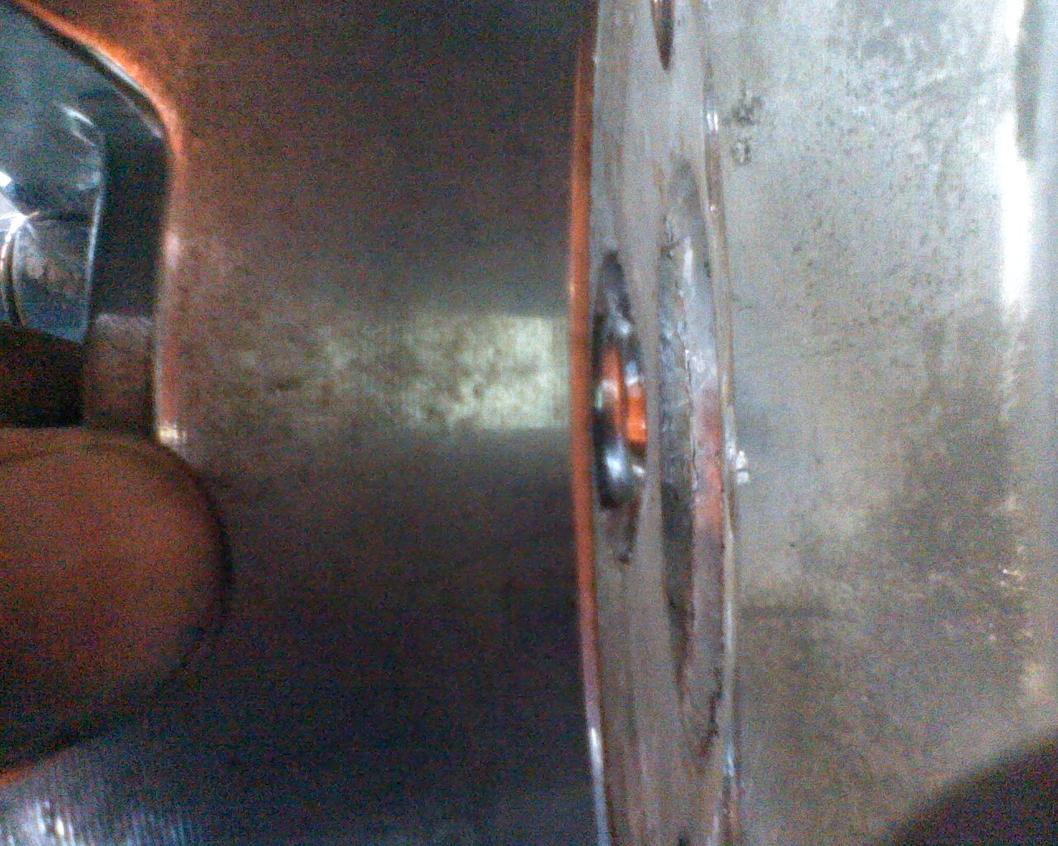

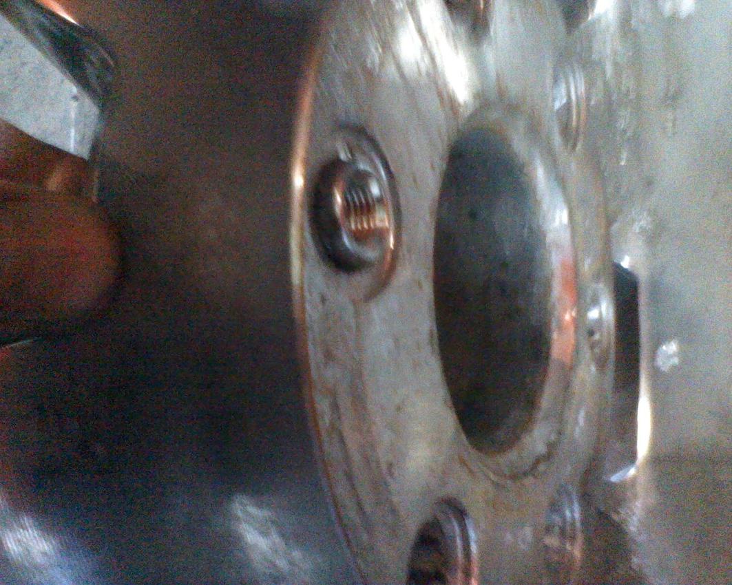

absolutely. I have encountered this first hand. on a customers vehicle. they complained it was wandering, and had a clunk.
yep, it certainly did. it was scary. I don't know who put the wheels on it, but they need to not ever work on a vehicle again.
if you get anything outside of manufacturer recommended lugnuts, make certain they match the wheels you intend to use.
as long as the lug nut does not extend beyond the mounting surface, it will work. NOT like this. bad, very bad.
sorry for the bad cell pics, its all I had..
