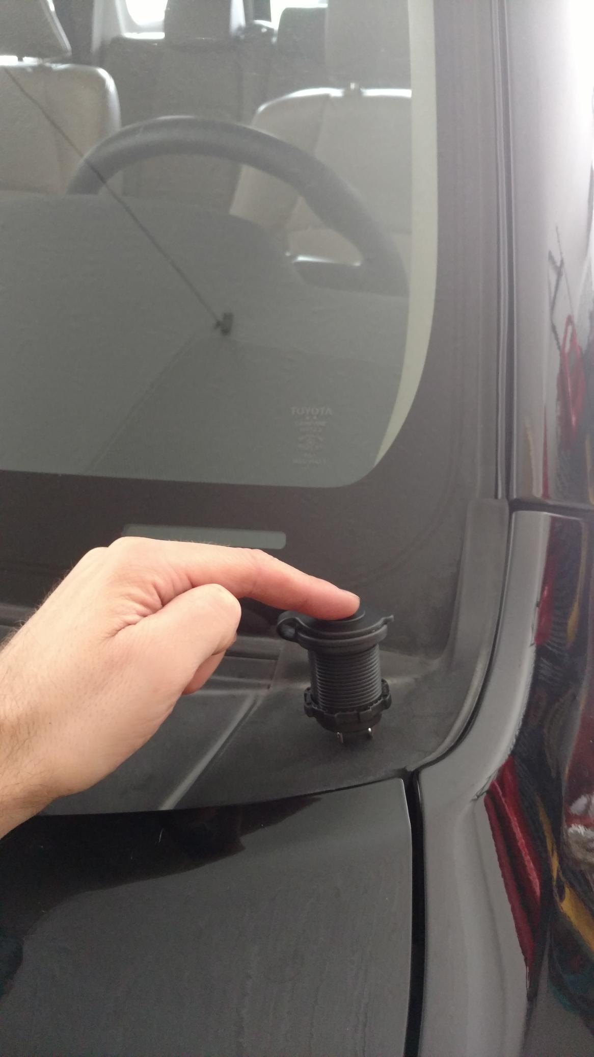

Looking to add an exterior 12v outlet. This would be used to run the awning lights, charge phones while at camp, etc.
Originally I was thinking of putting it in the shroud over the radiator, but that A) means I have to pop the hood, B) the cord for the awning lights doesn't reach that far.
So I'm thinking about the trim piece at the corner of the windshield (see picture). It can be easily replaced if I change my mind. The 12v outlet I have is a marine grade outlet, so it should be fine for rain and snow.
Anyone any experience with this location? Thoughts? Concerns?

should be fine, i've used them on motorcycles for years. Usually don't mount them vertically though, so as long as it isn't collecting moisture and it's properly fused in case something does go wrong, try it out.
^^^^^^^^^ what he said
I would either go vertical or somewhere with slight downward incline to avoid crap collecting into the socket itself

Agree with [MENTION=146469](none)[/MENTION] I'd mount it horizontally vs vertically if at all possible.
Or, in the engine compartment, toward the firewall. I'd rather have it out of the weather, and secure ... opening the hood is no big deal. That way you don't have to drill a hole, you could fabricate a bracket.
I'd mount it vertically too if I could; and using a gasket to prevent water from traveling down the threads. A gasket would also seal any small differences between surfaces. An outlet with a screw on cap would be better.
Also, I would install a switch so the outlet isn't always hot. Heat shrink around the contacts after the connection is made will help too. While shrinking push up to keep the heat shrink flush against the body of the outlet. It will shrink away and leave a gap if you don't.

I'm okay with it being always hot, although IF I go to route of a bracket under the hood, then I might as well add a switch.
Security I considered, but how many people are checking vehicles for 12v outlets and charging their phones from it on the street?
That location is on a slight incline, so water should run off.
Yes, I know popping the hood isn't that big of a deal, but I hate the in-out-in-out of the vehicle when camping. Just means driving with more bugs in it the following day....
