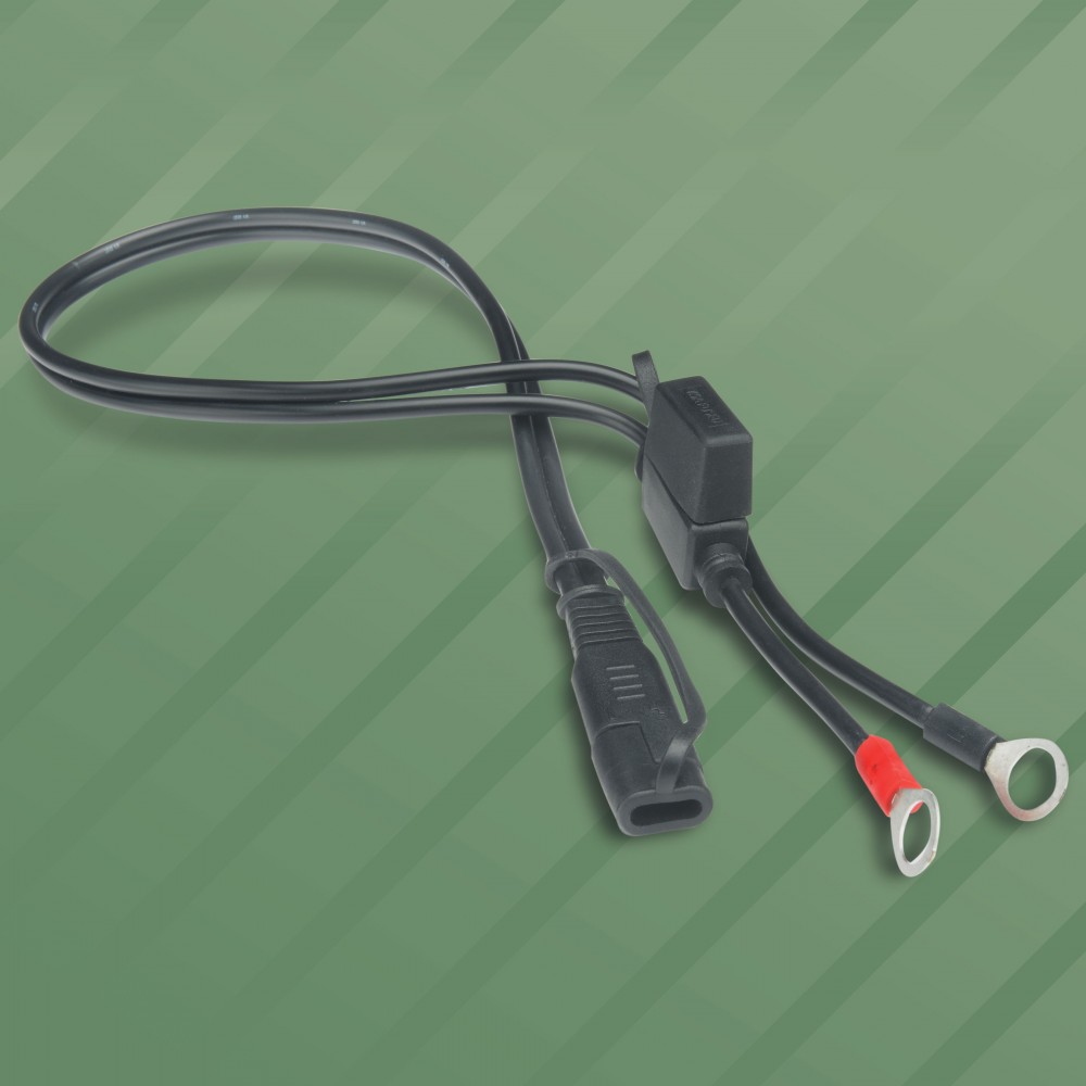

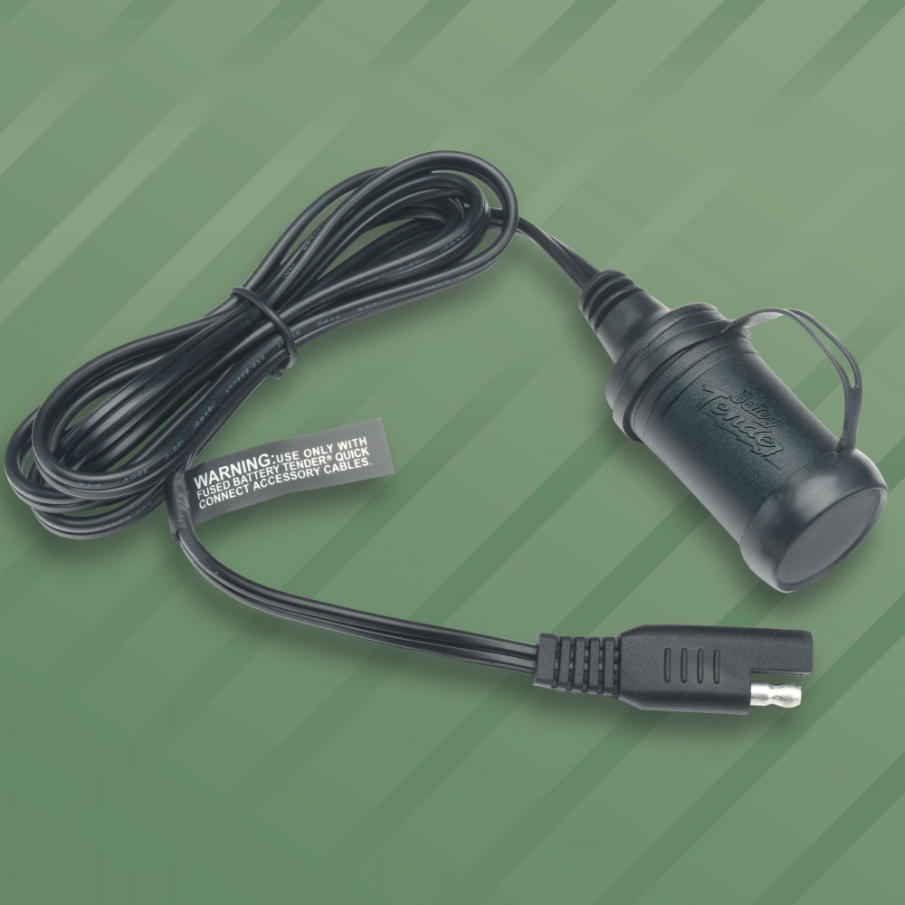

Or you could use something like these from a company such as Battery Tender, will handle up to 7.5 amp load. Just a thought............
Deltran Battery Tender Accessories
