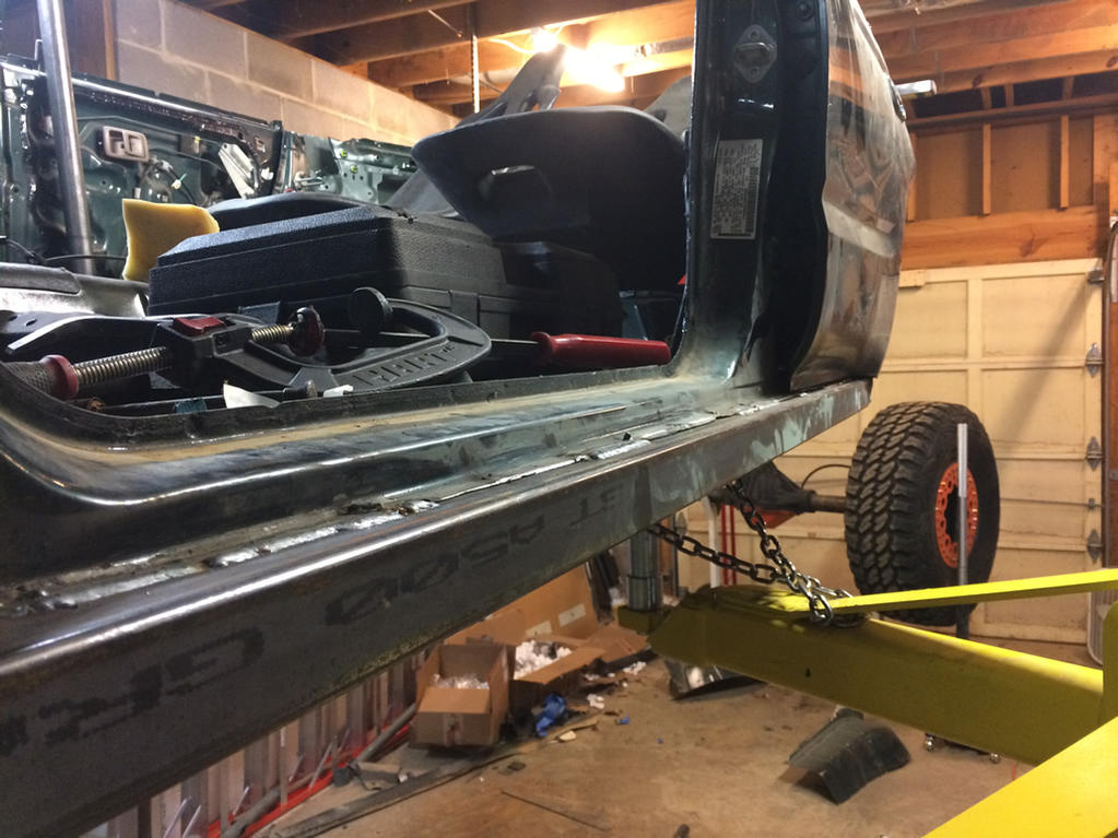

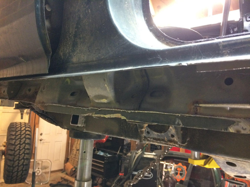

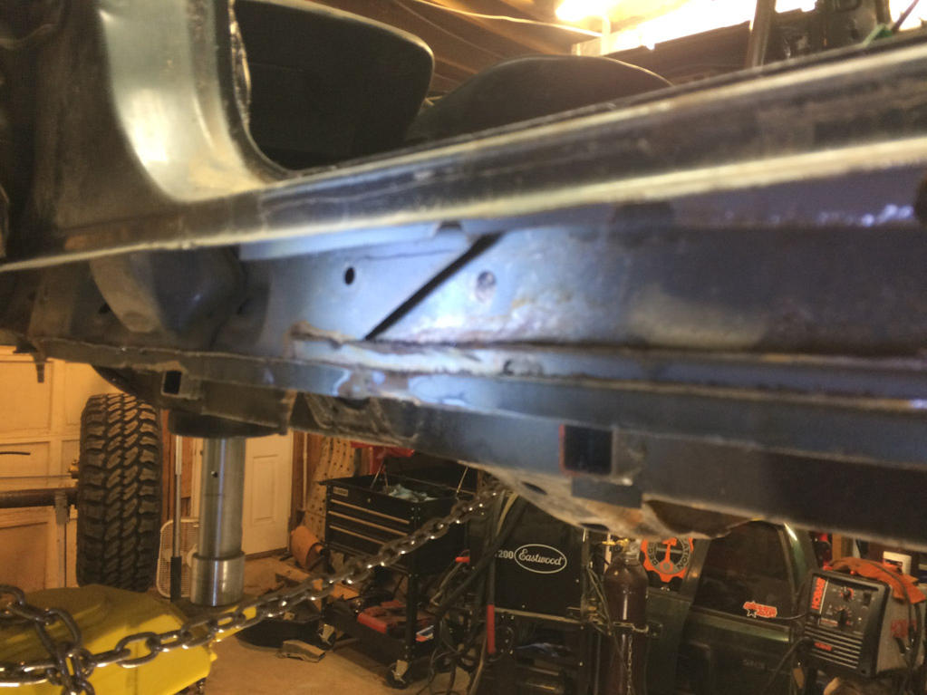

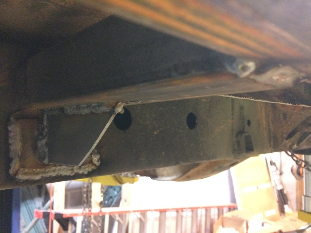

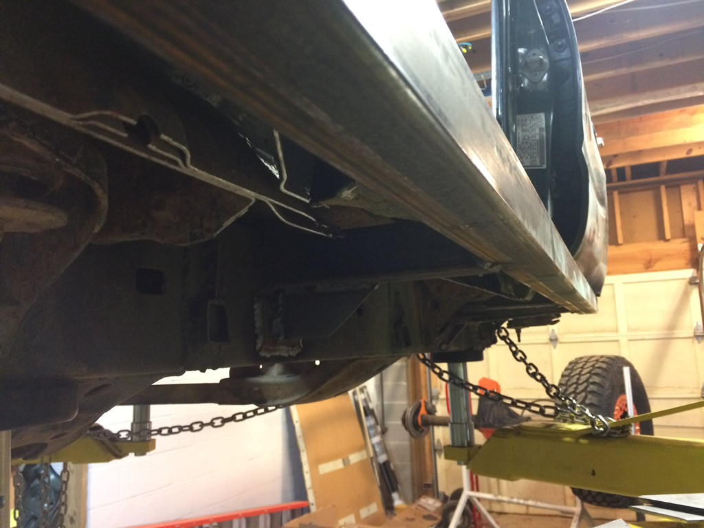

Here's the start of the boat sides. I'm not going too deep up into the doors. Just from the bottom of the frame up to the bottom of the body sill.
I started by cutting out the rocker panels. They were rusting from the inside out anyway, so no real loss. Then added 2" structural steel square tubing by rosette welding the tube to the left over 18 gauge steel body.
Then I welded in square out-riggers from the frame to the rock slider (9" each) and gusseted them. Doubling up where the roll cage mounts to the frame. Next, I will add plate from the frame to the 2" tube (after POR15 is sprayed on the inside) to make shallow boat-sides. These will be rock sliders extreme style.
I'll finish up the plate later.

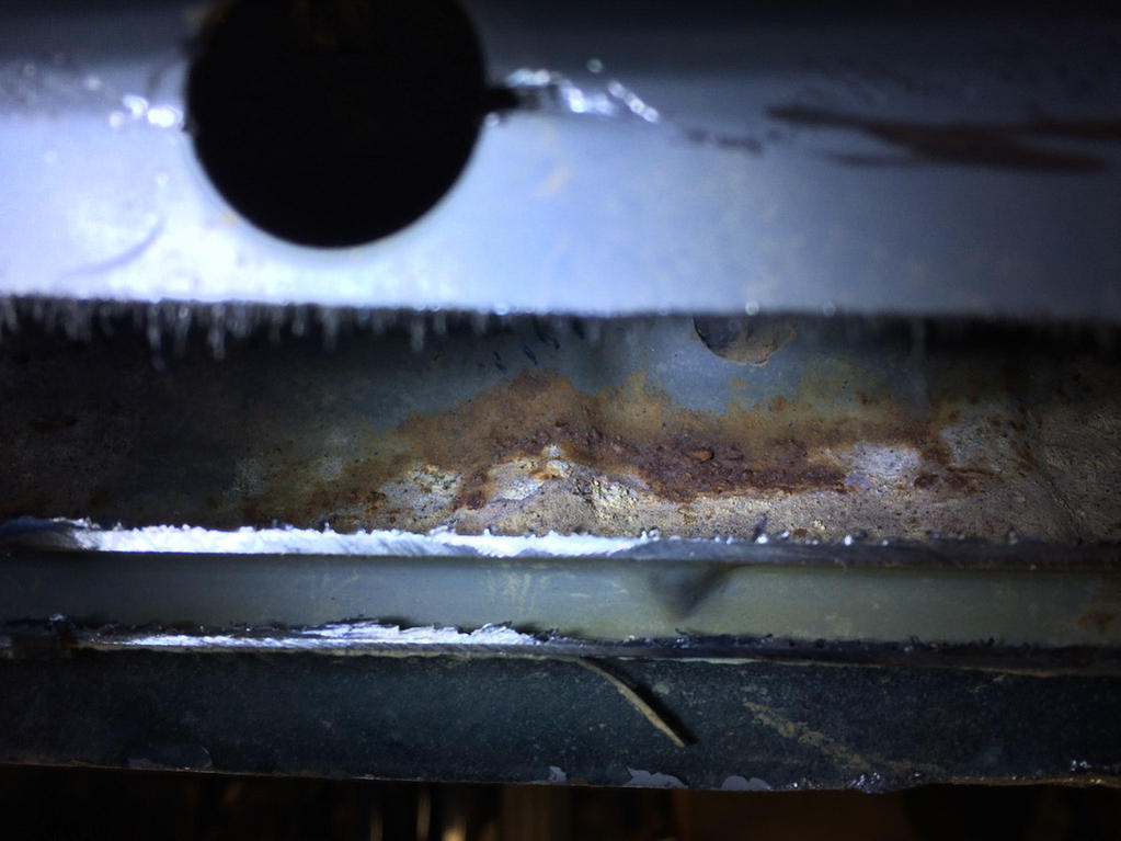

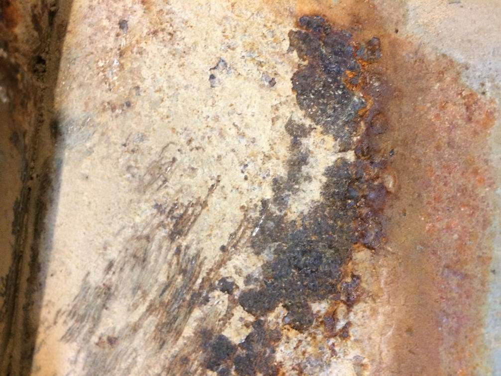

Any pics of the rocker panels when you cut them out ? I hate that basically that's how every rocker panel rust. Inside out. And it's such a shitty spot to fix

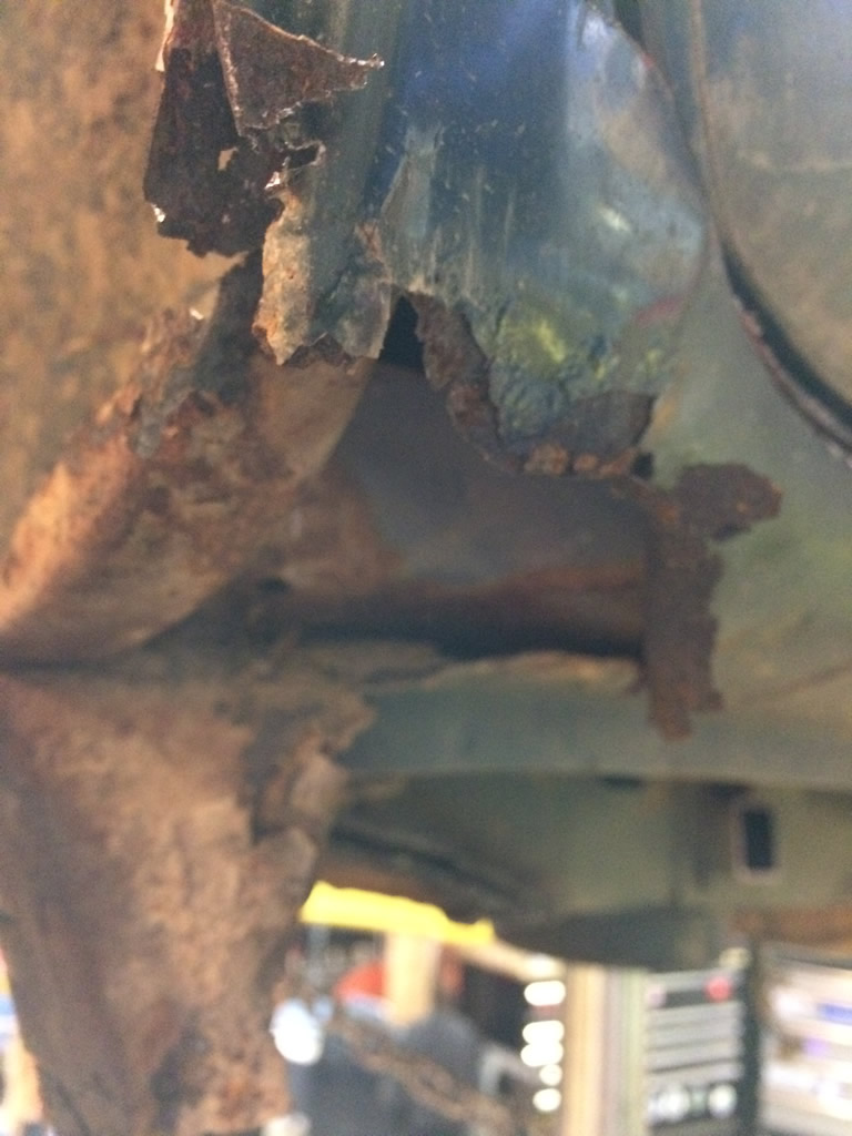

Yeah, this vehicle came from up your way. Just next door in PA to be exact. All the salty winters over the years wreak havoc with steel parts. This was the worst of it. That looked normal from the outside, just a slight bubble under the paint. push through it with a screwdriver and it just folded in. I peeled this back with my hands (gloved of course). The rest of the rockers after cutting them off (I'll get a pic of that when I get home) was just coated in rust all the way down on both sides. So, nice new rock rails! :whoo:

Was there any rust spreading to the floor area from the rocker panels? And what did you do to kill the rust. Obviously remove the rocker panel but what about the area that's attached to the body.
Thankfully the body pans are solid, however, there is some surface rust. I will be prepping and painting the whole underside with POR-15. Any surface remaining really will get the POR-15 treatment even the insides of the cab floor once I'm finished with center console and xfer case install. Then paint perhaps. It's a trail truck mostly, so I'm not concerned with the cosmetic look to the floorboards.

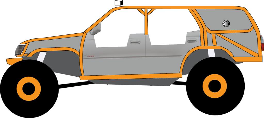

Here's a quick sketch of the overall design. I want it to still have the iconic 4Runner rear quarter window shape, so everyone knows it's not a Jeep XJ. :biggrin2:.
The dark gray under the rig is the skids / boatsides.

Not sure yet how I'm going to counter-sink or cover the bolts to protect them from the rocks.
A lot of Jeep guys will build steel skids, and then cover them with HDPE sheeting. You can countersink in the HDPE very easily, and it'll help from destroying your skids as fast.
Another option is to use bolt protectors. This is basically a cone washer with a bored area to protect the head of the bolt.
That's actually a great idea, thanks! HDPE is slicker than snot too when wet and doesn't really add much weight.

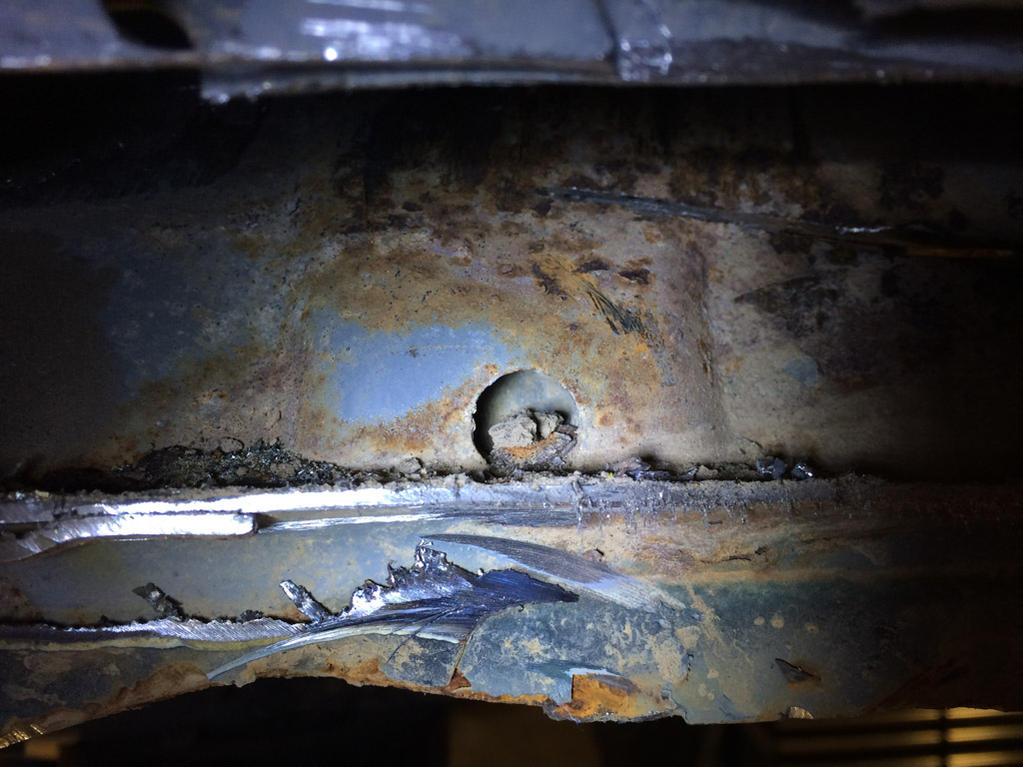

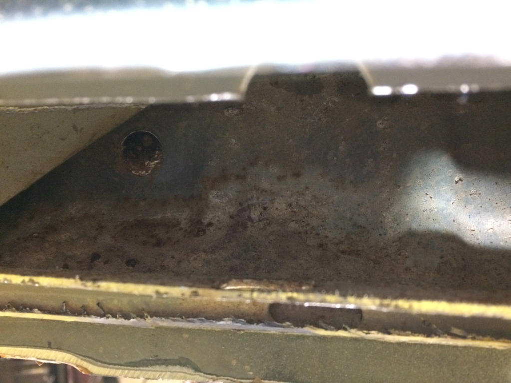

anymore pics of rocker pannels

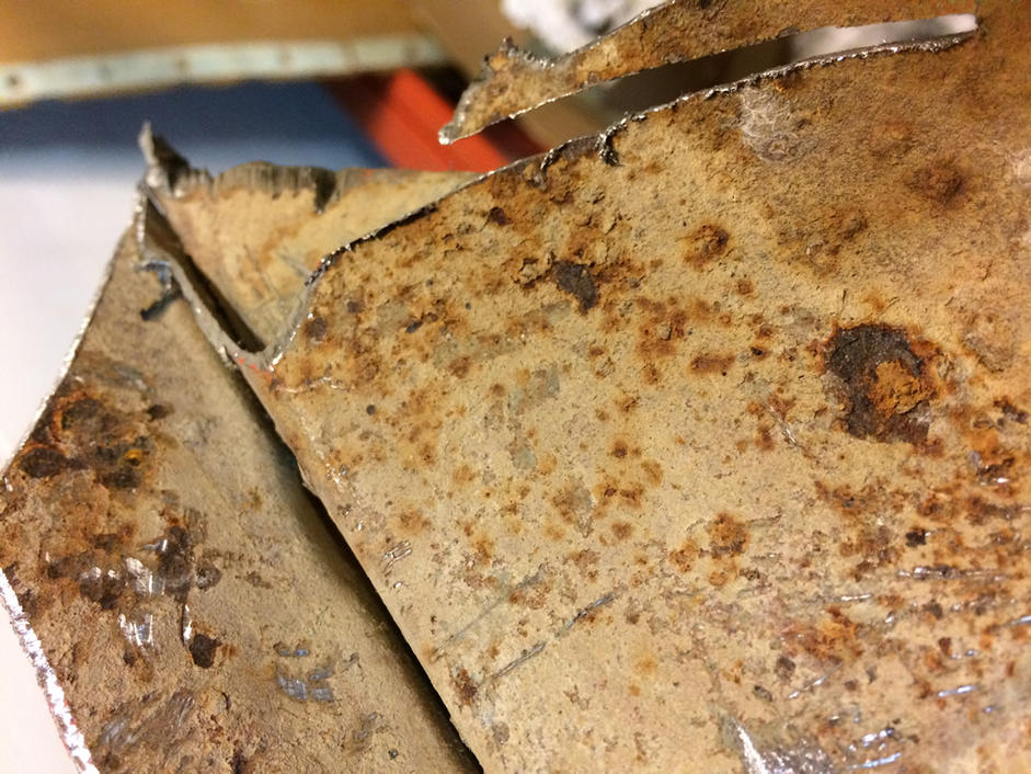

Just these. All the rockers looked the same. The left side wasn't as bad as the right side. The left side had rust behind them, but not all the way through yet. This is a view from the inside of the rocker. Flip this over and it's the painted side.

thank you, interesting to see inside!
very annoying that these rust from inside out, and its not that easy to fix !! i know deep inside me that eventually mine will rust the heck out because i already patched some lol

Yup, it sucks. Just do what I did and cut them out. Weld up some sliders close up and you're good to go. lol :first:
