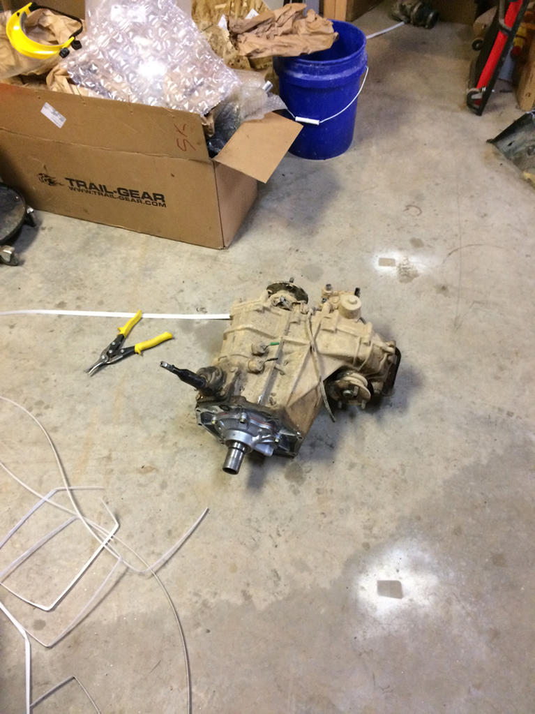

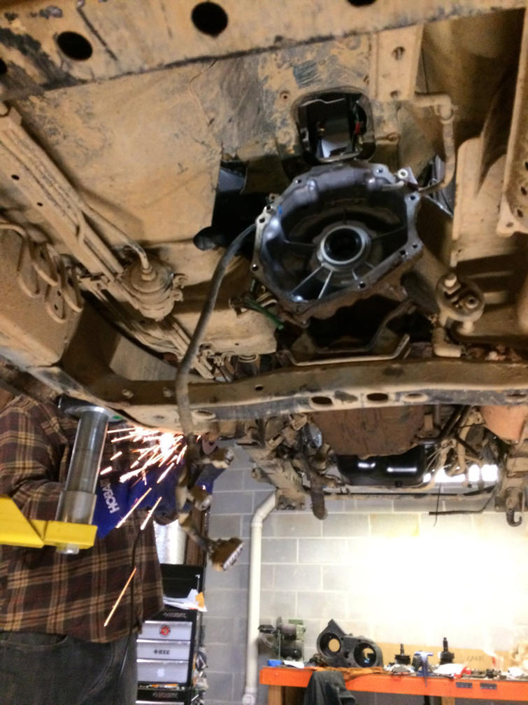

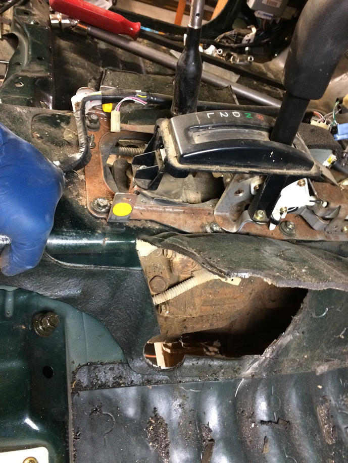

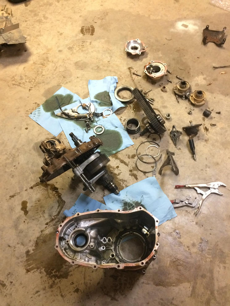

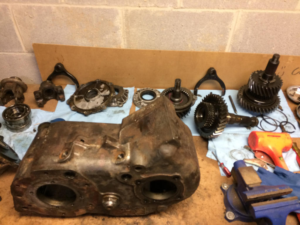

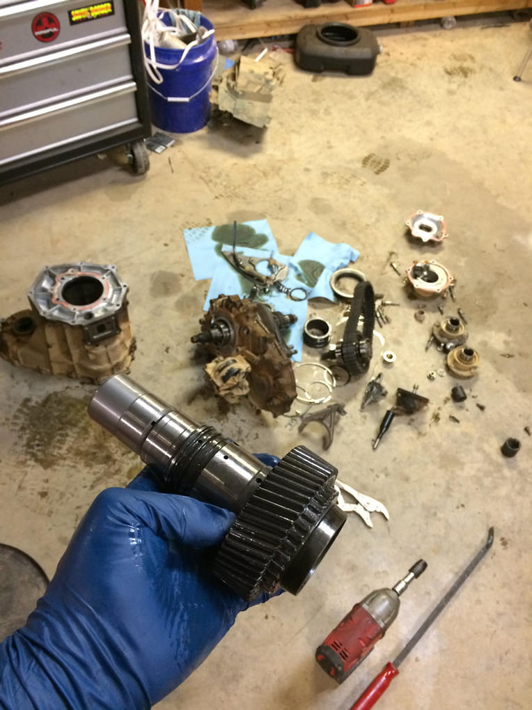

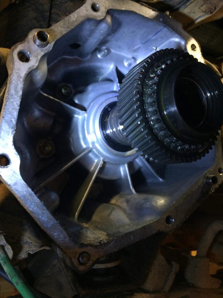

My buddy came over and helped me today and he brought beer too! Managed to get a lot of cutting and grinding done. Tedious work but required, unfortunately. Got the stock transfer case out too. It was a bear due to the rusty bolts, which has been the largest hold up on progress thus far. I cut through the tunnel to get to the very tight top bolts. All that is going to get re-fabbed anyway to make room for the NP203-205 setup. Got it out and torn down to salvage the input shaft for the tranny. Now I'm ready to start mocking up the new drivetrain once I get the NP205 put back together.

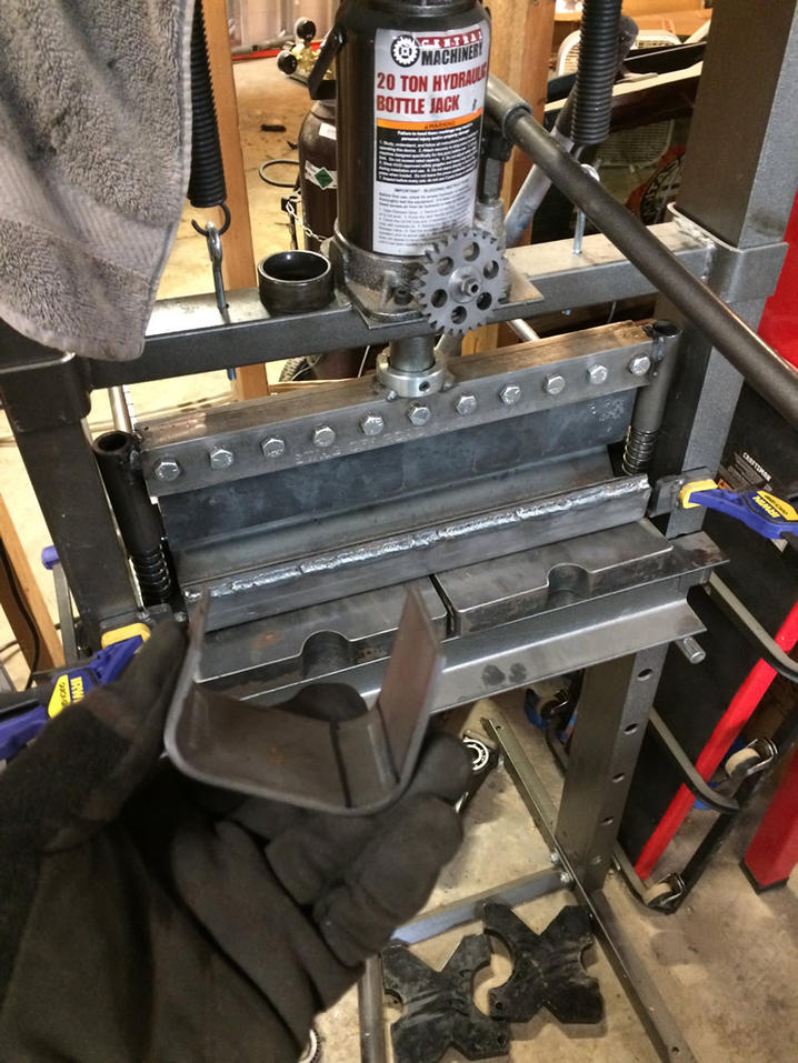

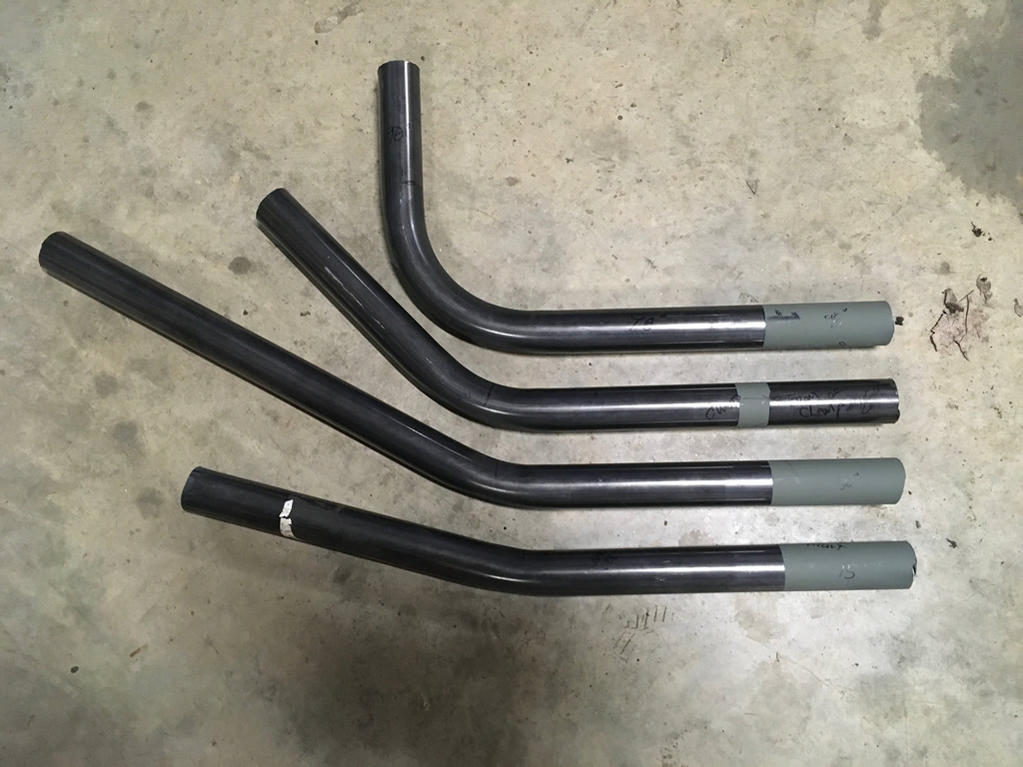

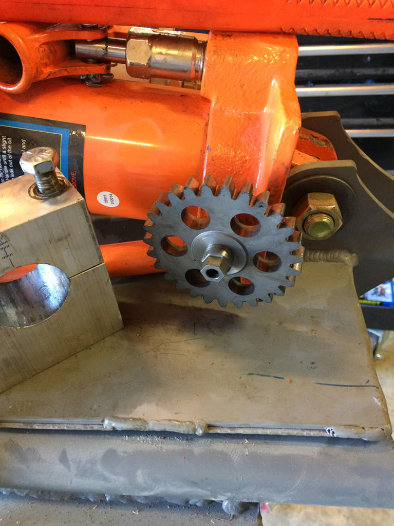

More body mods today as I wait for the last few remaining parts I need. I spent the morning shopping for steel and various other items I need. Then while I was waiting between coats of paint on the transfer case parts I bent some guide tubes at 15, 30, 45, and 90-degree angles.
It's one hell of an accurate bender if set up properly.

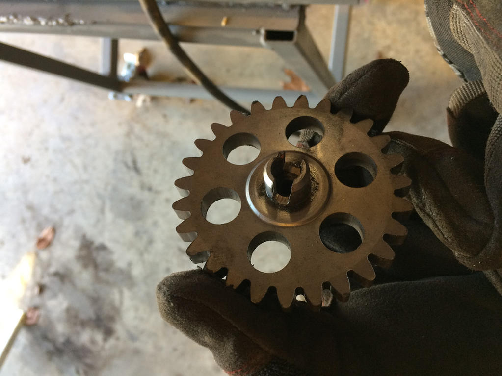

Then I made a part for my bender out of one of the gears I took out of the 4Runner transfer case. Coolest part I think I've ever built.! :first:

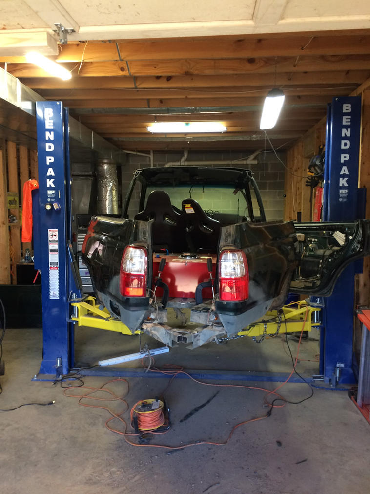

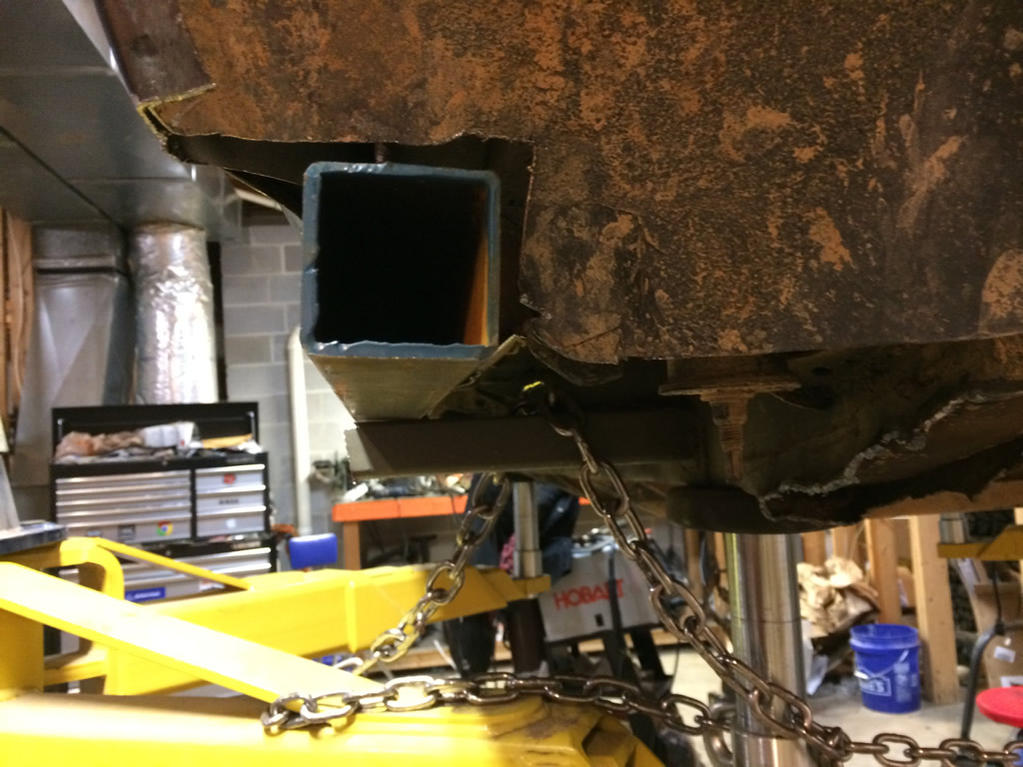

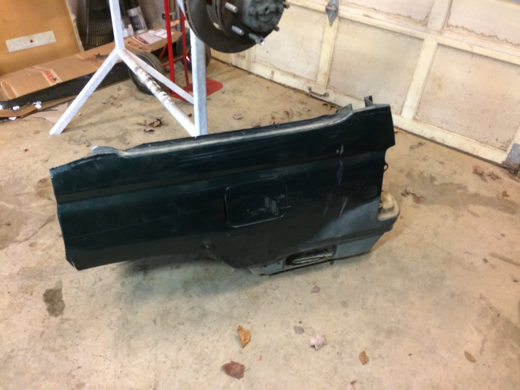

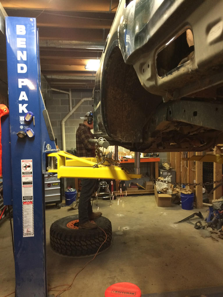

Chopped the rear quarters off in two separate pieces (left and right) so I could narrow and bob the frame easier. I also cut just behind the C-pillars so the rear doors would still function. I'll finish that up tomorrow. It's really starting to scare my wife, who doesn't have the ability to visualize something in her head like I can, so she's afraid it can't be put back together to form anything resembling a 4Runner. I look at it like Michelangelo, I'm just chipping away anything that doesn't look like my future very unique 3rd gen 4Runner. :lol:

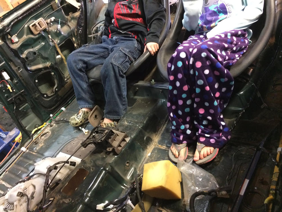

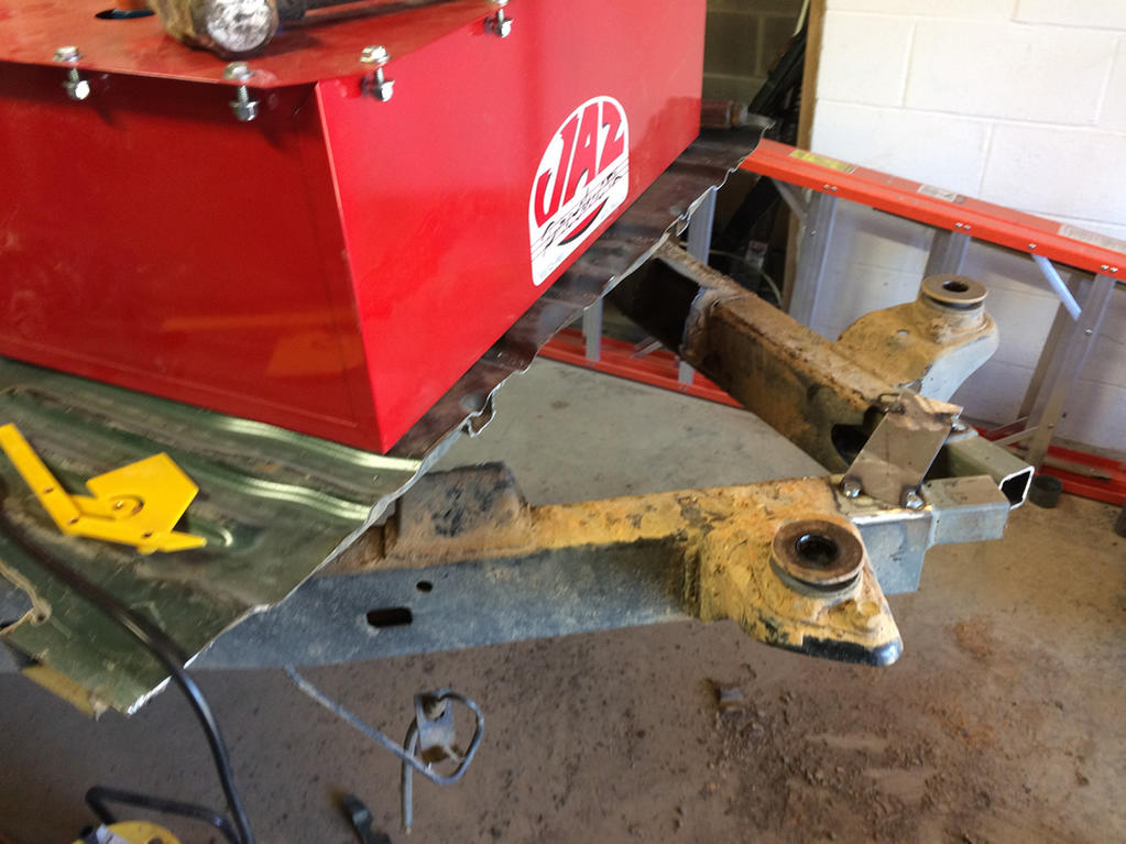

More body mods today. Spent some time cutting and tacking in the rear quarters. My little helpers came down to the shop to help me measure the rear seat placement too. And since I'm a member of Jeep's & Wrenches Offroad Club having a Jeep Recovery Unit is a good thing, right?

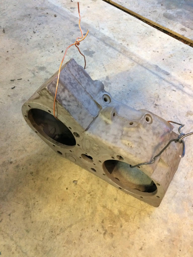

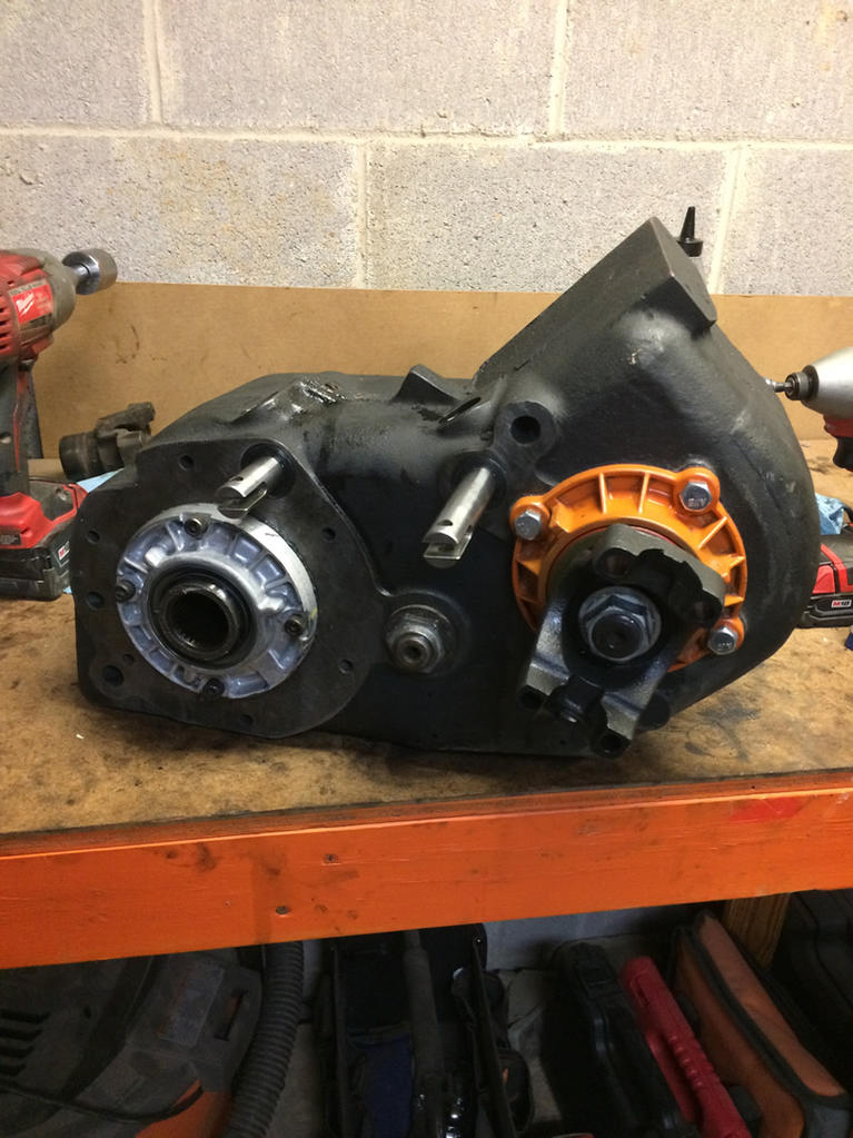

NP205 All cleaned up and ready to mate to the underdrive.

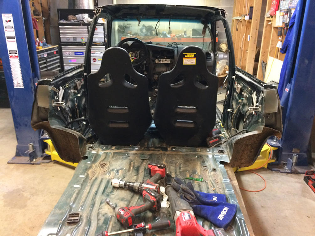

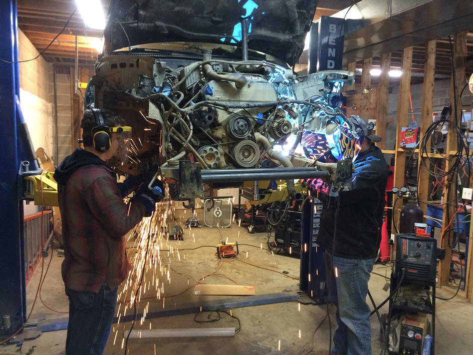

More progress this weekend. I mentioned I had lots of BEER in the shop, and amazingly two of my friends showed up to help work on this beast. AWESOME!
My little helper came downstairs to visit the fun for a while too.

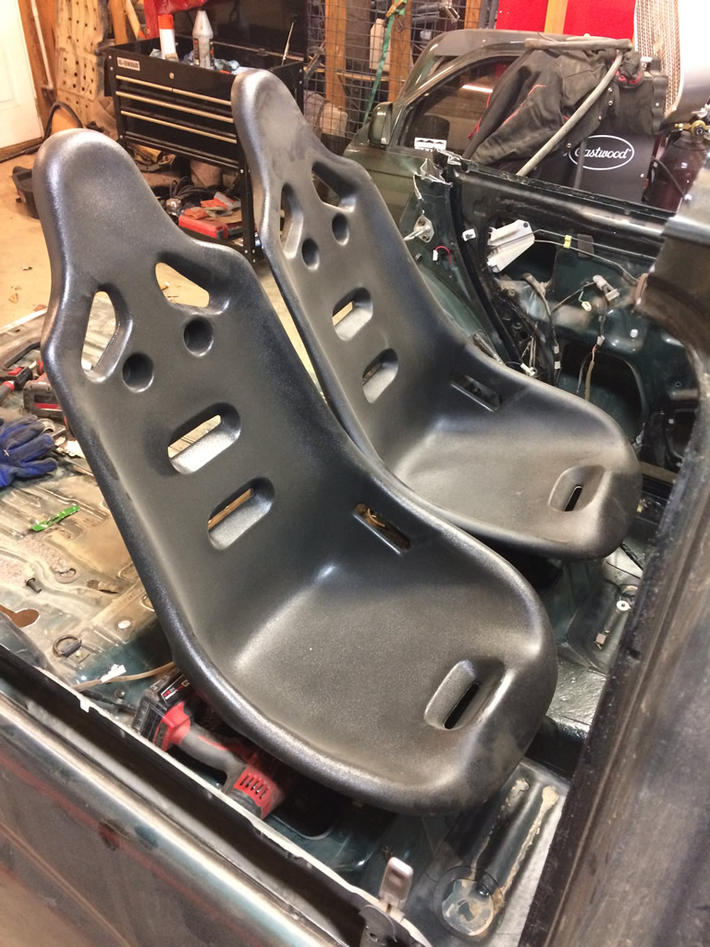

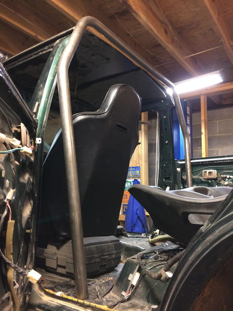

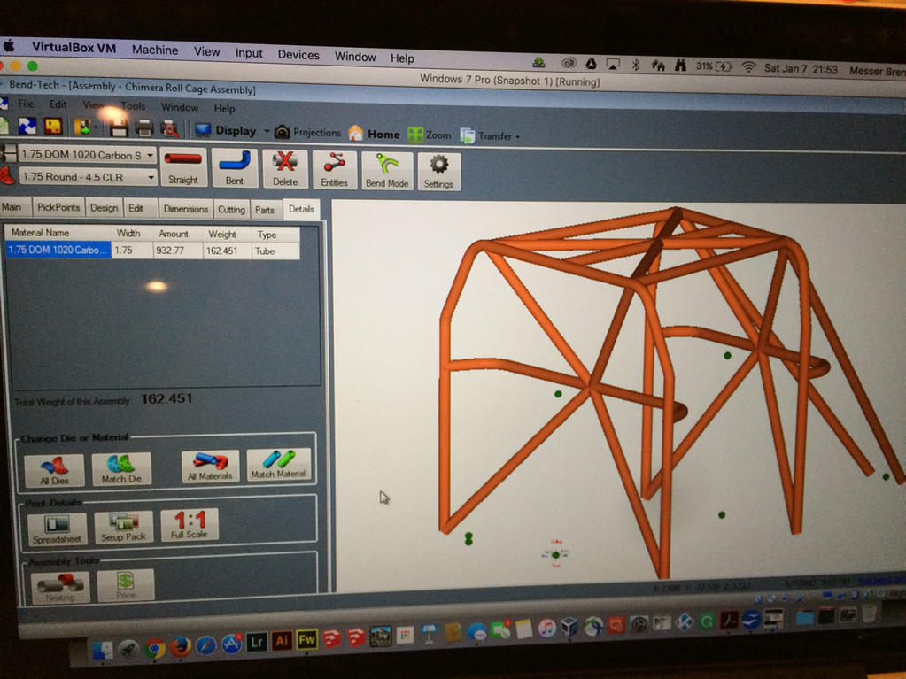

Got the roll cage designed. This is all internal here. This is built for strength and safety not looks. The cosmetic tube comes later.
Got started on the boat sides / rock sliders and the frame stiffeners too.

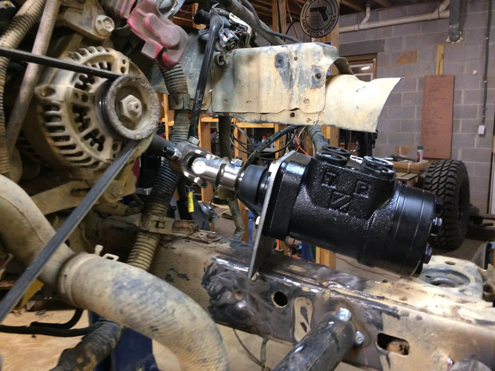

Oh yeah, Got the steering shaft installed and tacked in the orbital for the full hydro setup.

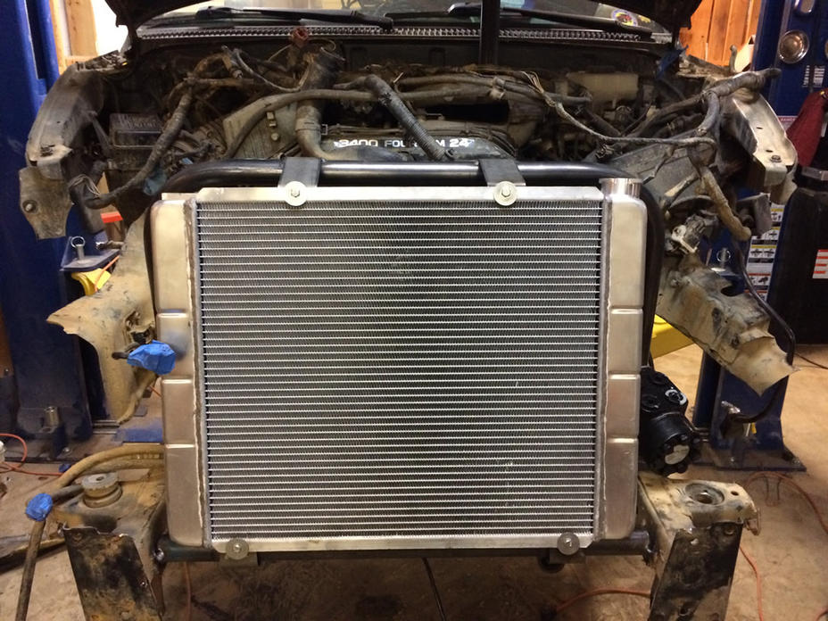

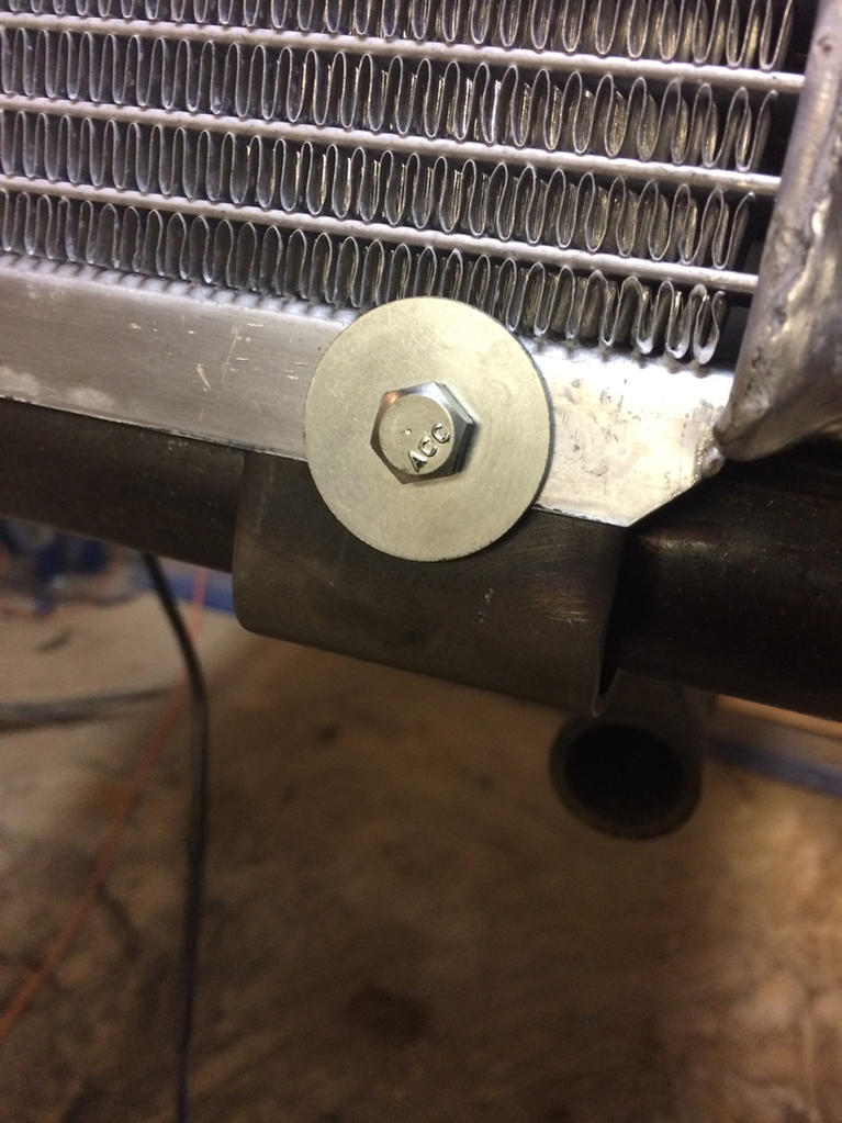

Custom radiator mounts fabbed up and installed.
The radiator is a dual core universal aluminum radiator from Summit (Part number SUM-380425) complete with an aluminum shroud and new 16" electric fan to help keep things cool at idle and low speeds on the trail. The stock engine-driven fan just didn't have enough oomph to draw air through the radiator, condenser, and trans cooler.
The tube mount behind the radiator has tube couplers at the base to allow the radiator to be removed. You know, for that eventual LS swap. :biggrin2:

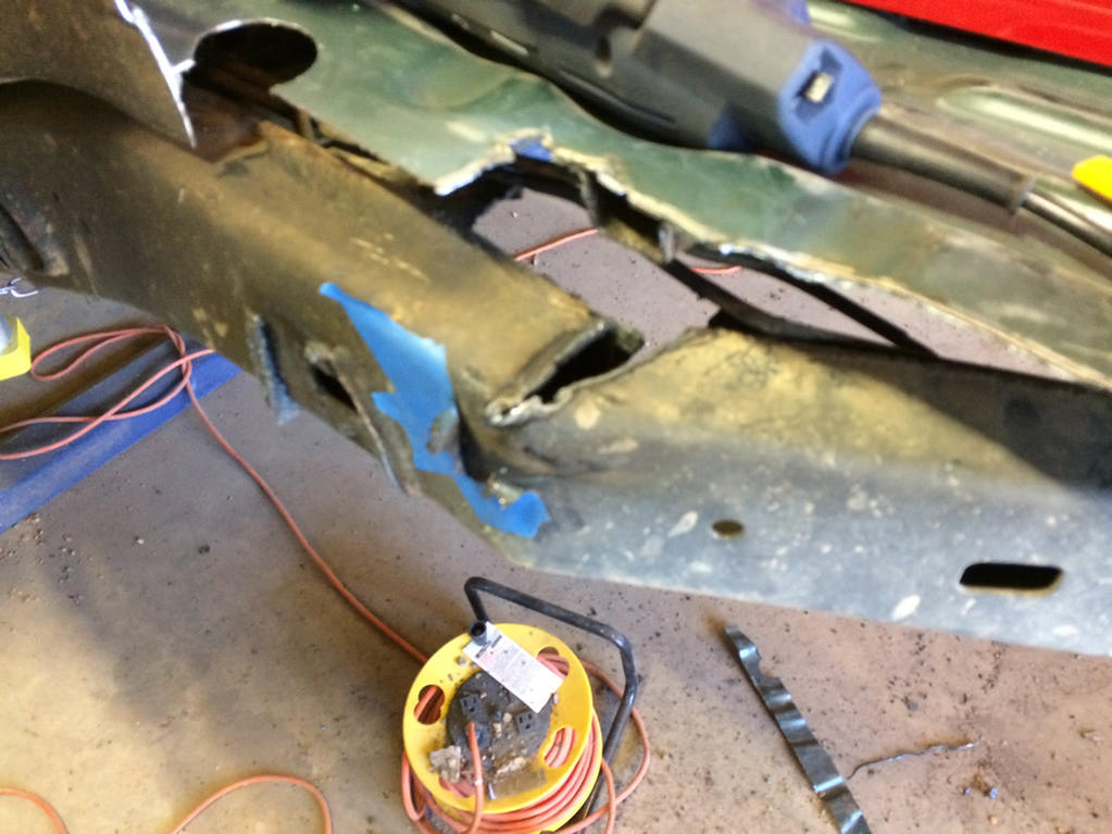

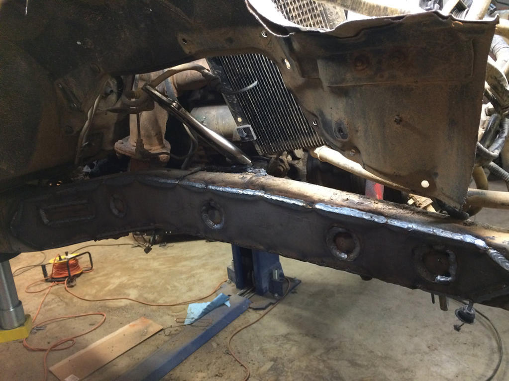

Do you have more pics of the boat sides you put in? Also when you welded in your frame stiffeners did you make a box over the existing frame or did you just cut and weld plate to the sides of the frame?
The frame on these Toyotas are already boxed in. It's just 3/16" plate welded to the outside of the frame. That's all you need for leafs and you don't really even need that for Linked suspension because links won't stress that part of the frame. But, I already had the frame stiffening plates, so I went ahead and put them in just for the sake of it.
I didn't word my question right. When I patched an 18" long section of my frame the only feasible way for me to make sure it was safe was to actually build a box that slid over the top of the frame and then I welded the 4th side of the box along the bottom of the frame. I was just wondering if you did that which sounds like you didn't.
