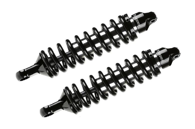

I just impulse purchased a set of these:
https://www.carid.com/fabtech/dirt-...-steel-front-coilover-shock-mpn-fts26057.html
This sounds crazy, but I mistakenly thought they were rebranded ICON coil overs? After taking a closer look at the specs they seem to be totally different construction from the ICONs. Confused with all the different manufacturers of Fabtech coil overs, fox, saw, etc...
I am wondering if anyone has experience with these new Fabtech Coilovers, or knows who makes them?
I know that Fabtech does not have the best reputation, hoping these new coilovers are better than their old stuff?
They should be arriving in a few days, I have my fingers crossed.

I believe Sway Away manufacture the dirt logic series shocks for Fabtec.

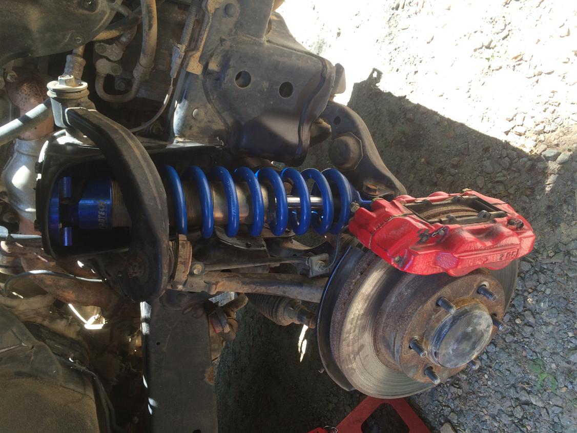

Theses are fabtech Dirtlogic coilovers, old from what i can tell. Got them off a Tacoma... Ride pretty damn good to me. On road they feel like friends icons and kings. Offroad they're not quite the same but I don't have resi's like my buddy's do lol...

Well, I just got off the phone with Fabtech and they couldnt even give me the spring rates :loco: they said, call back on monday when our shock department is in.
What they were able to tell me is that they are made in house and the springs are made by eibach.
These are the specs from Fabtechs site:
• 2.50" OD Stainless Steel body
• 2.25" OD Billet Aluminum Piston
• 7/8" NitroSteel® Black Piston Rod
• Adjustable Coilover Construction
• 5/8" Spherical Ball Mounting Ends
